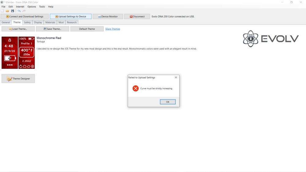

Smokin Dave Posted September 27, 2020 Report Posted September 27, 2020 When trying to install a new them an error pops up stating CURVE MUST BE STRICTLY INCREASING. What is this all about?
Wayneo Posted September 27, 2020 Report Posted September 27, 2020 I have NEVER seen that from just applying a theme. (.ecigtheme) file extension You could be fine with a 'disconnect', then a 'connect and download settings', then apply the theme

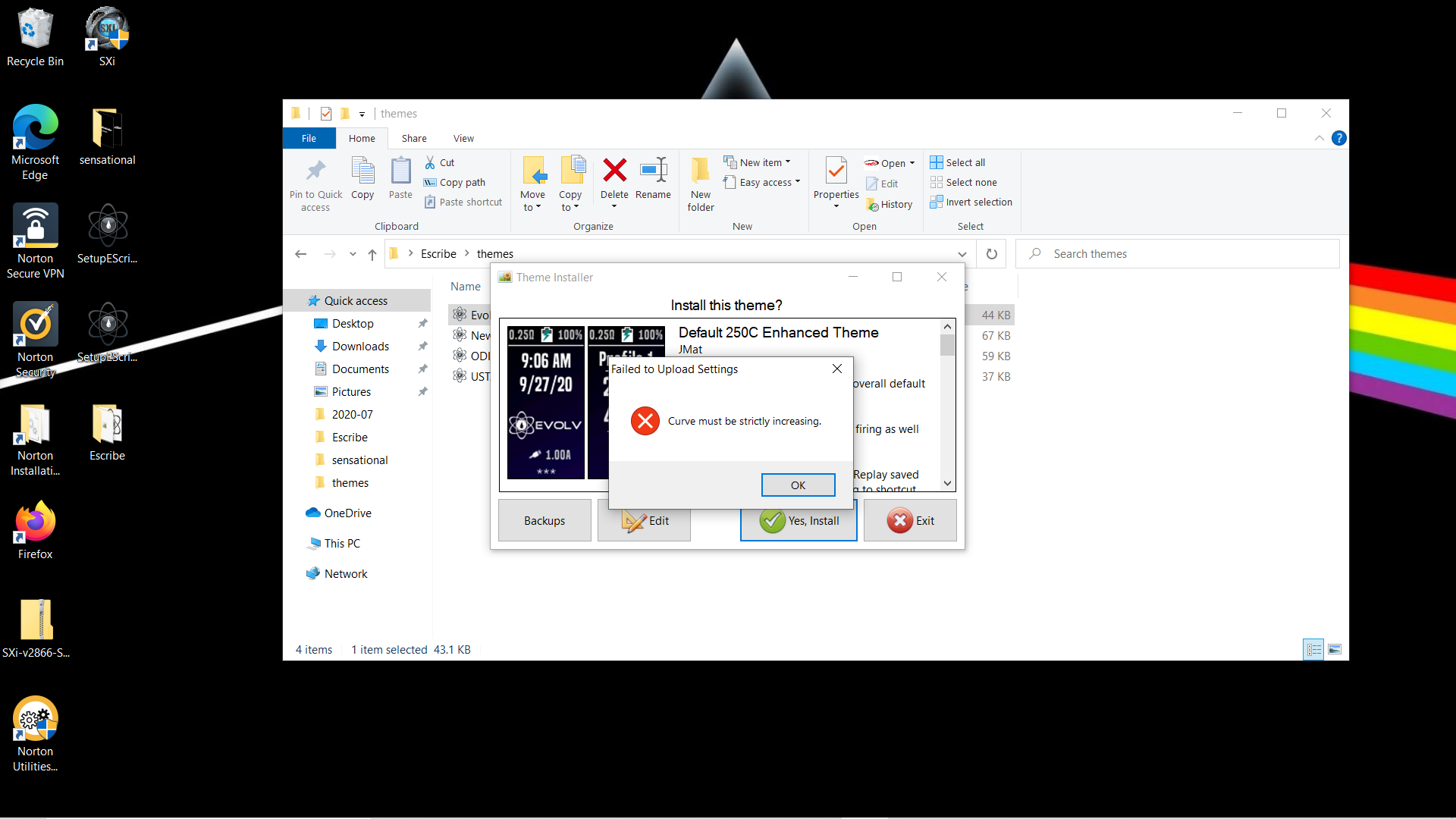

Smokin Dave Posted September 27, 2020 Author Report Posted September 27, 2020 Beats the hell out of me. I’ve tried everything from restarting my pc to stop/restart evolve and now I give up. Even trying to install from the evolve suite does no good. Keep getting the same error.
Smokin Dave Posted September 27, 2020 Author Report Posted September 27, 2020 See? Won't even load with escribe.
Wayneo Posted September 27, 2020 Report Posted September 27, 2020 under the Help menu item, the bottom option is backups. You can restore to a time before this was happening.
