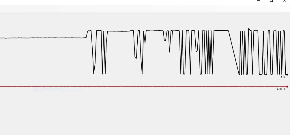

So I hooked up my DNA75 VA Spade to Escribe and started loosening the battery cap, here is the result in Device Monitor.
This is what a bad connection between board and battery looks like. In this case the bad connection was between the battery and battery cap. But there are other places that could be problematic. Very possibly the 3 screws that hold the board to the case provide the ground for both the board and 510. Or a bad solder joint on the positive lead or contact.

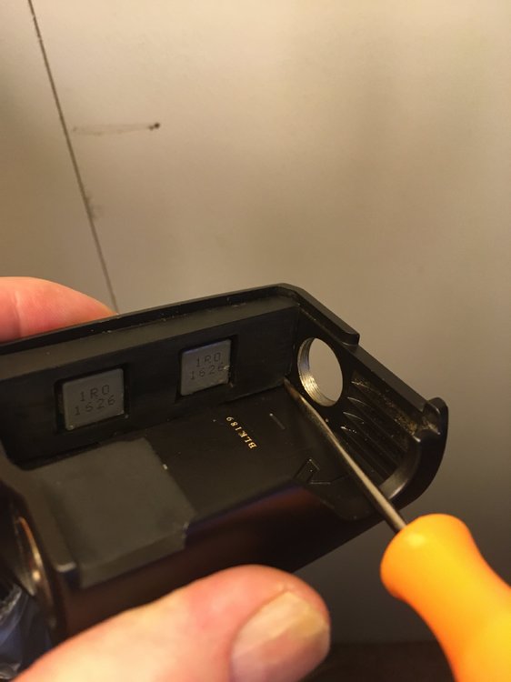

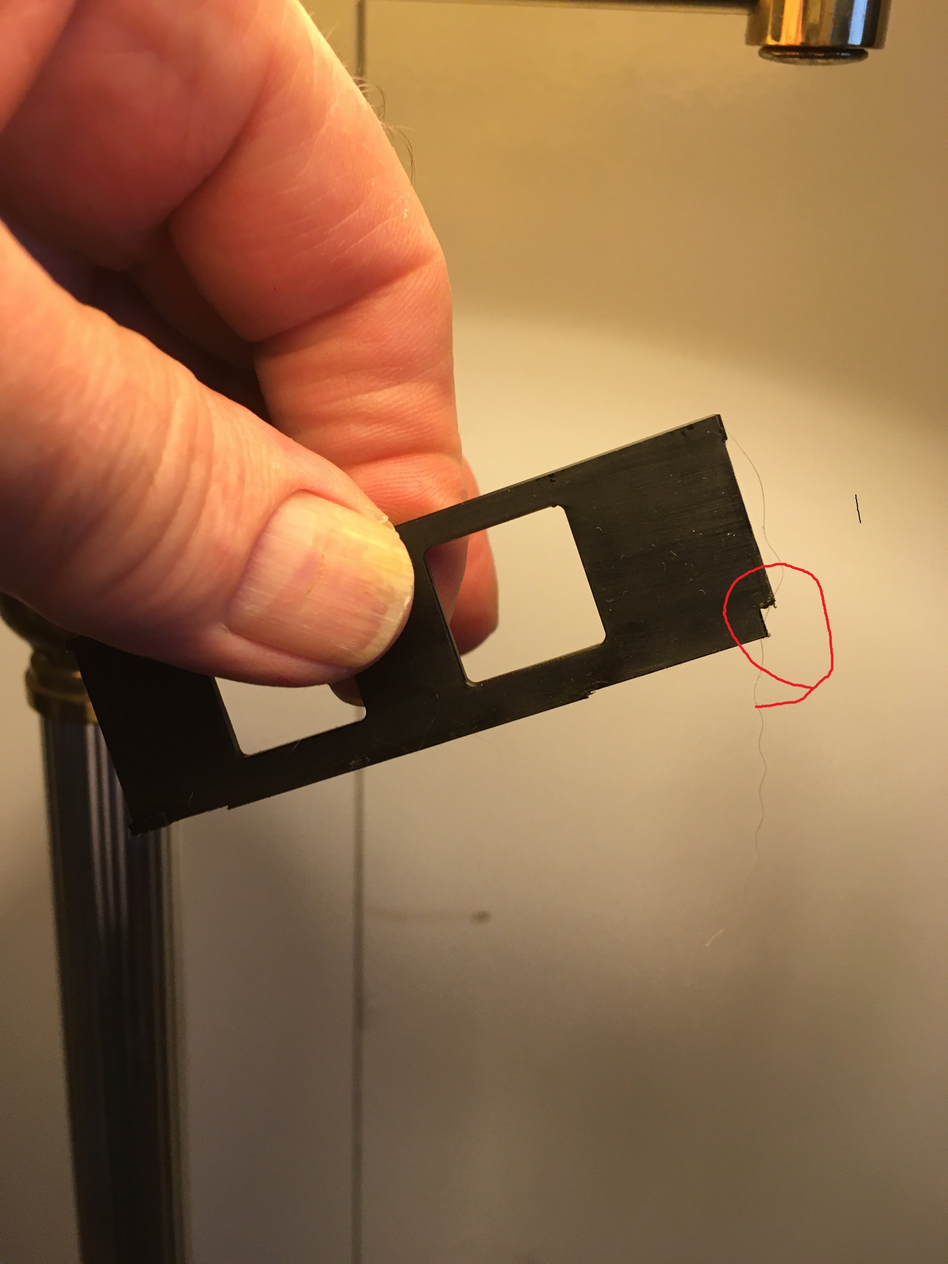

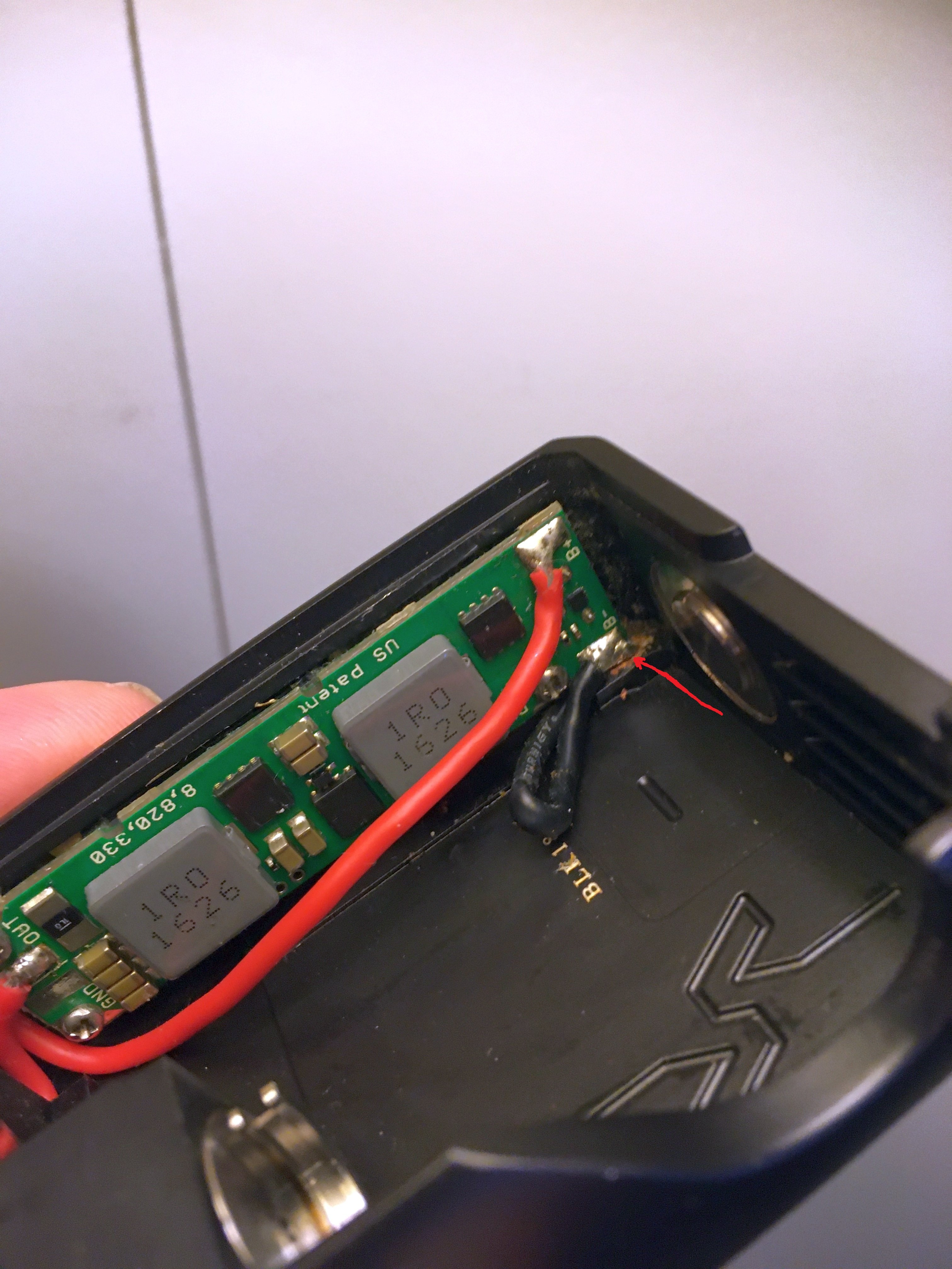

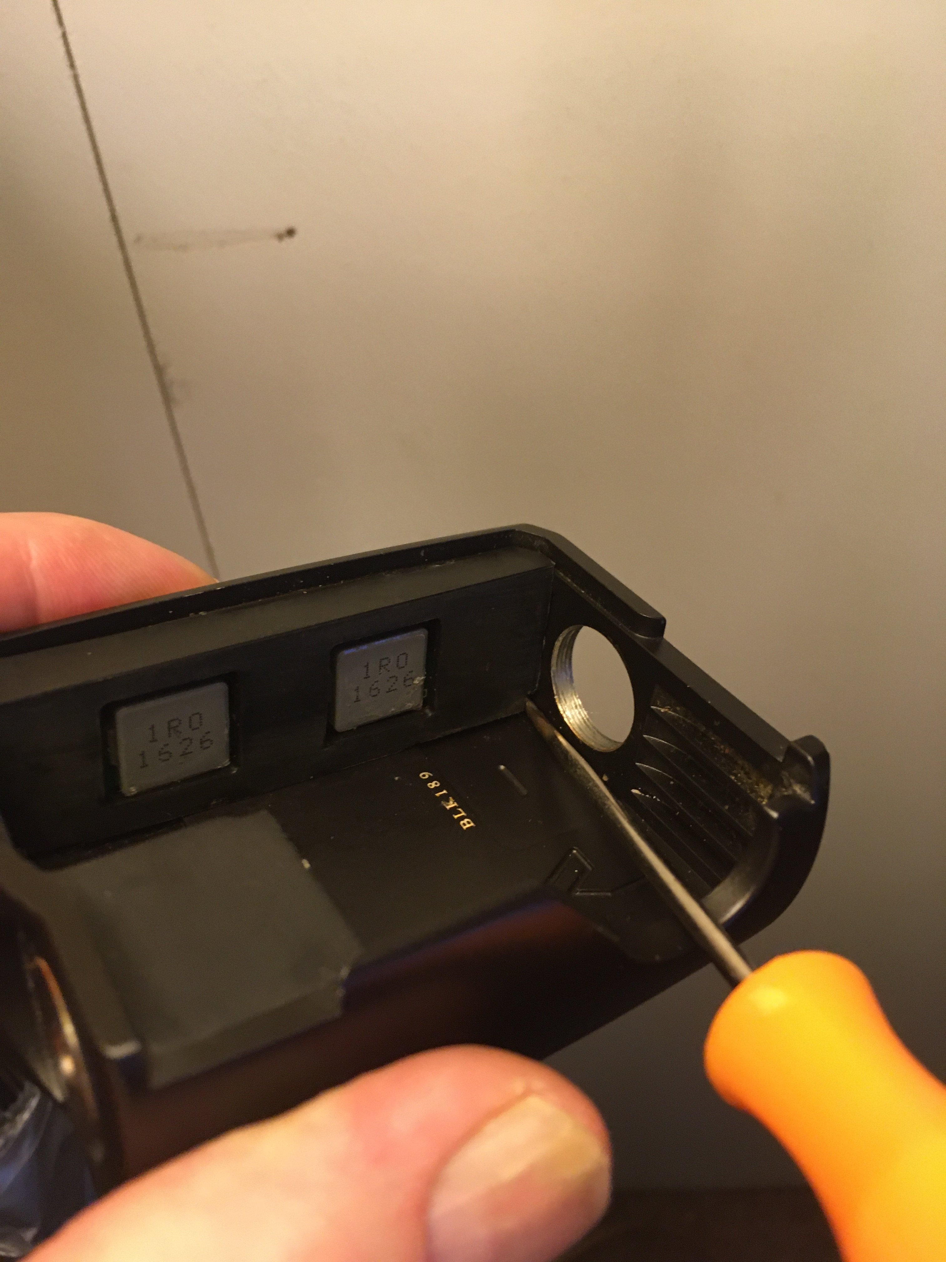

I have always wanted to see how VA wired it. I tried to remove the cover over the board but gave up. The cover is just press fitted in the case. I fashioned a tool from an o-ring pick and got the hooked end inside the little opening and pulled, the cover came right out.
Note the black wire, it goes from B- to a spot on the case right under the board. How they attached it I'm not sure, that's copper to aluminum so maybe they glued it.(?)
The 3 screws holding the board into the case are able to provide the necessary ground for both the board and 510 socket.
All 3 screws on mine were a little on the loose side.
I would guess that your problem is with the ground and not the positive.

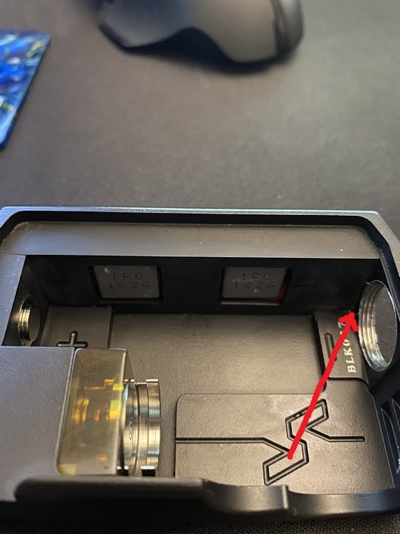

Well then the only thing I can say is that end of the cover needs to come out first. The cover is not glued, well at least not on mine, it is just pressed in tightly.
I was able to get my finger nail into the center and ran the edge of a credit card down to the bottom but the card wasn't strong enough to pry it out.
Care must be taken  to not hit the components on the board as they could get knocked off.
