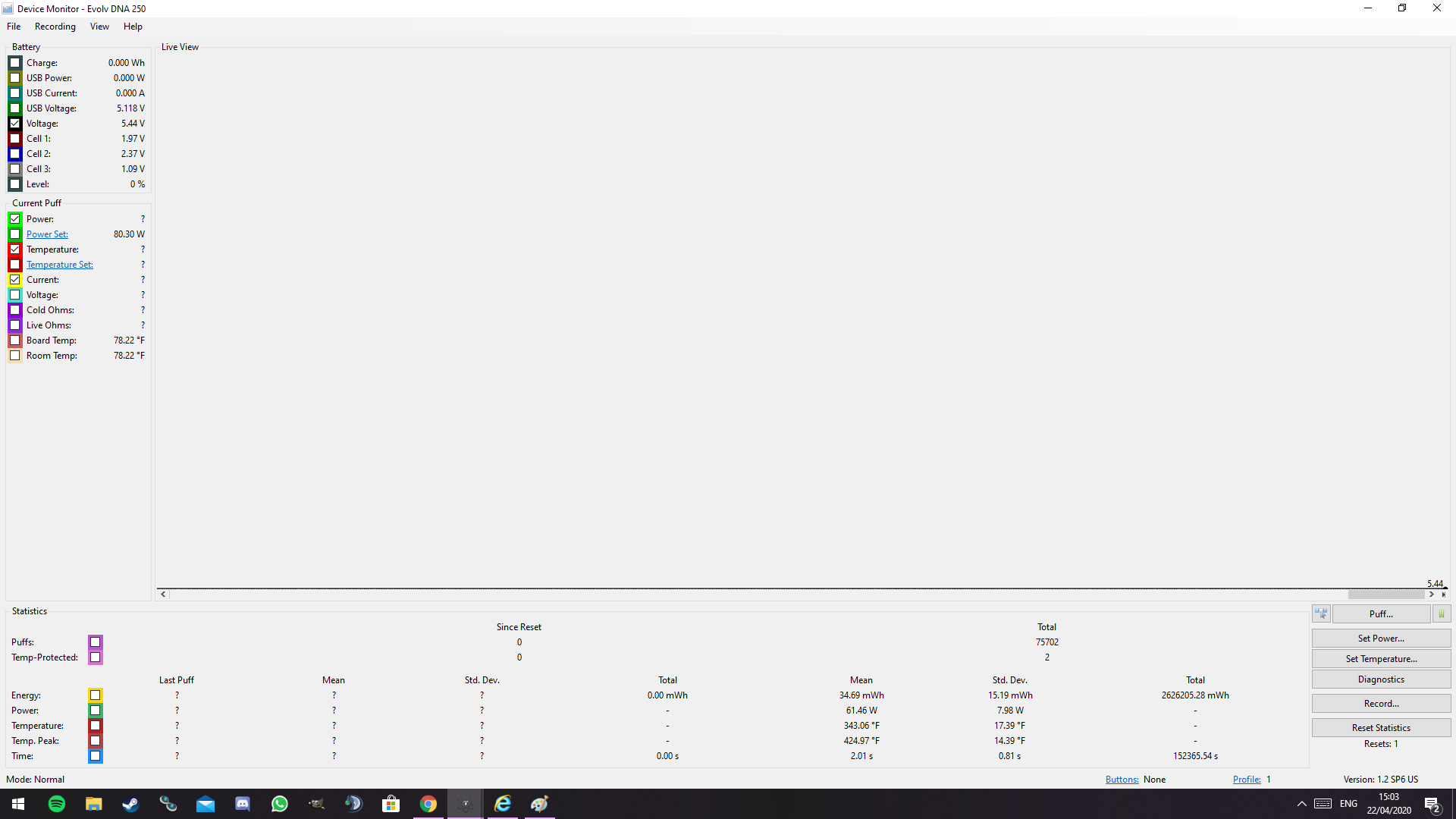

Weenuf Posted April 22, 2020 Report Posted April 22, 2020 Good afternoon, please first off accept my apologies, it is my first time in an online forum since I was twelve and I am not sure how to go about this? My partner is having some trouble with his "Evolv DNA 250" as per the title. I've downloaded escribe and it seems the Mod is still alive, it is currently in normal mode but the display is not showing anything at all. I have tried to come out of "Stealth mode" in case this is the issue, and tried using it as a right handed config as welll but neither have any result. The only function I can get the mod to perform is to lock and unlock. Putting an Atty on top has not helped either. I have also tried downloading the new update that was in the top of the Evolv programme but no change there. I've attached the Evolv Device Monitor screen - hoping it will assist you lovely folks in helping me Please can someone give me some simple to follow advice (I'm unfortunately very new to all aspects). Many thanks, Weenuf
Wayneo Posted April 22, 2020 Report Posted April 22, 2020 Is that mod actually a regular black and white screen with 3 batteries, or an internal Lipo battery? You posted in the 'color' section, but I can move it if necessary. For starters the cells look low, too low to work, but when you plugged in the cable, did the screen light up? If you look at the very bottom line where it says Mode: Normal, over to the right it will show/detect button presses. Over and on the left it shows the watts set at at 80.30, so if you press the up/down button, that value should increment/decrement 1
