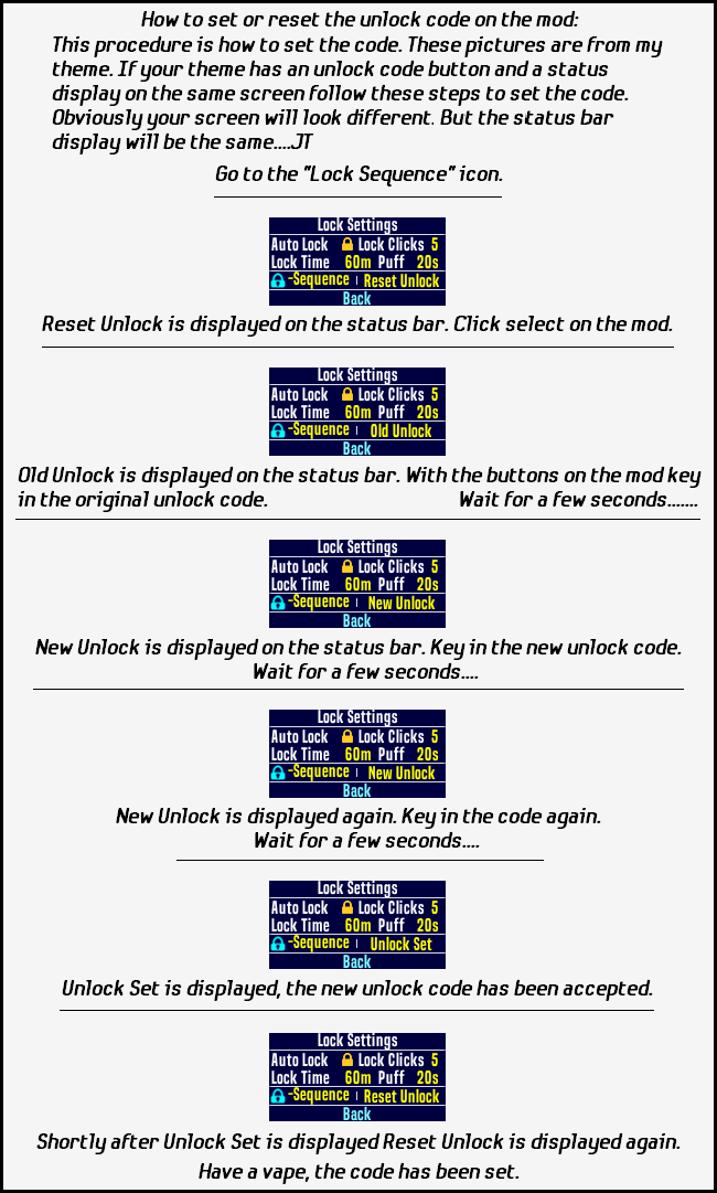

Several themes have ability to change the unlock code. A few themes including the old HCigar theme did not have a status bar on the screen. This makes the feature useless. The status display shows the instructions during the code change. I have never seen a "How To" on changing the code. This picture tutorial shows how easy it is to do.
I am going be posting several theme and Theme Designer related picture based tutorials in the future. I am going to try to make them for the person who has never used EScribe or Theme Designer before. The tutorials topic should be of interest for more experienced users too. I hope! If you find them to be useful they can be copied off the screen and pasted to your info / theme notes folder for future reference. They save as a png or jpeg file.
