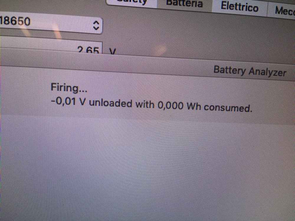

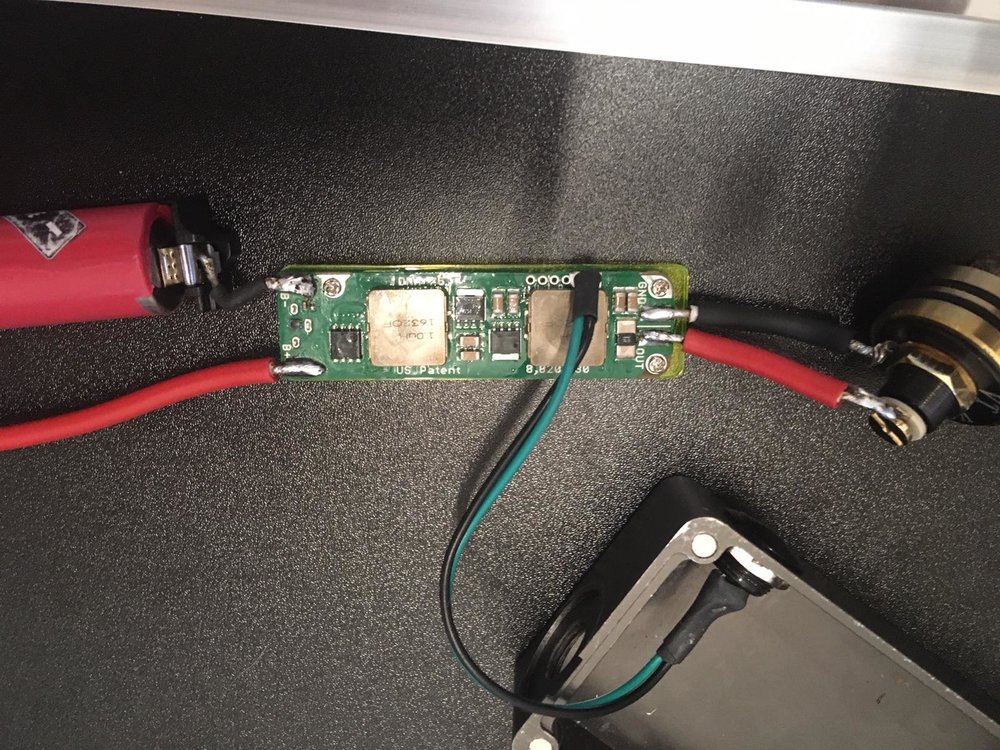

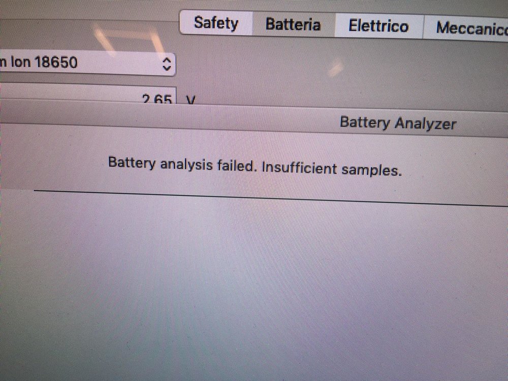

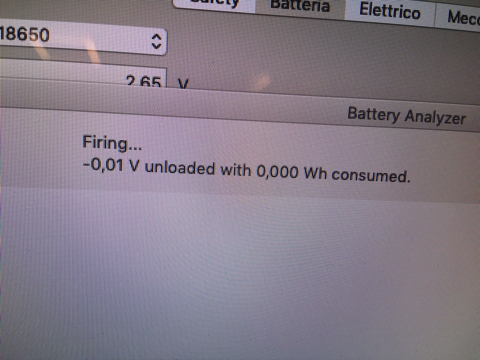

banished dj Posted March 23, 2020 Report Posted March 23, 2020 I just received the DNA75. I have a problem both with single or dual battery 18650: when I turn the board on, it shut down immeditely. When I connect it with escribe the display show battery 0%, V 0, ohm 0, a 0. Do you know if the problem is the software of firmware? Do you have the link of the right sofware and firmare do I need to use with MAC? Thanks!
retird Posted March 23, 2020 Report Posted March 23, 2020 Not enough info from you to determine the issue.... did you build the mod? The default firmware and software should be OK. Best guess is short circuit or bad grounding. More info would help....
banished dj Posted March 23, 2020 Author Report Posted March 23, 2020 yes i built the mod, did I made somethings wrong with the connections? the batteries are working with my noisy cricket2

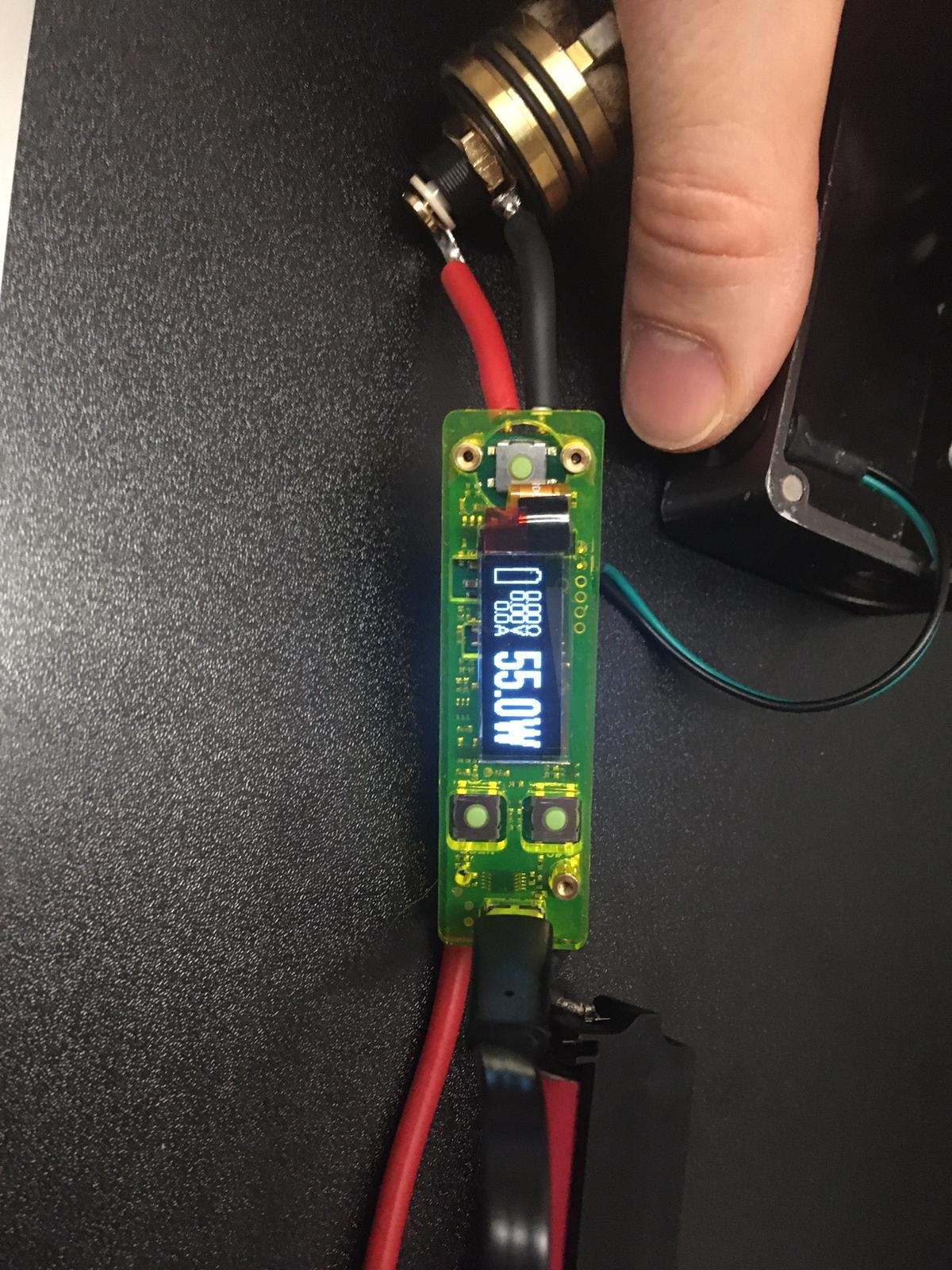

retird Posted March 23, 2020 Report Posted March 23, 2020 Does the screen light up when usb cable is not plugged in?
banished dj Posted March 23, 2020 Author Report Posted March 23, 2020 No, when I push the fire button the screen shows “evolve75” and than it shuts down. If I keep pushed the fire button the screen flash and shows “check battery” than it shuts down. I also tried with a vergin 21700 battery and it’s the same.

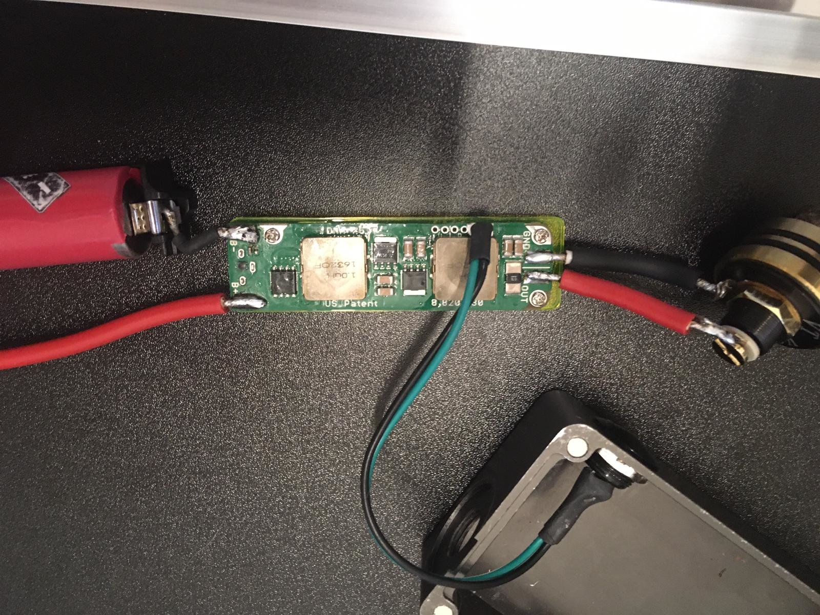

retird Posted March 24, 2020 Report Posted March 24, 2020 My best guess is that it is either a bad circuit board or excessive heat while soldering battery wires (negative connection) to the board may have damaged it. From your picture it looks like the area around the negative solder point is discolored like it got very hot. At any rate just start a ticket with Evolv and explain it to them and provide the pictures... they will guide you... https://helpdesk.evolvapor.com/index.php?a=add&category=1
