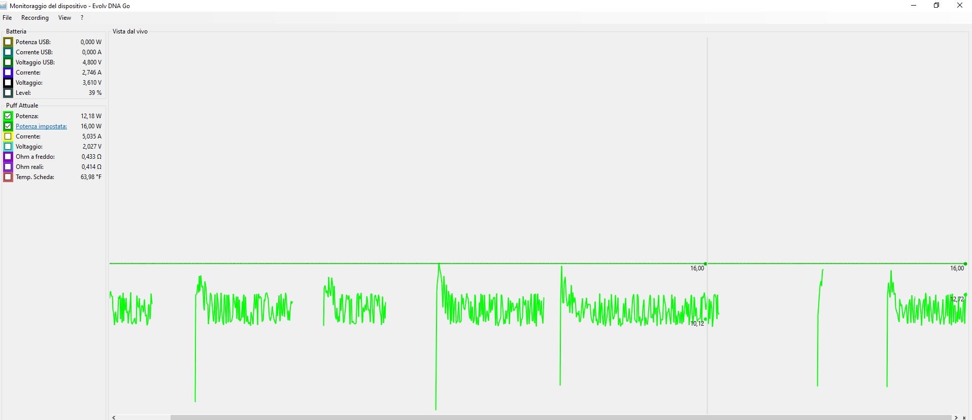

Pino74 Posted February 20, 2020 Report Posted February 20, 2020 (edited) Hi all,I bought the Neo Go dna a few days ago, and I am using new 18350 KEEPPOWER 1,200 mAh 10 amp batteries, despite the low resistances, in the order of 0.25-0.40 ohms, and despite the power set at 12-14-16- 18 watts, in escribe I do not exceed 10 watts of power, I even see that the volts also drop to 1.80. All this with new batteries have a week of life and 100% charge. I tried to change atomizer and various wire thicknesses, I am using a 26 awg, SS316, but also with SS316 28 awg it is the same thing.Yesterday everything was fine, I was also up to 20 watts today without any reason with 6 different batteries all new and all 10 amps I don't get more than 10 watts of power. what happens? who can help me?Thanks Edited February 20, 2020 by Pino74

Pino74 Posted February 21, 2020 Author Report Posted February 21, 2020 (edited) HI DWCRAIG 1 I attach csv file, I checked the batteries with the testet they are charged (they have a week of life) and I ticked the volt box, it never drops below 3.7 volts. I also cleaned the connector with alcohol and inside the card to make sure that everything is dry. If you set for example 16 watts, I get there in the graph for half a second, then it always stands at 10 watts on average, whatever power I set. I also tried with another good quality atomizer always with ss316 at 0.25 ohm and it is the same thing, the box does not want to push more than 10 watts. up to two days ago everything was fine, I thought about the liquid leaking from the atomizer, which went into the box, but I checked it well, everything is clean inside. maybe some sensor of the wet circuit? what can I do? I forgot to add that replay is logically disabled !!!! Thanks Values.csv Edited February 21, 2020 by Pino74
Pino74 Posted February 21, 2020 Author Report Posted February 21, 2020 if u can see in this attachment, the volts are at 3,777 despite being 44% battery, with 100% battery also arriving at 4.0-3.9 volts quietly. it is the power that oscillates quickly even in the graph and continuously
