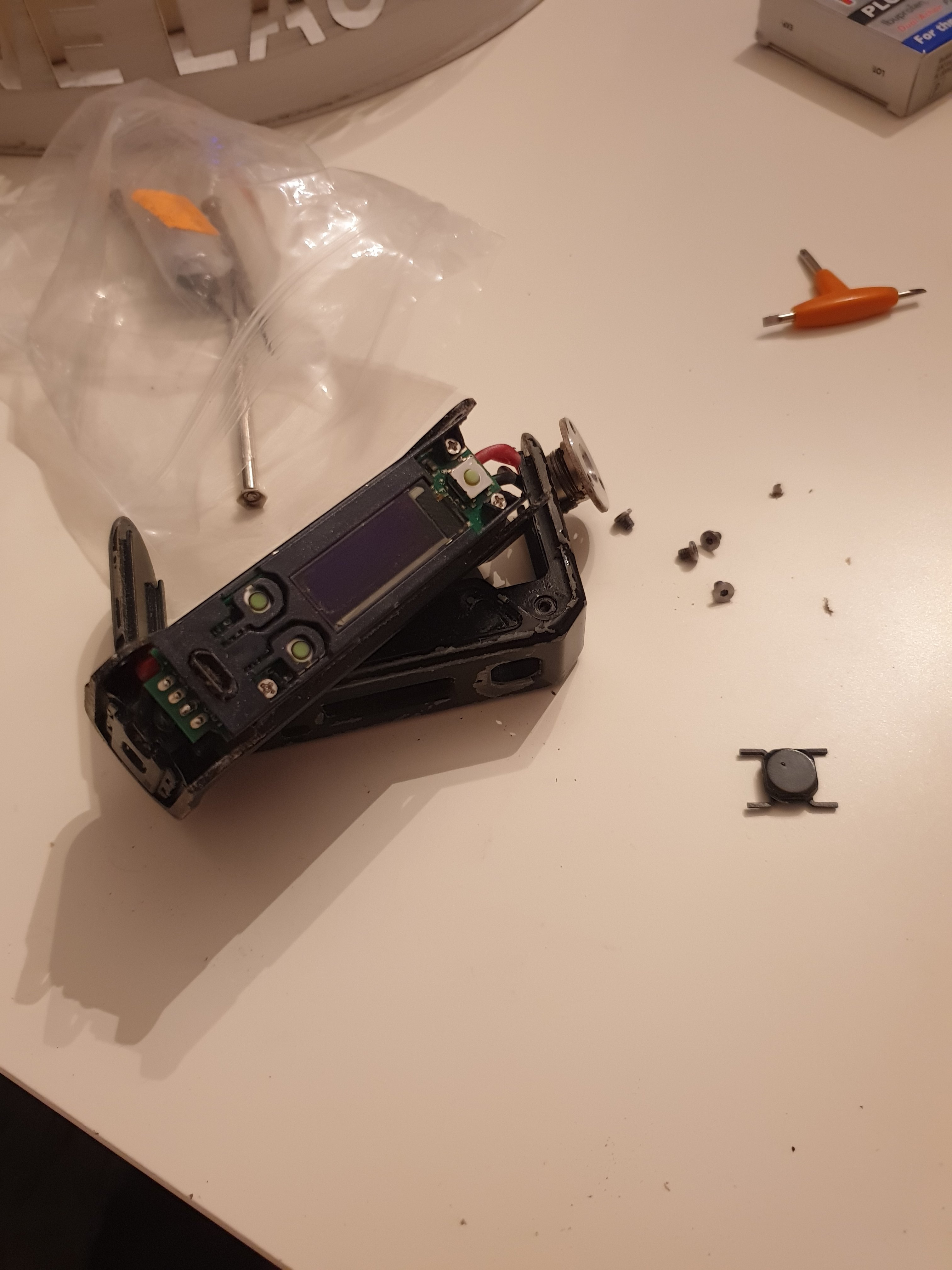

Kamelot Posted January 31, 2020 Report Posted January 31, 2020 There is probably no hope, but my fire button is sticking and it means I don't want to use my Therion as I'm worried something will happen. Does anyone know a way to fix this issue?
Wayneo Posted January 31, 2020 Report Posted January 31, 2020 That board button is actually composed of 3 pieces. You can carefully remove the top metal section by the raised section in each side, and below remove the rubber and silver disc, then clean them all and re-assemble. Or, failing that, open a Help Desk ticket for their guidance. Link in my sig. 1
