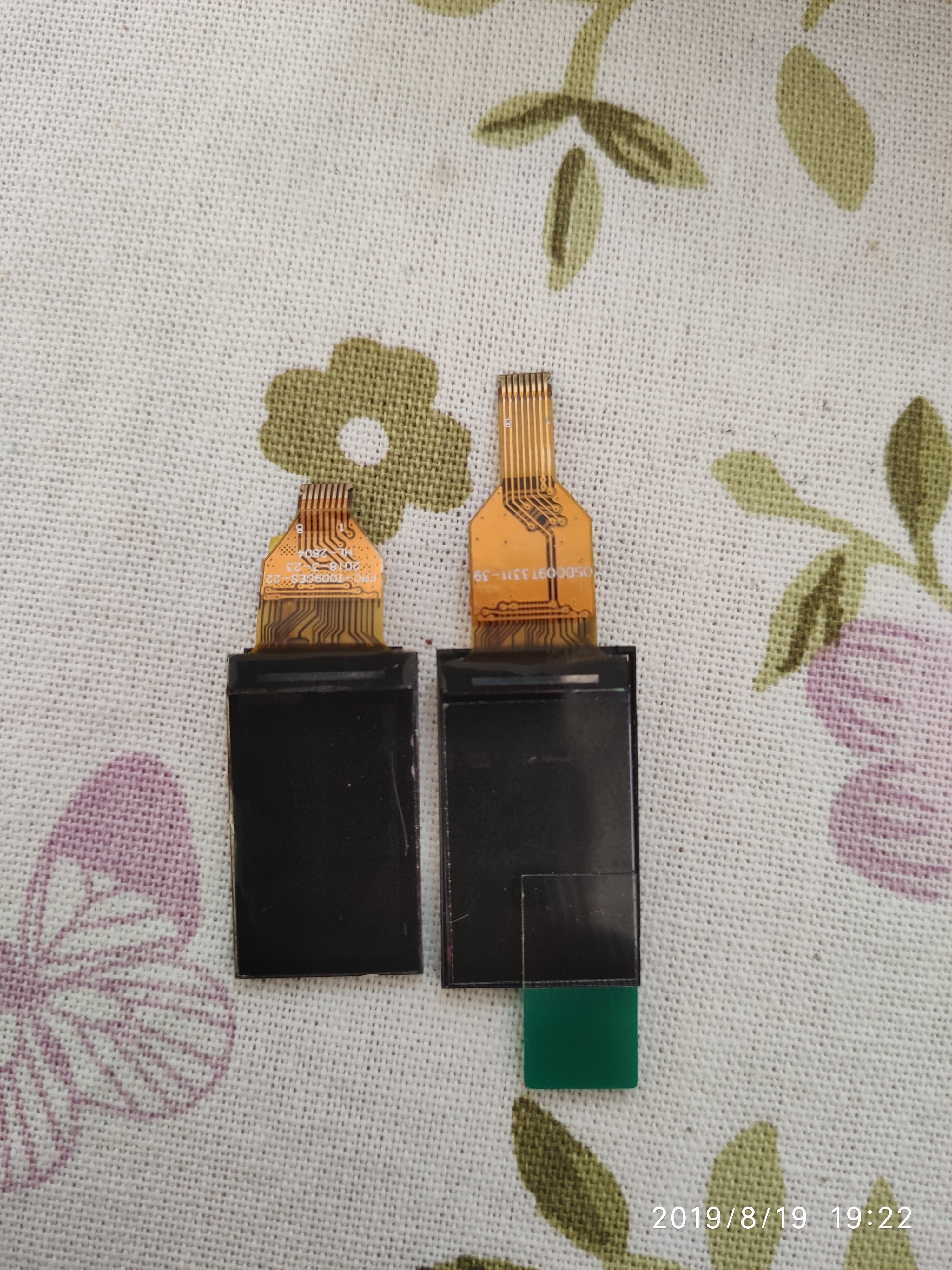

Lbmartinho Posted August 19, 2019 Report Posted August 19, 2019 Hi everyone. 2 month's ago my screen became black. I sent an email to Lost Vape but they didn't care. So i bought a new screen and changed it. The only weird thing is the new screen because the wire is bigger than the original. It's working but is making some pressure on the fire button. Became more sensitive when i press it.
Wayneo Posted August 19, 2019 Report Posted August 19, 2019 Search box works here. It was a somewhat common problem, solved by bending the cable out of the way, like an accordian. In this search link, I think @Spector NS5 RD had the most detailed response. https://forum.evolvapor.com/search/?q=bend ribbon fire&search_and_or=and Welcome
