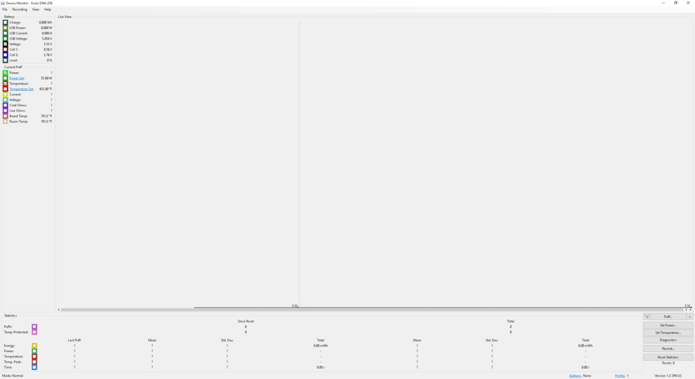

mordecai131 Posted February 3, 2019 Report Posted February 3, 2019 Hello everyone, I'm in the process of building my first mod and after getting everything wired up I'm getting a check battery error. It's a dual 18650 mod and the batteries I'm using I have been using just fine and work in every other mod I have. I've include an image of my device monitor. Multimeter tests at the battery terminals register about 9v and where the wires make contact to the board also register at 9v. Would wire gauge possibly be the issue? I only had 22 gauge on hand and that's what I've been using but I order 18 gauge just in case.
retird Posted February 3, 2019 Report Posted February 3, 2019 How did you wire the balancing wires? From your screenshot you are building a DNA250 (2 cell) @Wayneo posted this some time ago.....
