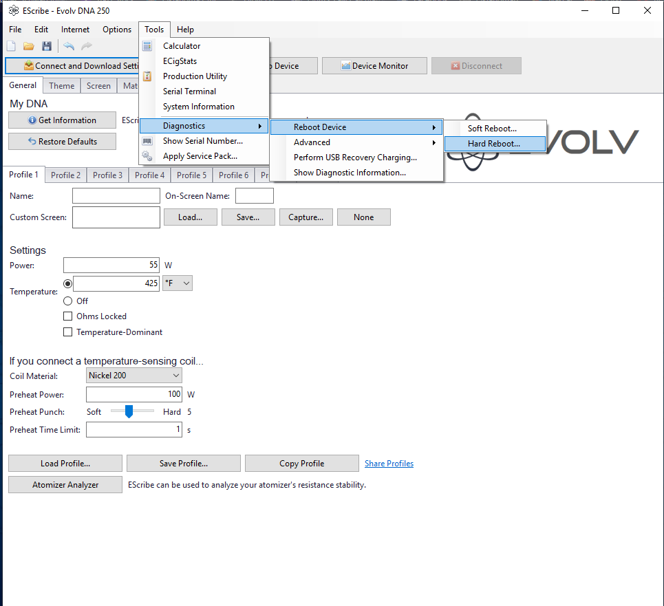

HxChris Posted January 12, 2019 Report Posted January 12, 2019 So yesterday I woke up and got in three perfectly normal drags off my vape before noticing that the display wasn’t working properly; as I took my drags the wattage value wasn’t changing, and furthermore when I went to lock the device and access the menu, it lagged significantly, and different sections of the display would change a second or two before other sections. Shortly after, the mod would only fire for a few seconds before cutting off, glitch text would run through the display when I tried messing with it, eventually it stopped firing altogether, and finally while I had it on a charger yesterday evening it displayed a Warranty Service message and hasn’t done anything since. Does anyone have any suggestions for steps I might take to rule out possible issues I could take care of myself? Also, is there any way to perform a hard reset on a DNA 250? 1

retird Posted January 12, 2019 Report Posted January 12, 2019 2 hours ago, HxChris said: Also, is there any way to perform a hard reset on a DNA 250?
HxChris Posted January 14, 2019 Author Report Posted January 14, 2019 On 1/12/2019 at 4:30 PM, retird said: Thank you, hopefully this will do something!
