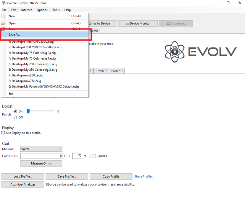

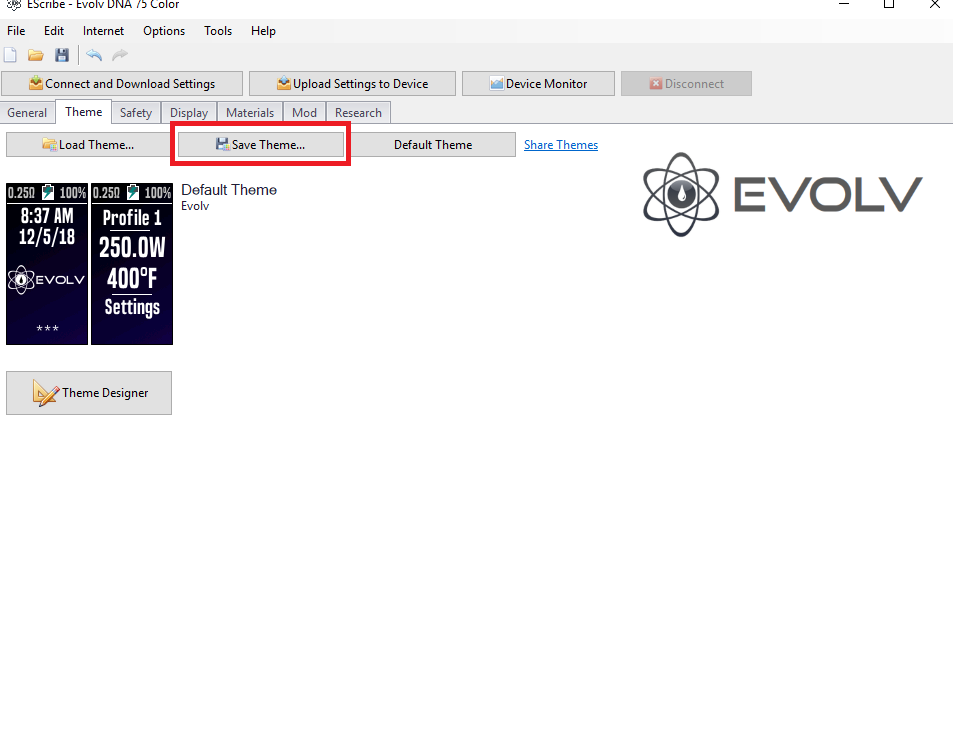

retird Posted December 5, 2018 Report Posted December 5, 2018 You can save the Mirage 75C *.ecig file (which includes the theme) to your computer before changing to another theme. You can also just save the Theme to your computer. Then you can load them back as you desire . This is done in EScribe. 1
