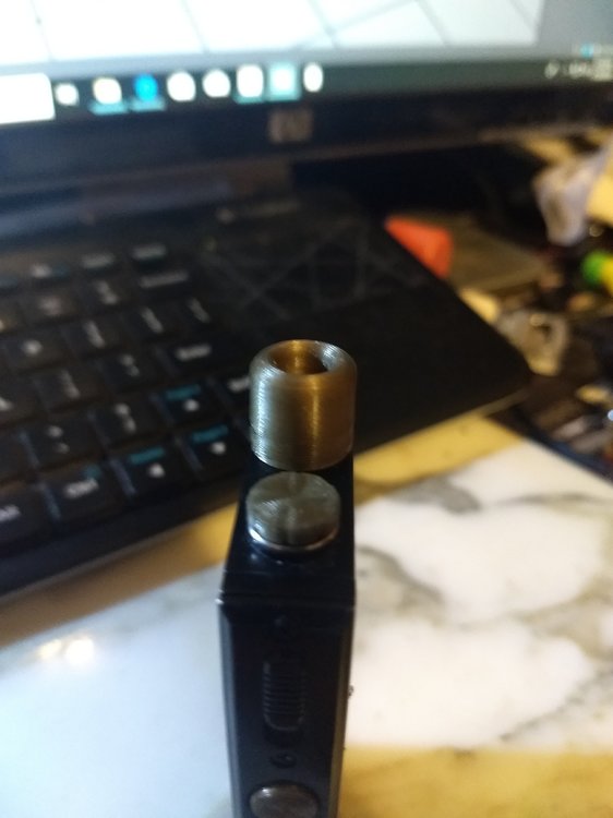

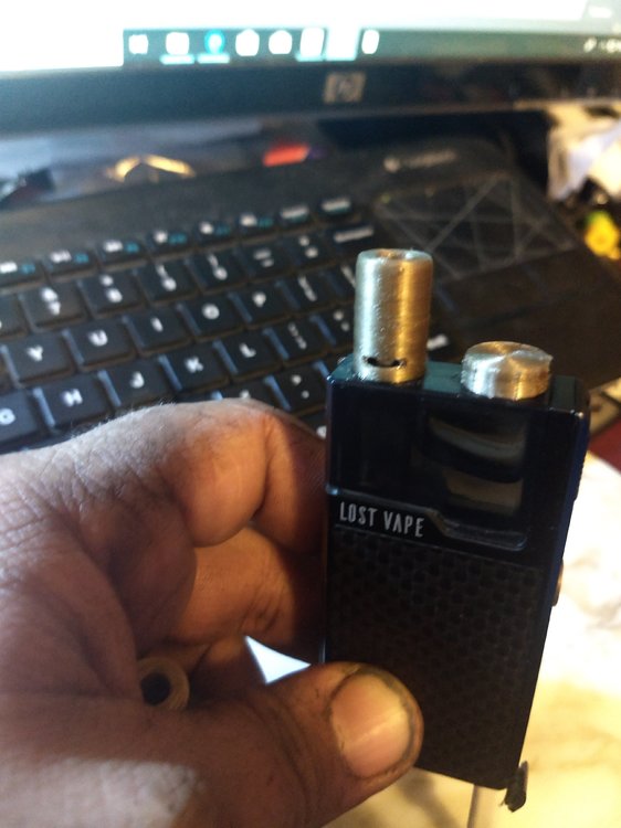

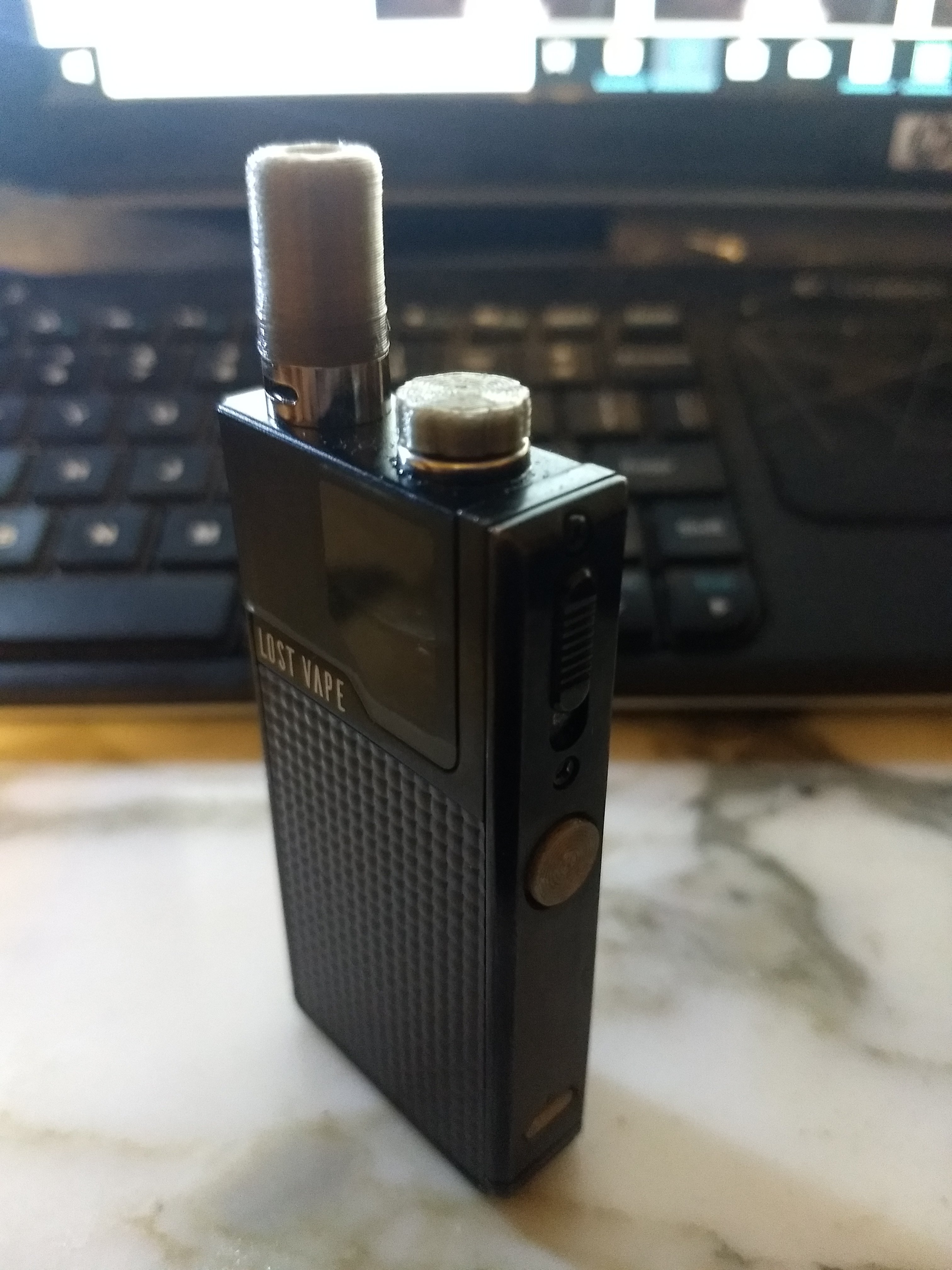

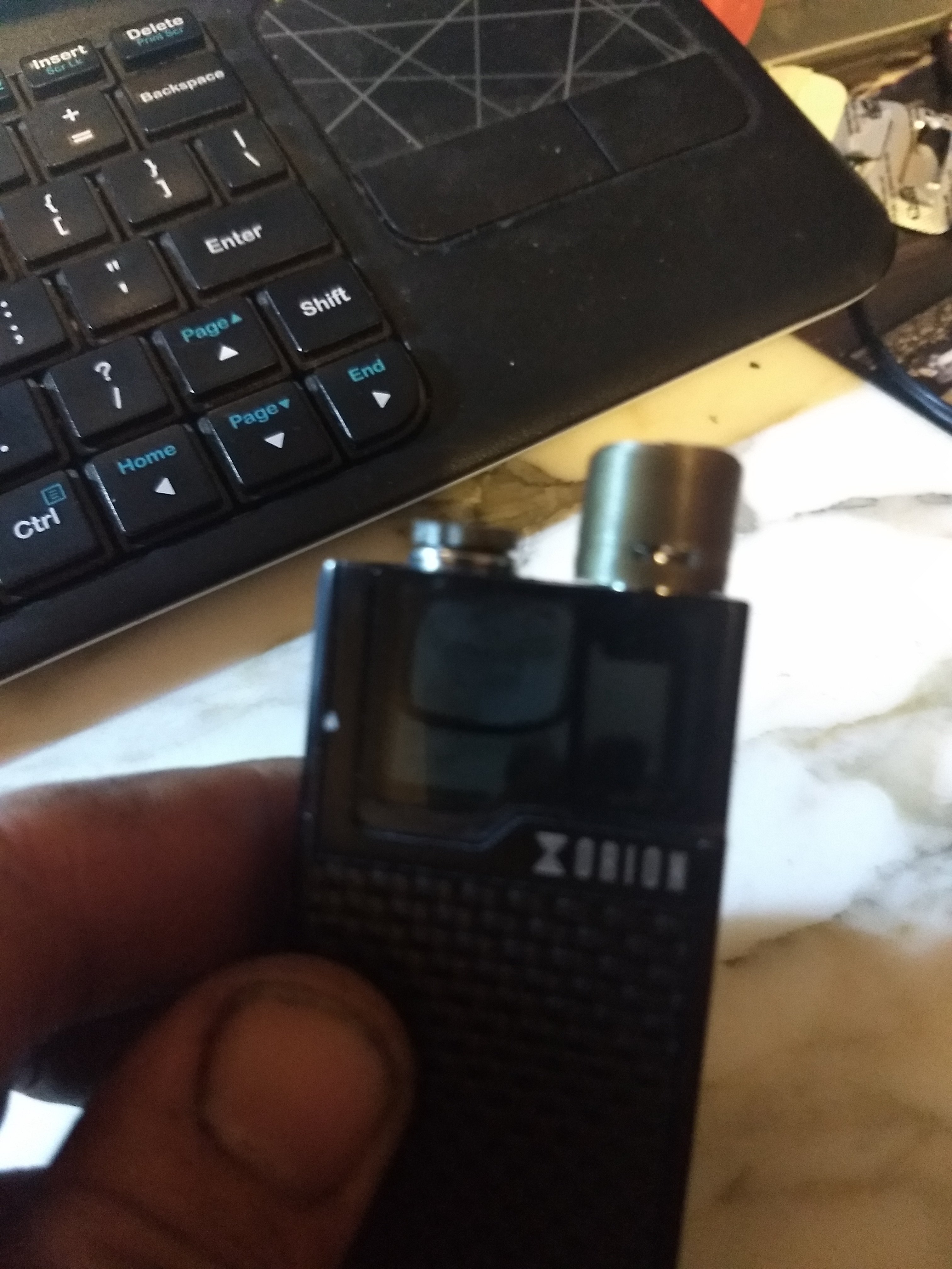

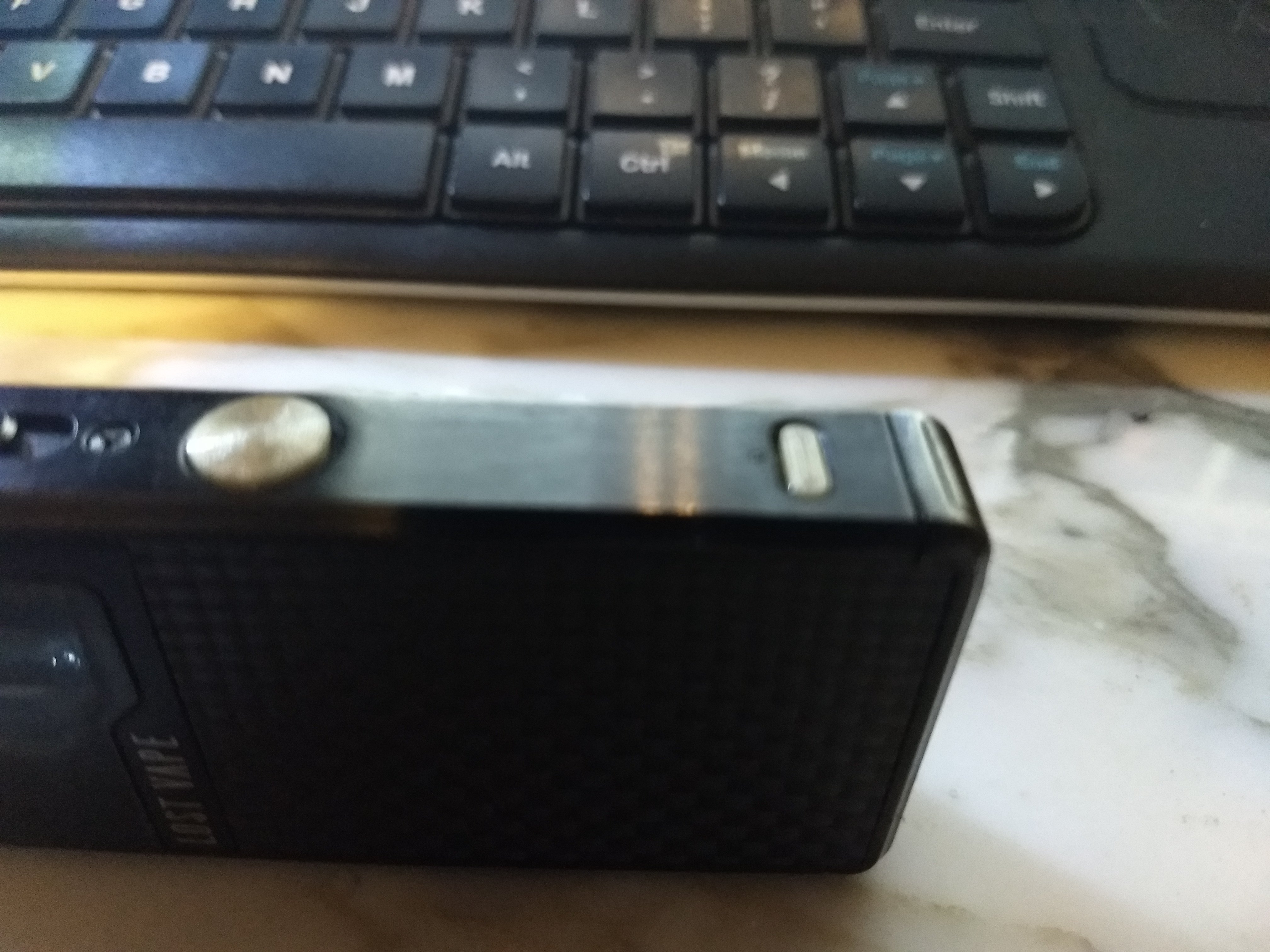

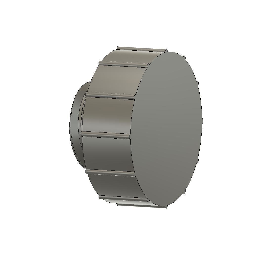

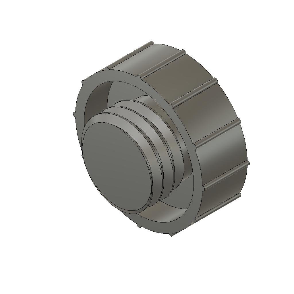

67exec Posted November 26, 2018 Report Posted November 26, 2018 (edited) Is anyone doing/interested in custom buttons, tips, fill caps for the Orions? All parts shown are using Form Futura Gold HDGlass (petg) Edited November 26, 2018 by 67exec Added info 1
ArminF Posted November 26, 2018 Report Posted November 26, 2018 (edited) Excellent.. i know someone will try to print them. What about a tip which covers the airflow slots as well. A kind of press fit with some knurling so the whole tip could be used to adjust the airflow. The AFC is a ring which can be removed so use the drip tip to make this work and bring it to the bottom as one part. And the all black would then really look all black. Maybe Carbon printed as well About the tank caps. Do they really seal the tank? I saw some custom made resin DTs as well on a facebook post earlier. But a standard 510 would be best in my opinion. Even if they can get loose and lost. i bet there will be new tanks/pods coming out with these features. Edited November 26, 2018 by ArminF more details
67exec Posted November 26, 2018 Author Report Posted November 26, 2018 (edited) Yes, the tank caps seal, I designed them to use the factory oring. As far as using the drip tip for the AFC, not something thats very easy to do because of it's design. There's knurling above the AFC that holds the drip tip on. Edited November 26, 2018 by 67exec

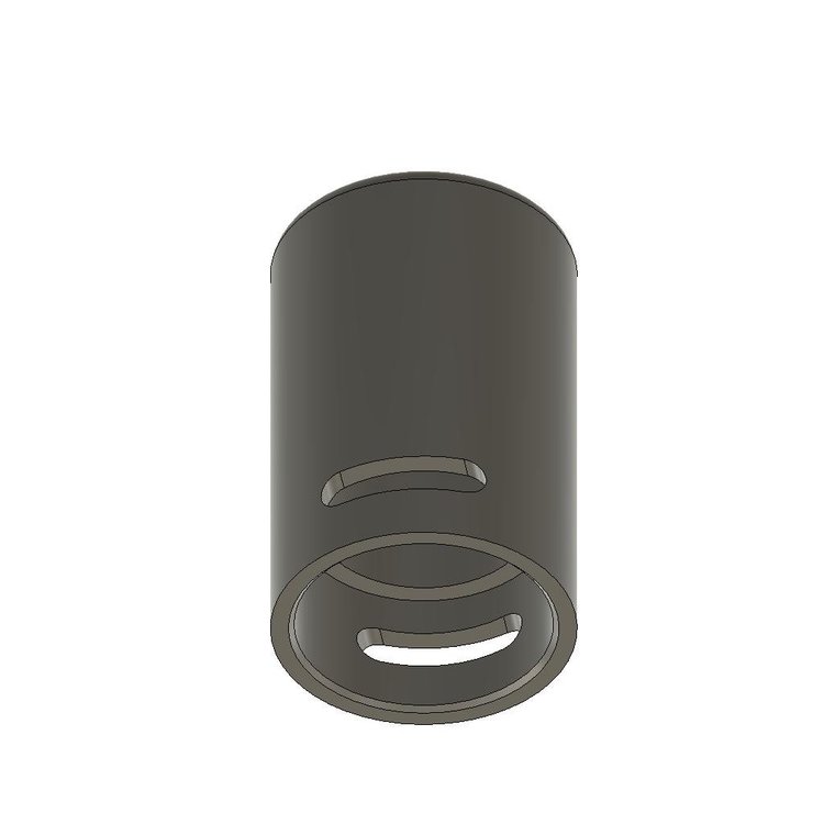

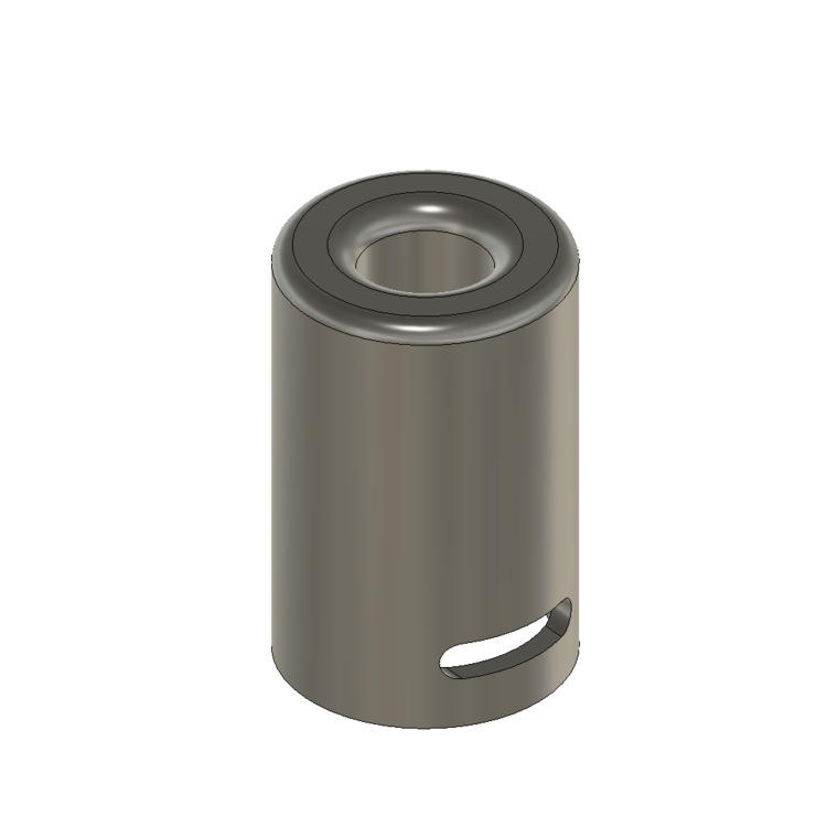

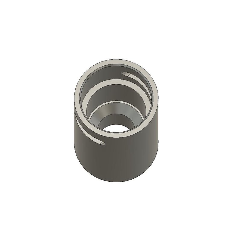

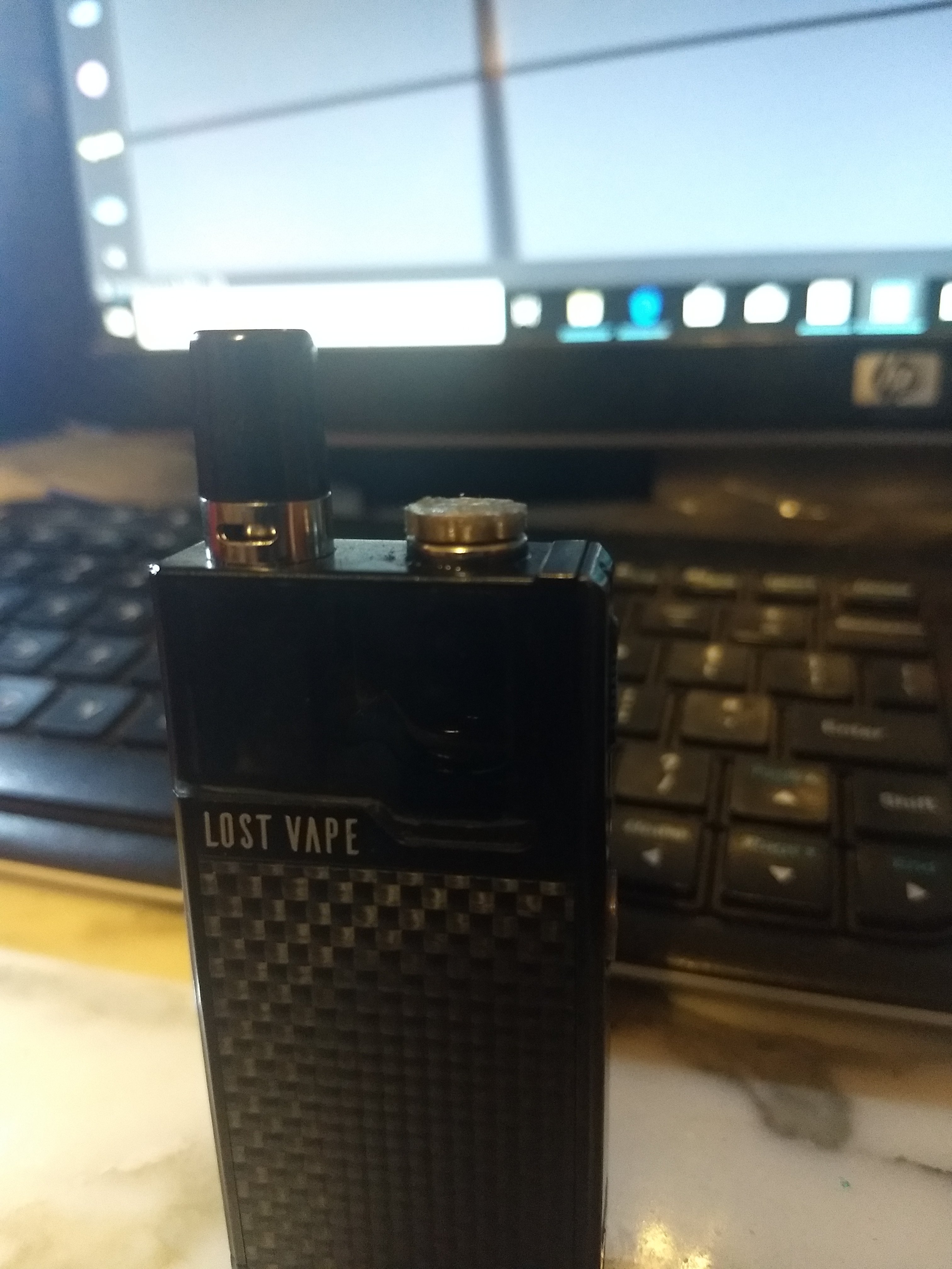

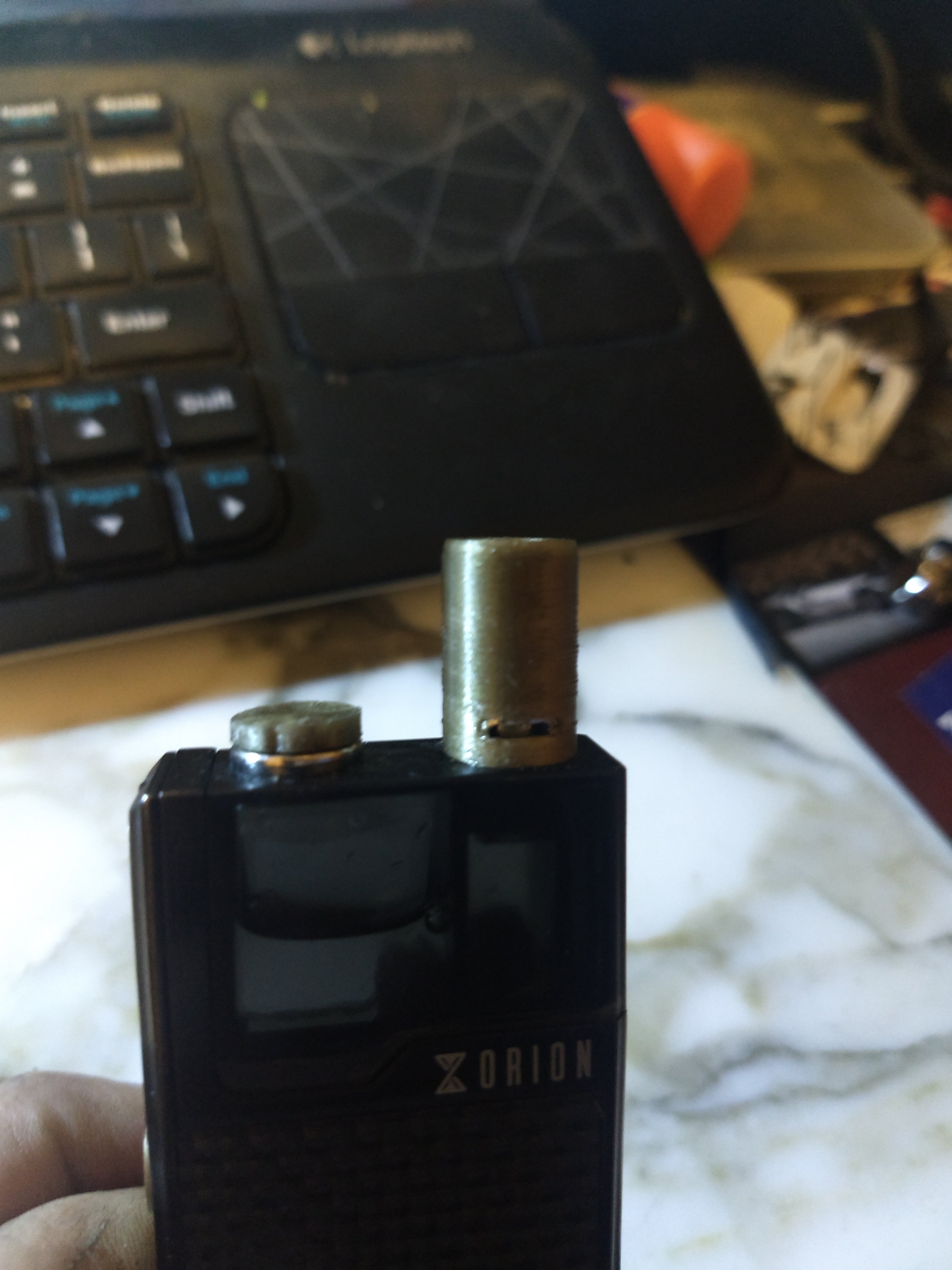

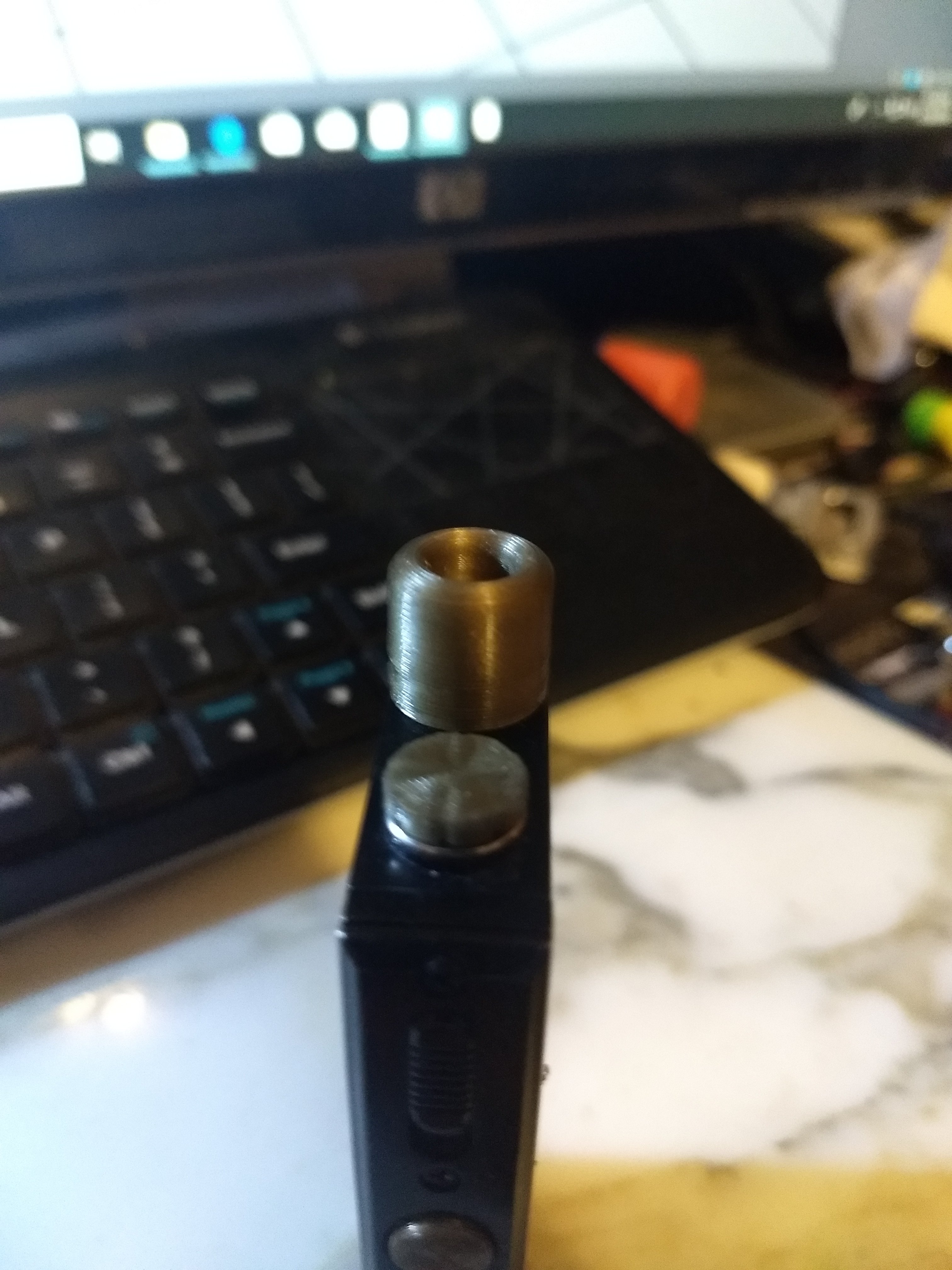

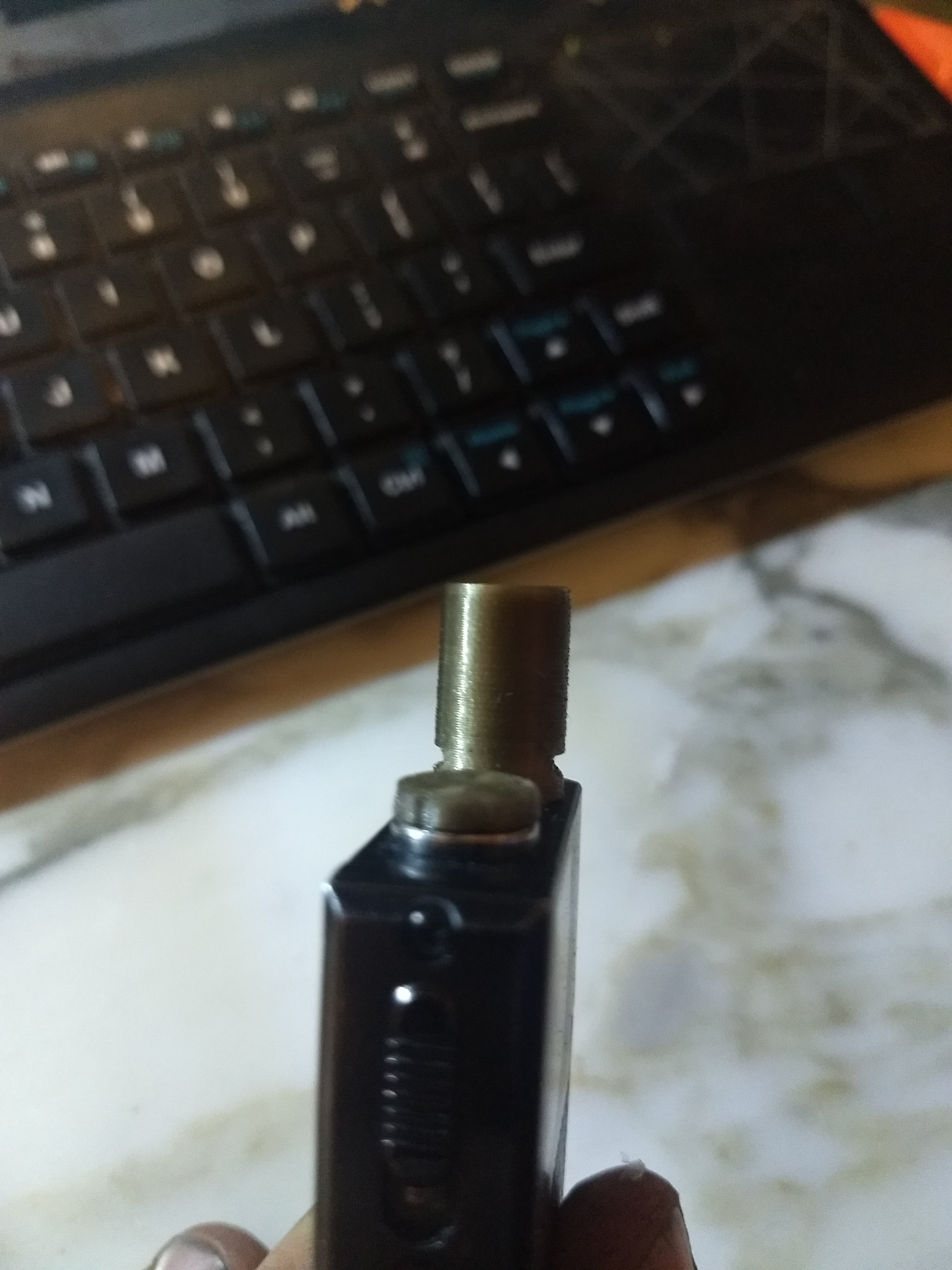

67exec Posted November 27, 2018 Author Report Posted November 27, 2018 @ArminF This is what I came up with based on your design. I narrowed it up to make it more uniform with the fill cap, and not to impede removal of the cap. Your tip is the last 2 pics 1

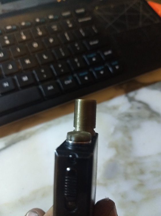

67exec Posted November 28, 2018 Author Report Posted November 28, 2018 (edited) @ArminF Are these what you were thinking? It's printing now Edited November 28, 2018 by 67exec
67exec Posted November 28, 2018 Author Report Posted November 28, 2018 Implemented. I made it a smidge to tight on the I'd, and it will probably have to be printed with a .2 nozzle @ .1 instead of a .4 @ .1
ArminF Posted November 28, 2018 Report Posted November 28, 2018 WOW! Just WOW... With a black print the Orion goes back to black then
