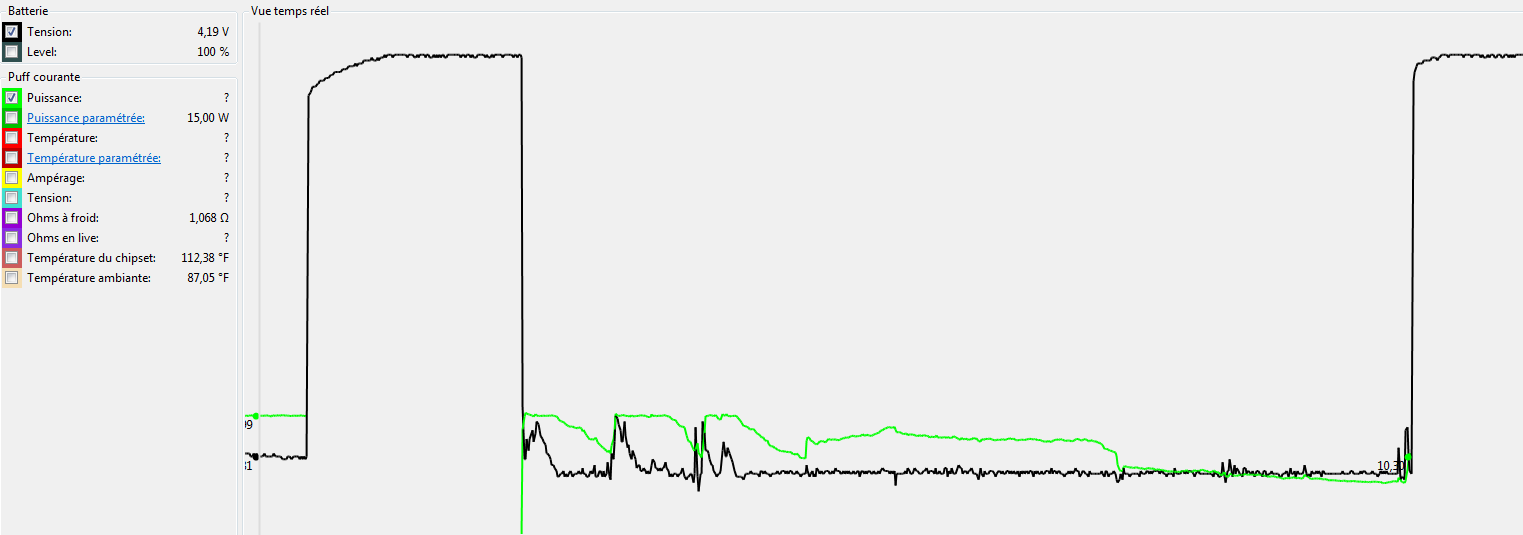

dwcraig1 Posted November 13, 2018 Report Posted November 13, 2018 If your hoover your mouse on the line marked by arrow in Device Monitor it will show what the voltage is. What does it say?
french Posted November 13, 2018 Author Report Posted November 13, 2018 I vap kanthal and no TC ,and thank you for snipping tool

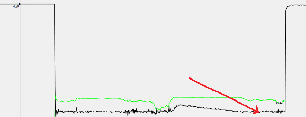

dwcraig1 Posted November 13, 2018 Report Posted November 13, 2018 At 15 watts you should be getting very little voltage drop . I'd be looking at the cell it's self, have you tried another battery. Check closely the battery holders contacts, wire connection to contacts, ect. Edited to include the word "drop"
dwcraig1 Posted November 13, 2018 Report Posted November 13, 2018 Check my last post., power isn't making it to board properly
french Posted November 13, 2018 Author Report Posted November 13, 2018 Everything is well connected, the box worked well when I buy it and suddenly it does that, I change the chip and it remakes the same problem
dwcraig1 Posted November 13, 2018 Report Posted November 13, 2018 The problem appears to be with battery, battery holder, wires from battery holder to board. How is the ground connection done on the negative side of the battery? is it a chassis ground or wired. Clean the battery caps threads and the threads of the mod with alcohol (if it has this)

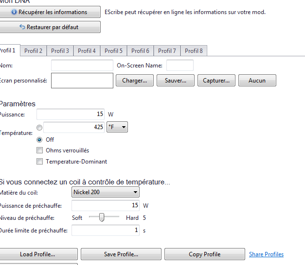

french Posted November 13, 2018 Author Report Posted November 13, 2018 I ask myself if the cutt of the battery is too low, 2.75V set by evolv
dwcraig1 Posted November 13, 2018 Report Posted November 13, 2018 No, as that's about as low as you want it to be set to. With a 15 watt load on a full charged battery your voltage drop should be almost 4 volts.
