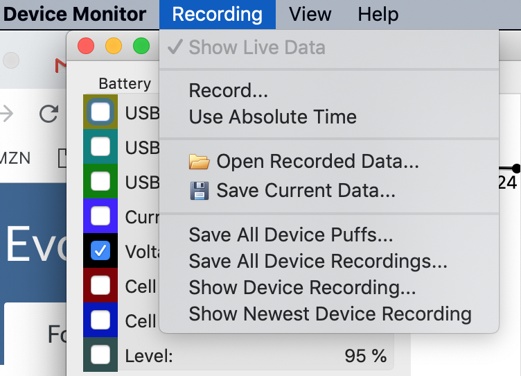

Struktur Posted September 19, 2018 Report Share Posted September 19, 2018 With “Save all device puffs“ in Device Monitor, you get a file with 20 fields. It would be helpfull to add a field with “Profile“ ID (and/or Profile name). * Puff * "Date/Time (GMT)" * "Date/Time (Local)" * RTC * Recorded * "Board Temperature" * "Raw Ohms" * Time * Energy * Power * Temperature * "Peak Temp" * "Coil Loss" * "Room Temperature" * "Ground Ohms" * "Power Setpoint" * "Temperature Setpoint" * "Cold Ohms" * "Cold Temperature" * "Static Ohms" Link to comment Share on other sites More sharing options...

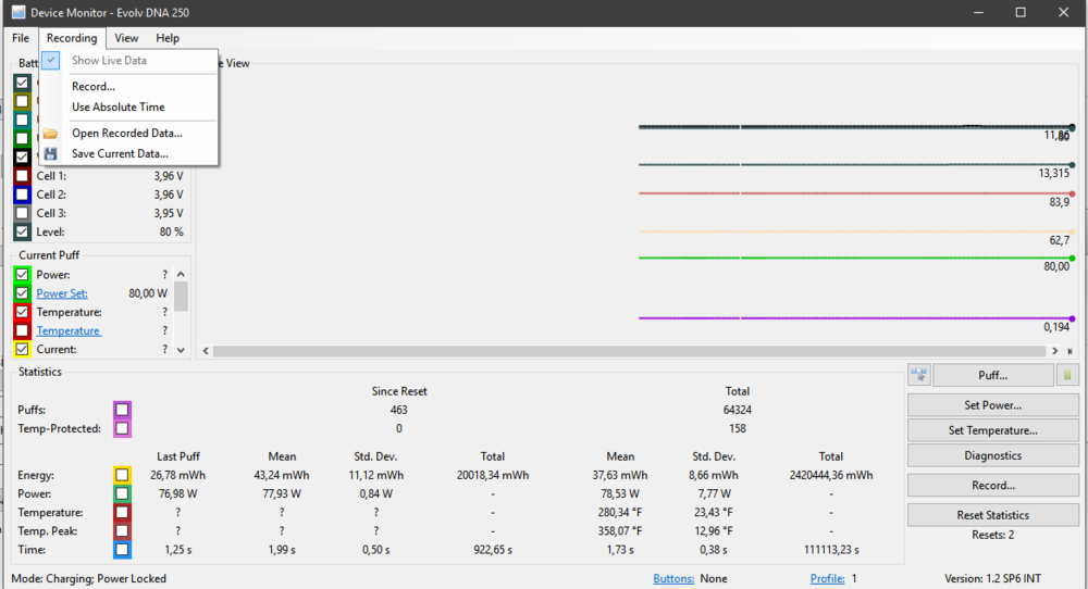

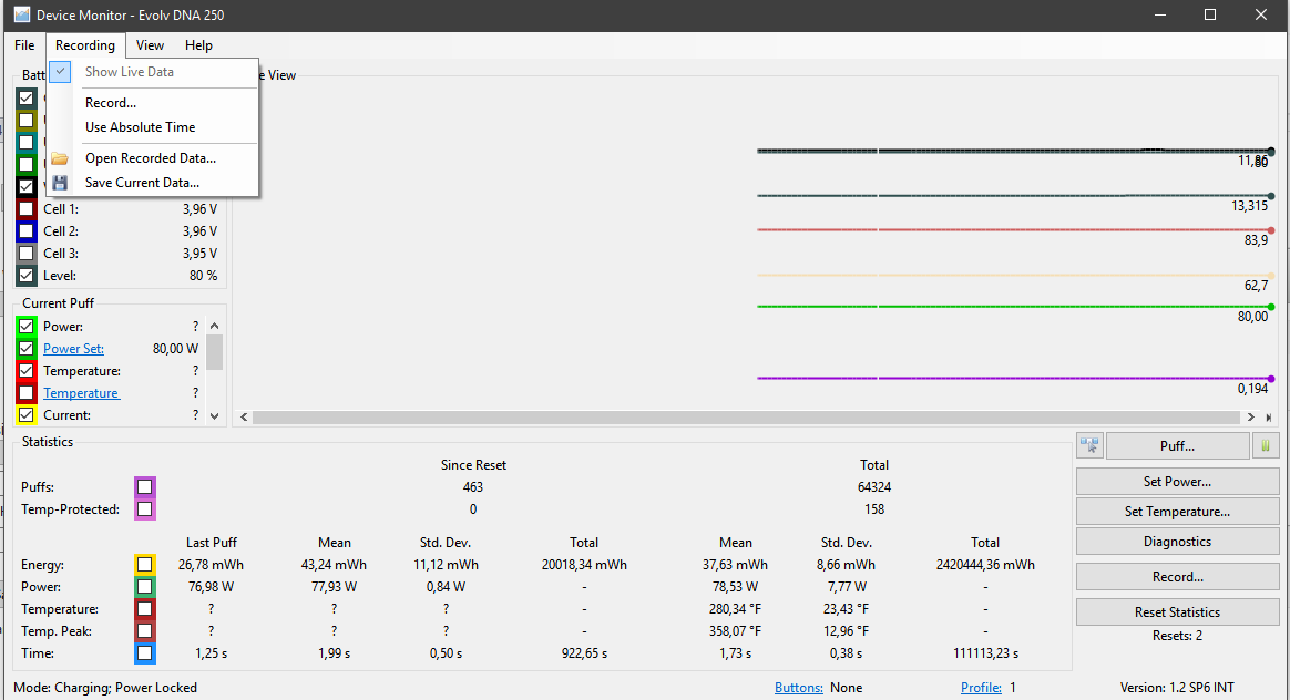

Gnagnom94 Posted December 14, 2018 Report Share Posted December 14, 2018 On 9/19/2018 at 1:54 PM, Struktur said: With “Save all device puffs“ in Device Monitor, you get a file with 20 fields. It would be helpfull to add a field with “Profile“ ID (and/or Profile name). Expand Where can I find "Save all device puffs" ? On device monitor does not exist. I have a DNA 250. Link to comment Share on other sites More sharing options...
Wayneo Posted December 15, 2018 Report Share Posted December 15, 2018 DNA250C (Color screen) Link to comment Share on other sites More sharing options...
Gnagnom94 Posted December 15, 2018 Report Share Posted December 15, 2018 (edited) On 12/15/2018 at 1:21 AM, Wayneo said: DNA250C (Color screen) Expand Unfortunately there's not this function for DNA 250 as you can see. Is it possible in some way, to use this functionality also for the standard DNA 250? Can you send the resulting output file? Edited December 15, 2018 by Gnagnom94 Link to comment Share on other sites More sharing options...
Wayneo Posted December 15, 2018 Report Share Posted December 15, 2018 On 12/15/2018 at 2:09 PM, Gnagnom94 said: Unfortunately there's not this function for DNA 250 as you can see. Expand You are correct, and why I specified 'color screen'. The color screen 250 saves those fields as a delimited csv file for each puff. AND with much more precision than the non color 250 using 'save all data'. On 12/15/2018 at 2:09 PM, Gnagnom94 said: Is it possible in some way, to use this functionality also for the standard DNA 250? Expand Not that I'm aware of, although there is a 'Data Aquisition' option in the 'Research' tab but I haven't played with it. Link to comment Share on other sites More sharing options...
