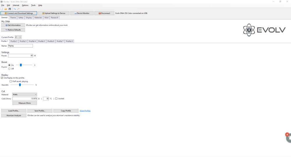

clivy Posted September 15, 2018 Report Posted September 15, 2018 I know this may sound very simple but have you got the "use replay in this profile" box checked in the profiles on escribe?
memo83 Posted September 15, 2018 Report Posted September 15, 2018 (edited) 7 minutes ago, clivy said: I know this may sound very simple but have you got the "use replay in this profile" box checked in the profiles on escribe? 🙂 yes i had it checked. Edited September 15, 2018 by memo83

dwcraig1 Posted September 15, 2018 Report Posted September 15, 2018 The Escribe snipet is showing Profile #1 but the mod is set on Profile #2 1

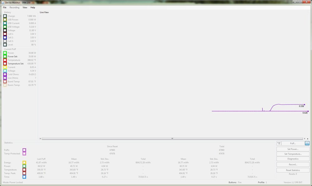

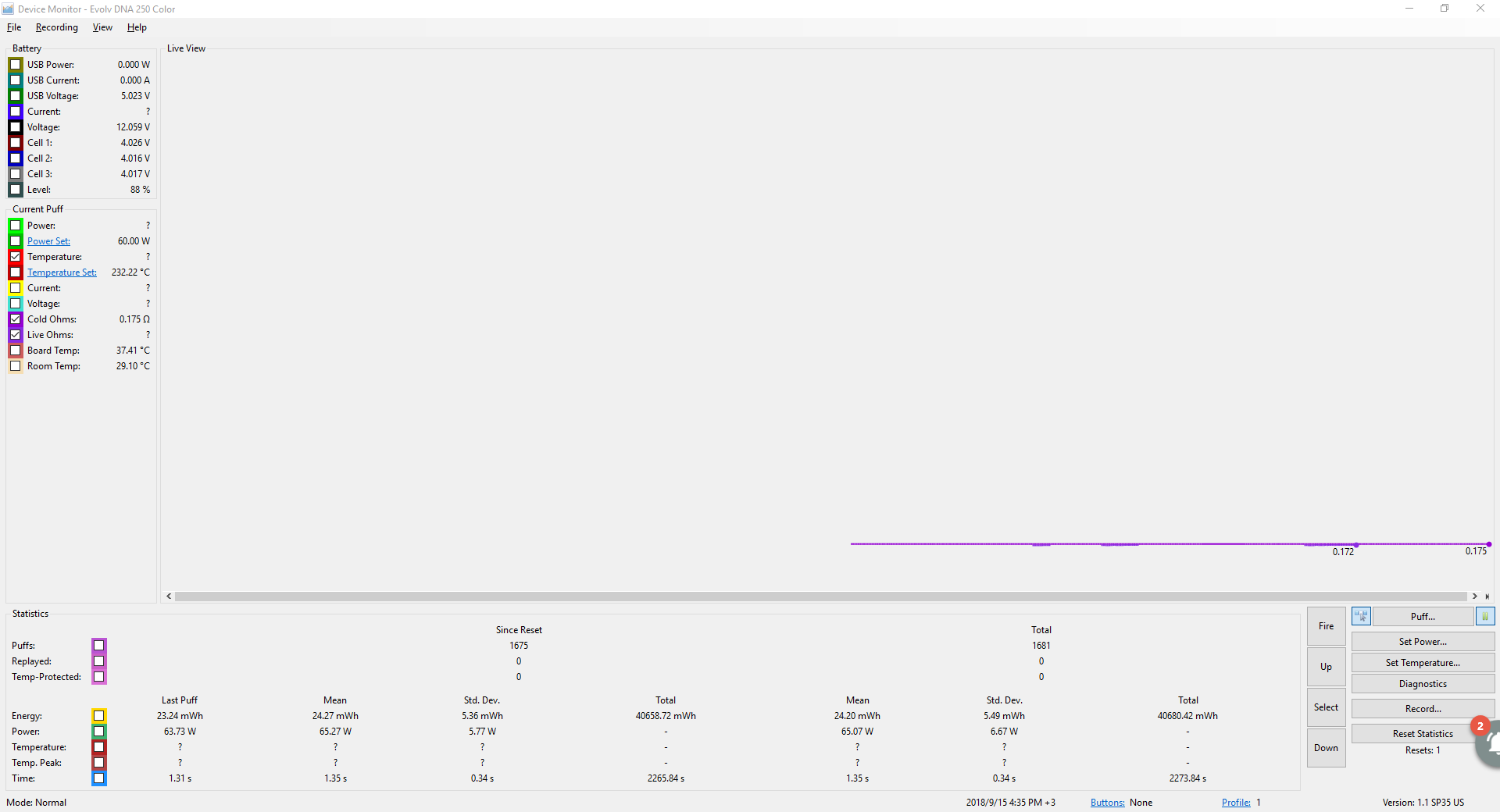

dwcraig1 Posted September 15, 2018 Report Posted September 15, 2018 Use Device Monitor to check to make sure the wire's resistance changes from cold to hot. Kanthal and Nichrome will have the resistance stay the same as cold when heated, Replay will not work without the change taking place.
memo83 Posted September 15, 2018 Report Posted September 15, 2018 24 minutes ago, dwcraig1 said: The Escribe snipet is showing Profile #1 but the mod is set on Profile #2 yes, before taking the snipet i switched the mod to wat mode, but profile #1 is the main one i was testing the whole time with the replay
memo83 Posted September 15, 2018 Report Posted September 15, 2018 25 minutes ago, dwcraig1 said: Use Device Monitor to check to make sure the wire's resistance changes from cold to hot. Kanthal and Nichrome will have the resistance stay the same as cold when heated, Replay will not work without the change taking place. hah, you are right, it's staying the same! as i said i'm kinda new to this "on the technical level", does that mean my coils are not SS or is it something else?
dwcraig1 Posted September 15, 2018 Report Posted September 15, 2018 Use stainless steel or nickel or any TC wire. 1
dwcraig1 Posted September 15, 2018 Report Posted September 15, 2018 Your coils are either Kanthal or Nichrome 1
