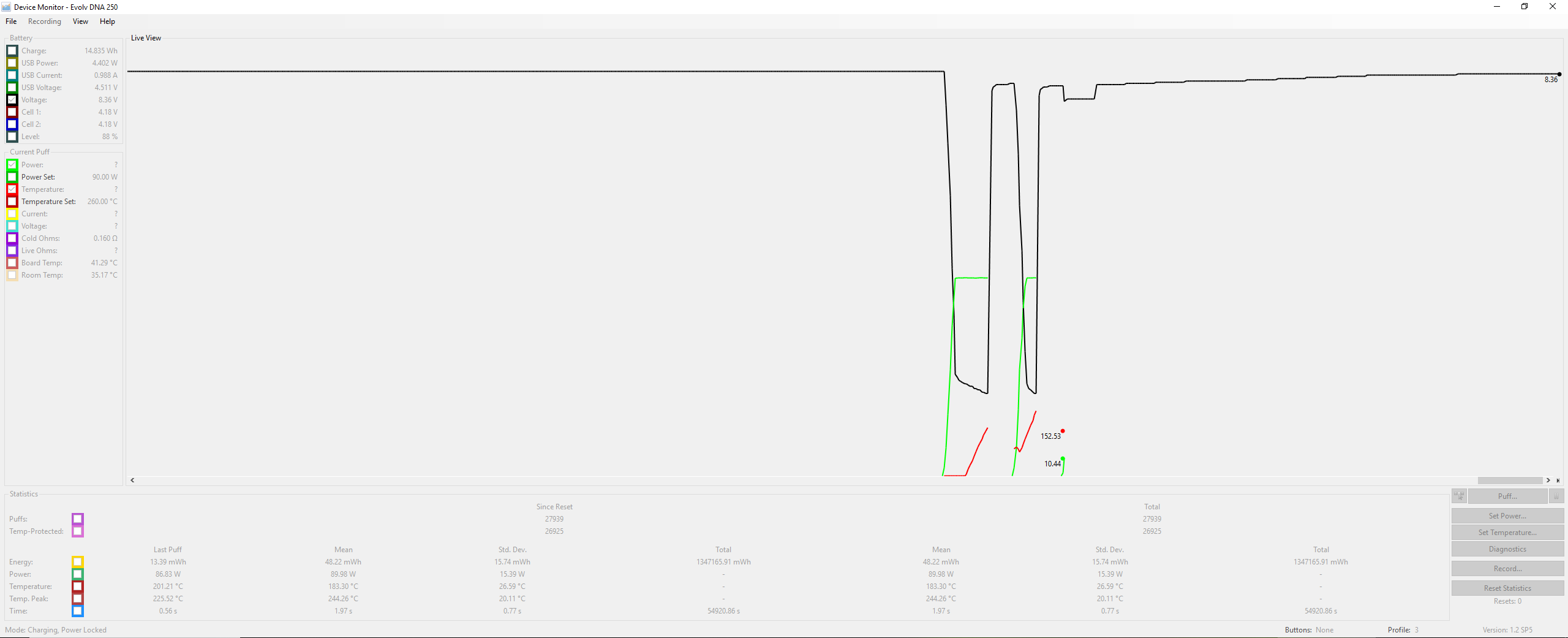

Snowpup Posted August 18, 2018 Report Posted August 18, 2018 Hello all, so I'm having a weird issue. The mod is annoyingly failing to preheat properly with a new set of Panasonic NCR18650B batteries. These batteries were charged to full last night. Escribe is properly seeing the voltage at around 8.3V. The voltage only dips to around 5V when firing. How can I go about fixing this up?
Wayneo Posted August 18, 2018 Report Posted August 18, 2018 34 minutes ago, Snowpup said: How can I go about fixing this up? Holy Jesus man. Buy some new batteries. I'd suggest something off the Mooch recommended list, along with buying from a reputable seller on his list if you can. That sag (black line) says they're old, or of very low amperage, among other things.

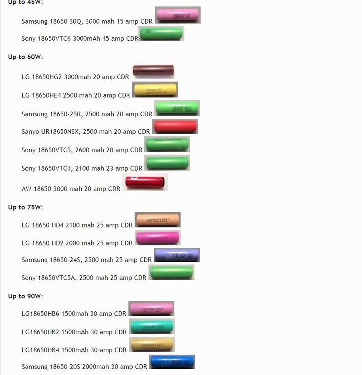

dwcraig1 Posted August 18, 2018 Report Posted August 18, 2018 These batteries are great batteries but only when used in an application where a 4 - 5 amp battery is required, flashlight, laptop pack ect. Roughly good for 15 watts per cell.
