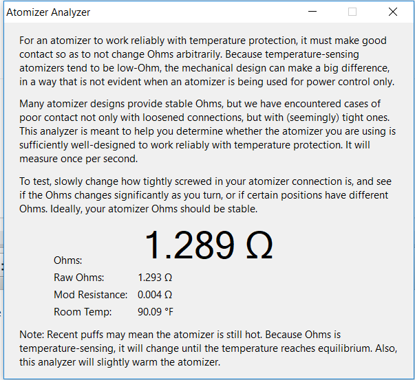

retird Posted July 31, 2018 Report Posted July 31, 2018 Was the atty warm from use when you put it on the device and told it was new coil? You might try building a new coil.... put it in a cool atty that hasn't just been used..... put on device and run Analyzer then fire....when asked select New Coil..... vape a bit.... what are your results???

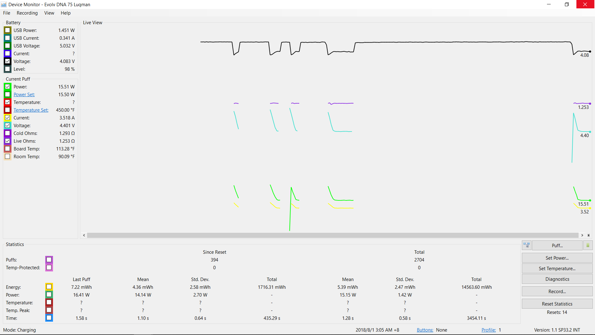

lukeskywalker Posted August 1, 2018 Author Report Posted August 1, 2018 Here details while firing and the profile

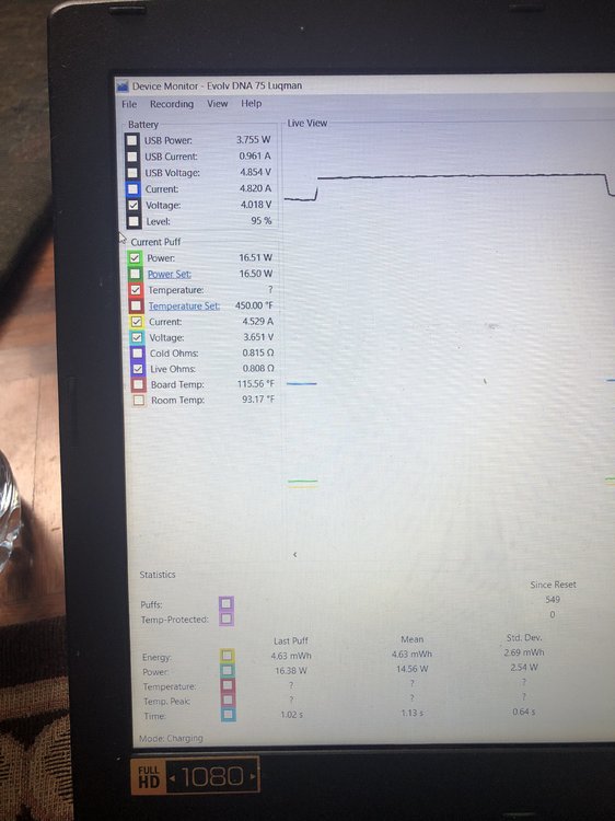

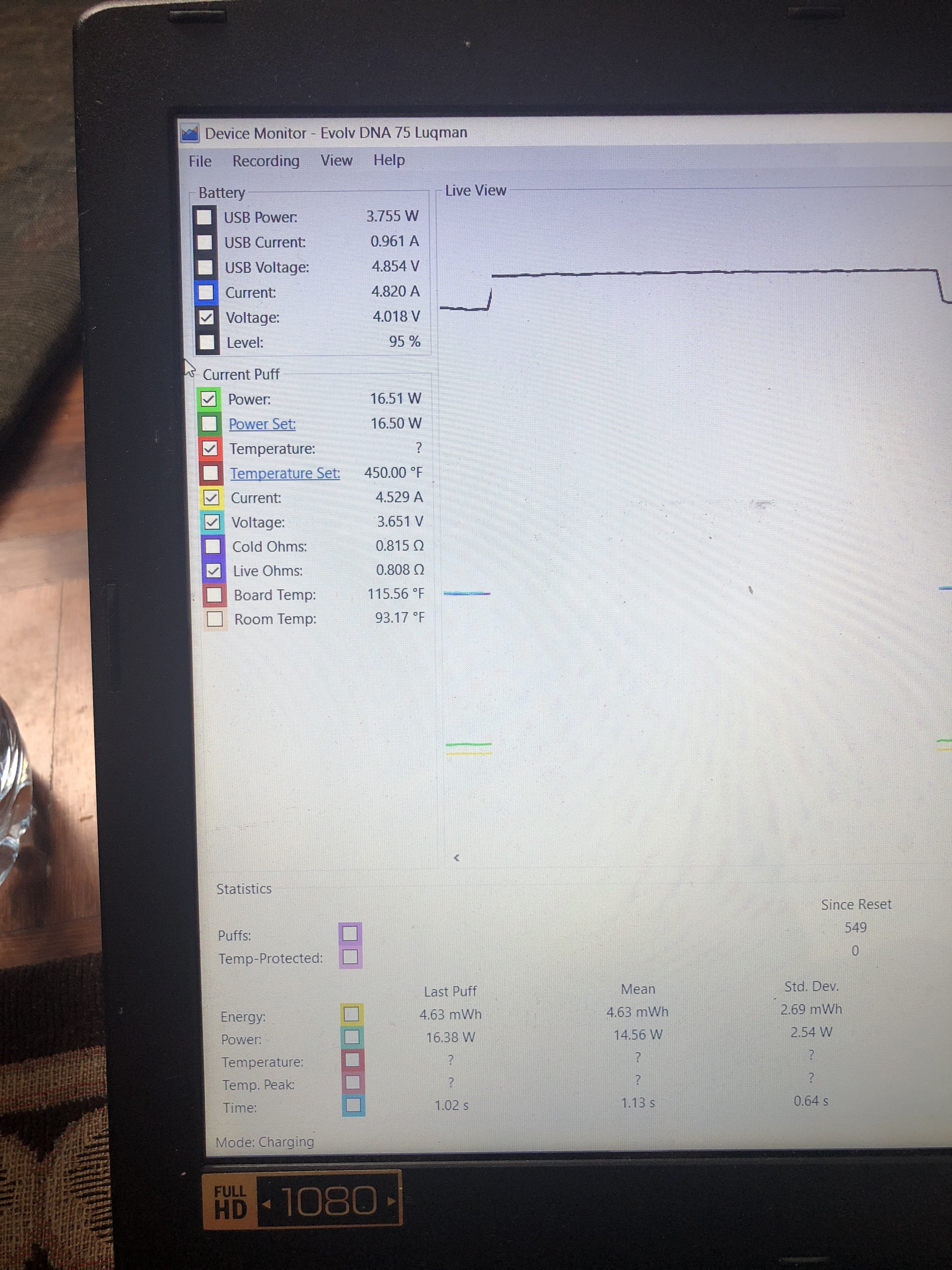

retird Posted August 1, 2018 Report Posted August 1, 2018 This just could be that you are seeing Cold ohms from Atty Analyzer whereby when using atty analyzer it slightly warmed the atomizer giving the Cold ohms. In use it reads live ohms thus the drop.... I had to dig up a Kanthal coil to see how it reacts as I seldom use Kanthal. My Kanthal coils show the same thing.... Here is my screenshot using a DNA250C device with a pre-made coil head rated at 0.60 ohms........
lukeskywalker Posted August 1, 2018 Author Report Posted August 1, 2018 So there is nothing to worry ya. I think maybe its because of theme used. And also whenever i check the atomic analyzer. The value doesnt stop. It changing and changing. Thats my concern
retird Posted August 1, 2018 Report Posted August 1, 2018 Good.... yep the longer you run the analyzer the numbers will climb because the analyzer slightly heats the atty.... glad we got to the bottom of your concern...
