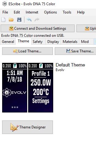

Porcelainbus Posted July 7, 2018 Report Share Posted July 7, 2018 Hey guys Firstly, total DNA/escribe noob here so bear with me pls.. I just got myself a Mirage dna75c (lovely rose wood model) and first thing I notice is it doesn't have a 'WATT" mode, is this normal? The modes listed are (in order) REPLAY, Nickel200, Kanthal, Nichrome, NiFethal30, SS430, SS316 and Titanium Also is it supposed to have Lost Vape firmware and/or Theme on it? I went in on escribe and it has the default Evolv Theme and when I go to Lost Vape website to look for firmware there is a file labeled "...TherionParanormal-.." ( not Mirage) on the Mirage firmware link which is only adding to my confusion. Pls advise if somethings amiss or everything is as it should be? Thanks Link to comment Share on other sites More sharing options...

Porcelainbus Posted July 7, 2018 Author Report Share Posted July 7, 2018 Ok after hours of digging I guess I found the answer buried in a facebook post. Link to comment Share on other sites More sharing options...
TonyB Posted July 10, 2018 Report Share Posted July 10, 2018 Just got the same mod. As you have discovered its only loaded with the Stock Evolv Theme and its missing so much. If you can get your brain round it I recommend creating your own or downloading one of the more recent Themes (with Replay) from the Themes Topic on the forum. You can rename any of the Profiles and change how they work and with which ever wire you choose. Rename the Nichrome as Watts for example. Link to comment Share on other sites More sharing options...
