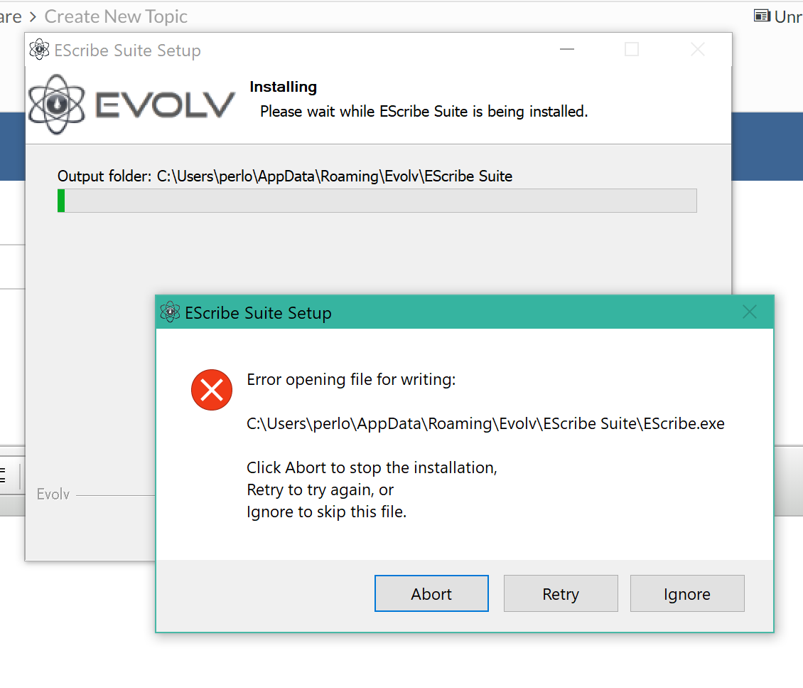

jperlow Posted July 5, 2018 Report Posted July 5, 2018 This is occurring on Windows 10 Build 17692 (Insider Preview, Active/Slow ring. Previous version of escribe installed and ran fine. Same issue with the international version.
jperlow Posted July 5, 2018 Author Report Posted July 5, 2018 I am able to resolve this issue if I use 7-zip to manually unpack the installation file to a directory and run the app directly from there. So this appears to be the executable for the installer.
HPloco Posted July 6, 2018 Report Posted July 6, 2018 This error is very common if you have anti-ransomware enabled. Either disable anti-ransomware or create a rule to allow the installer to bypass the anti-ransomware protection
jperlow Posted July 6, 2018 Author Report Posted July 6, 2018 There is no 3rd-party antimalware on this system. It's Windows 10, 17692. It's very possible that the OS has new antimalware capabilities in Windows Defender, but this is pretty much stock Windows 10, with that Insider build level. It's also possible this issue was brought up in earlier builds but I haven't touched escribe in a long time. https://blogs.windows.com/windowsexperience/2018/06/14/announcing-windows-10-insider-preview-build-17692/
retird Posted July 7, 2018 Report Posted July 7, 2018 Thats' a Windows 10 Insider Preview Build 17692 isn't it???
v_lestat Posted July 7, 2018 Report Posted July 7, 2018 (edited) you need to right click the installer and tell it to run as admin regardless if you are an admin on the machine or not, "run as administrator" puts you to an even higher security level on windows computers. this is actually a very common type of error when installing programs in window 10. if that doesn't work then you jneed to just install it to C:\Escribe, stop using Evolv's ridiculous roaming profile location. part of the problem and I for the life of me cant understand why Evolv is doing it, is the installer is unpacking into a roaming profile folder. it should be unpacked into the c\windows\temp or %temp% which is the specific local user temp directory. roaming is rarely used for normal windows programs though not truly uncommon, and if you are on a domain currently (you are doing this from work or your .local home domain) then log in with your local profile and try it. escribe should NEVER EVER be installed as a program in the roaming profile folder, that is not what its there for. and the security placed ont he roaming profile folder is different than the local profile folder. Edited July 7, 2018 by v_lestat
