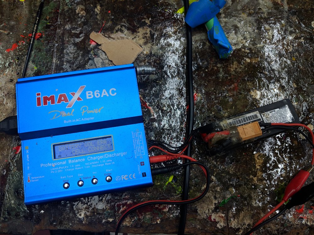

I'm to the point in my build all electrical connections are made so I hooked it up to escribe to take a look and upload my theme.
It was plugged in for over an hour while I was doing other stuff but the battery still showed 0% charge so I took the battery to the charger.  But the charger is giving me an error of low charge and/or balance error.  I know there's an easy fix, just don't recall.  Hope you can remind me please...
The battery is Turnigy Graphene 2200mAh 4S from HobbyKing
Link to comment
Share on other sites
So it looks like the fix was to change the battery type so it would take some amount of charge.  Then change it back to Li-Po and balance charge has started.  That was and hour ago and it says it's taken 1700 so far.
Looking good.  We'll see when it goes back on the device.  Clock was fixed by leaving it unplugged and using a good battery.
