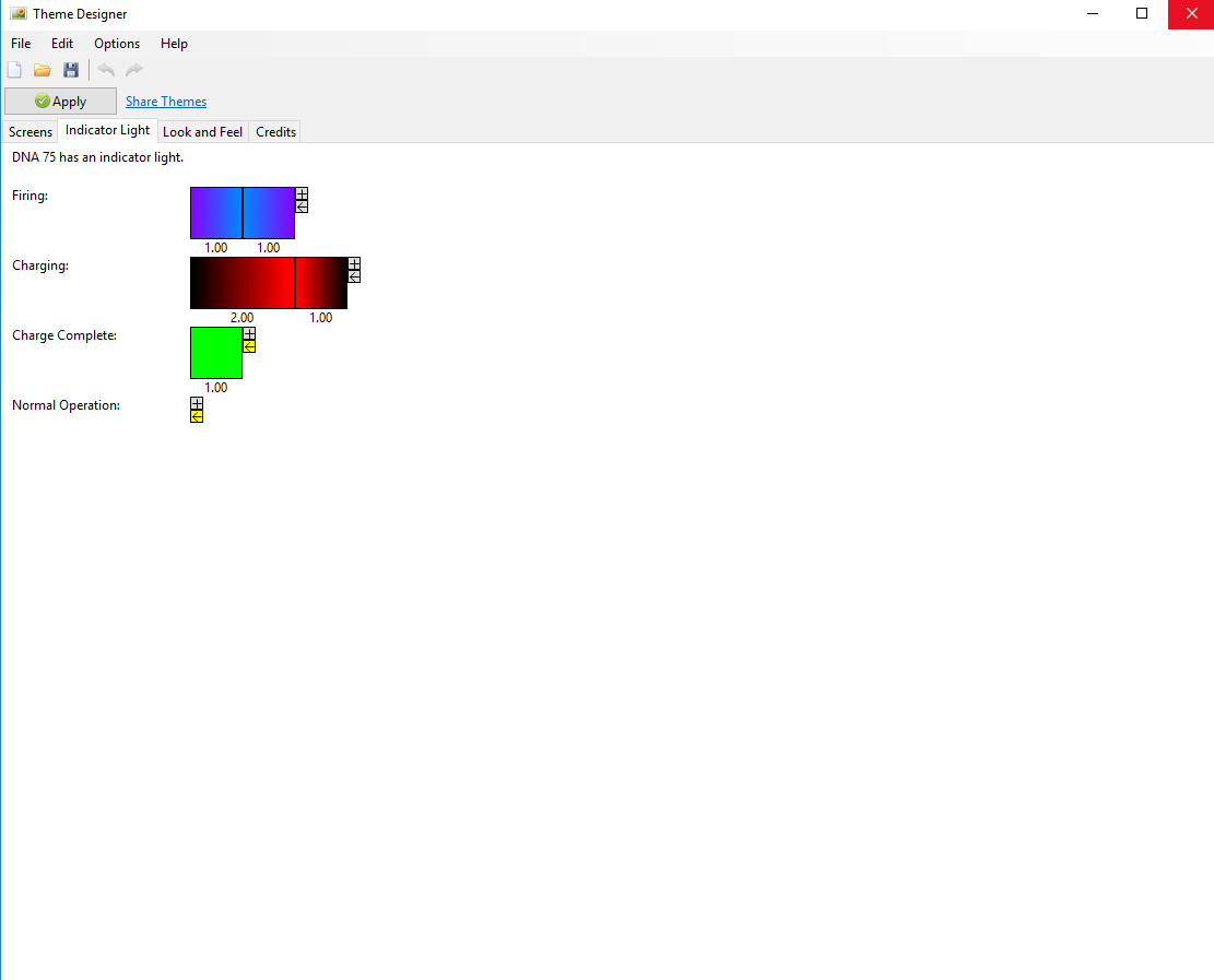

Achilz Posted May 27, 2018 Report Posted May 27, 2018 Hi...im new user for vt75 dna chip... My question is why my mod dont have a led indicator when im using..but if i charging the led turn on into red..but if i pull out the usb the led will turn off..i see the review in youtube the vt75 dna chip have led light at fire button...but i dont have the led on my vt75 dna chip
dwcraig1 Posted May 27, 2018 Report Posted May 27, 2018 The LED for the fire button can be "adjusted" in Theme Designer/ Indicator Light tab on the DNA75.
retird Posted May 27, 2018 Report Posted May 27, 2018 You can see how the LED is set up on your device by going into Theme Designer in EScribe ..
