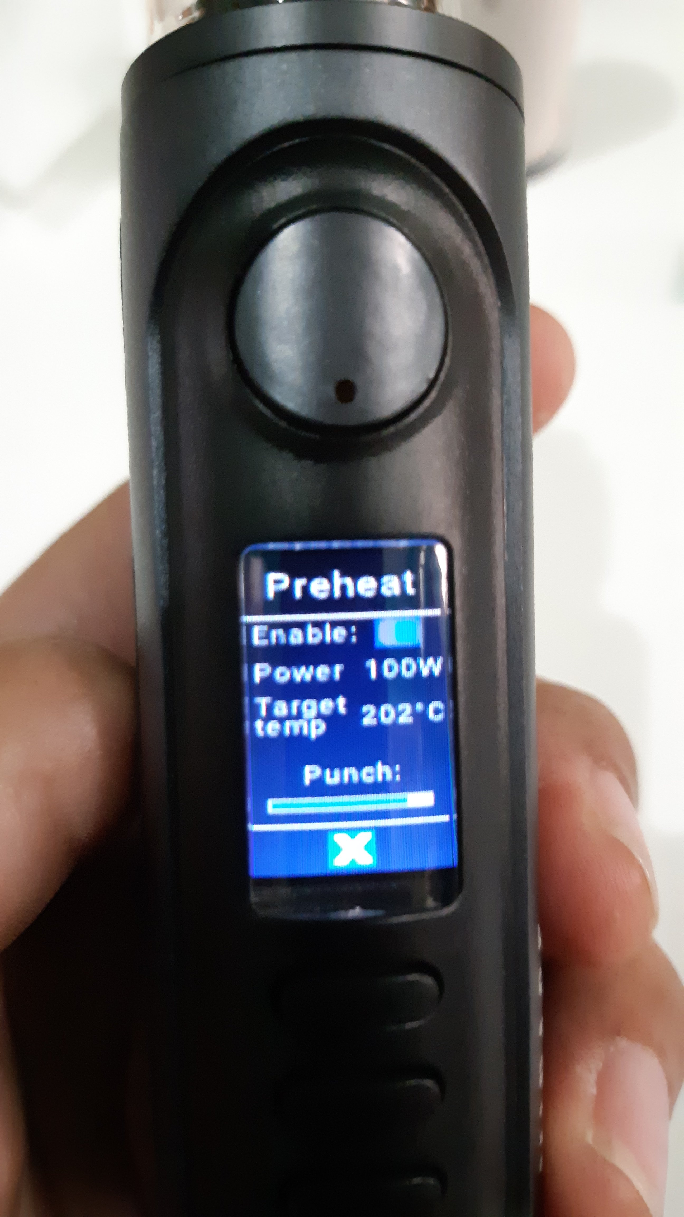

On 5/16/2018 at 12:25 AM, CBR954DMC said:
I have Escribe and cant tell you how many times ive tried to get this vape to have an output of 100watts and Still i can ONLY get it to go to 75watts!!!! What am i doing wrong?!
That is preheat menu with 100watt at starting puff. Cmiiw.
