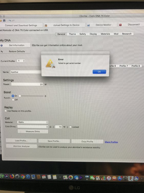

Mark82 Posted May 10, 2018 Report Share Posted May 10, 2018 (edited) Need some help guys! Just tried installing a theme on my DNA75c mod and the upload failed, now the screen on the mod has a white background with the red letters "upload settings" whenever I try and reconnect my device to Escribe I get the error "Can't figure out device version"... I can't be the only person who has had this issue.. I did a quick search on the evolv forums and had no luck... can anyone here help me? EDIT : I try to click restore defaults or get information I get this.. Edited May 10, 2018 by Mark82 to give more information about my issue. Link to comment Share on other sites More sharing options...

retird Posted May 10, 2018 Report Share Posted May 10, 2018 Try connecting device and do a Soft and/or Hard Reboot.... then unhook USB and start the Theme you are installing... plug usb back in and see if it is recognized and you can upload the theme.... Link to comment Share on other sites More sharing options...
Mark82 Posted May 10, 2018 Author Report Share Posted May 10, 2018 5 minutes ago, retird said: Try connecting device and do a Soft and/or Hard Reboot.... then unhook USB and start the Theme you are installing... plug usb back in and see if it is recognized and you can upload the theme.... Soft reboot: got the message command was given, did not work Hard reboot: got message "failed to issue hard reboot command" No luck Link to comment Share on other sites More sharing options...
retird Posted May 10, 2018 Report Share Posted May 10, 2018 Can you try getting a bachup installed? In Escribe Go to Help/Backups.... select backup you want and see if it will upload... Link to comment Share on other sites More sharing options...
Mark82 Posted May 10, 2018 Author Report Share Posted May 10, 2018 21 minutes ago, retird said: Can you try getting a bachup installed? In Escribe Go to Help/Backups.... select backup you want and see if it will upload... still getting "cannot figure out device version" error Link to comment Share on other sites More sharing options...
retird Posted May 10, 2018 Report Share Posted May 10, 2018 hum, maybe take out the batteries, let set for 10 minutes, reinstall batteries..... if still a no-go you might just fill out a ticket with Evolv and let them guide you.... here is the link.... https://helpdesk.evolvapor.com/index.php?a=add&category=1 Link to comment Share on other sites More sharing options...
Mark82 Posted May 10, 2018 Author Report Share Posted May 10, 2018 2 hours ago, retird said: Can you try getting a bachup installed? In Escribe Go to Help/Backups.... select backup you want and see if it will upload... still getting error, thanks for your time, submitted a ticket, hopefully someone comes up with something or evolv does in the next few days... anyone else have any ideas? Link to comment Share on other sites More sharing options...
Mark82 Posted May 11, 2018 Author Report Share Posted May 11, 2018 just restarted the computer and had the mod plugged in and it started re-installing default settings, it was done so I tried re installing the theme on there, got timeout error and it froze 12% into upload so now Im back to square 1 again :(. Link to comment Share on other sites More sharing options...
retird Posted May 11, 2018 Report Share Posted May 11, 2018 Which theme are you trying to install? Link to comment Share on other sites More sharing options...
Mark82 Posted May 11, 2018 Author Report Share Posted May 11, 2018 retird... i gave up on the Issue for awhile and just restarted my computer for a reason not related to this. Not remembering my device was still plugged in, ascribe opened right up upon restart and i saw it detected my device saying something about an incomplete install was found on the mod, i literally just hit ok a few times and for some reason it installed the default evolv theme. Seeing this, I assumed the restart fixed whatever issue I was having, I decided to put the modder's theme back on the device at least... It starts to upload and at 12% an error popped up that I lost connection with the mod and now I am just getting a white screen when i turn the mod on and when I connect It says t cannot figure out device version, and Im back to where I am at before no matter how many times I restart. So, 2 possible conclusions.. install of escribe is corrupt, or my micro usb cable is bad. Would that be correct to assume? Link to comment Share on other sites More sharing options...
retird Posted May 11, 2018 Report Share Posted May 11, 2018 You might try reinstalling EScribe and using a different usb cable.... Can you post the theme file here? Link to comment Share on other sites More sharing options...
