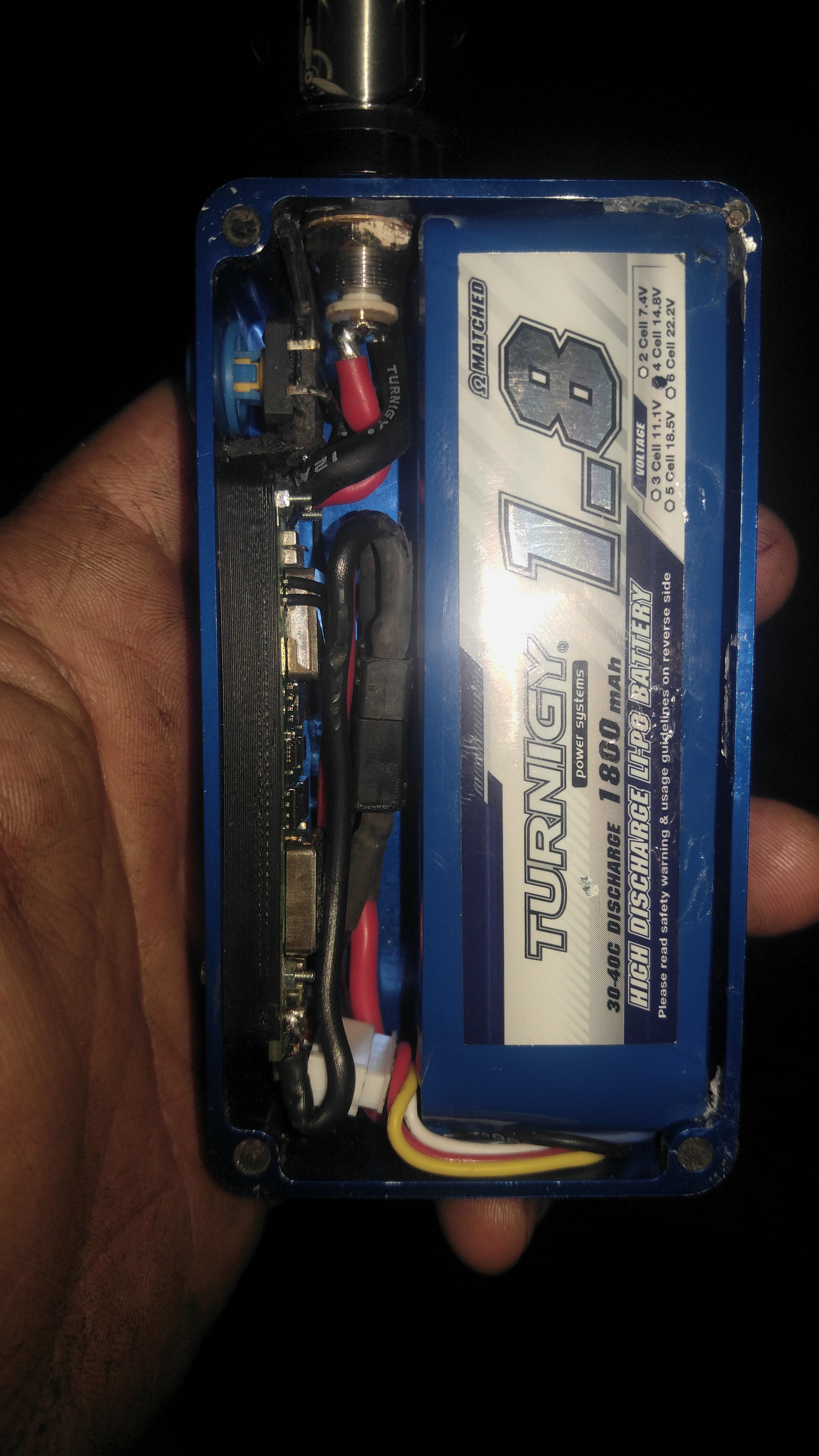

67exec Posted April 16, 2018 Report Posted April 16, 2018 (edited) I used that box, and battery, ati board holder with drill template, and some m1.6x12mm screws and nuts from the hardware store. Lots of guys glue their board holders, but that makes it super hard if the screen dies. I used a tactile switch that came in a 12 pack from the local hobby store, they were in the arduino stuff for $3.99. I ground out so it will hold 4s 1800. And I use dean's t- connectors since my rc stuff uses them. Also grabbed my board from ati Edited April 16, 2018 by 67exec

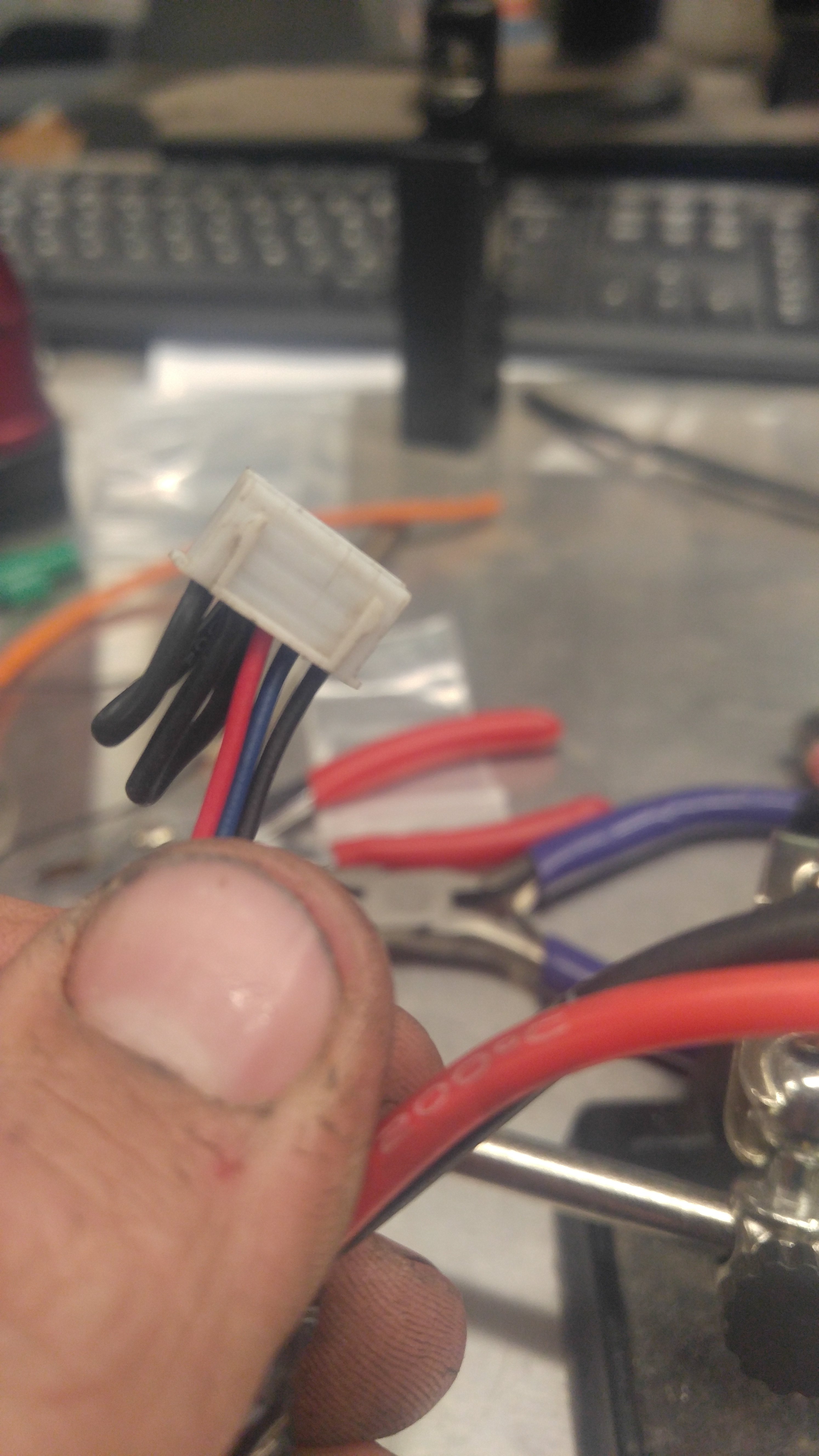

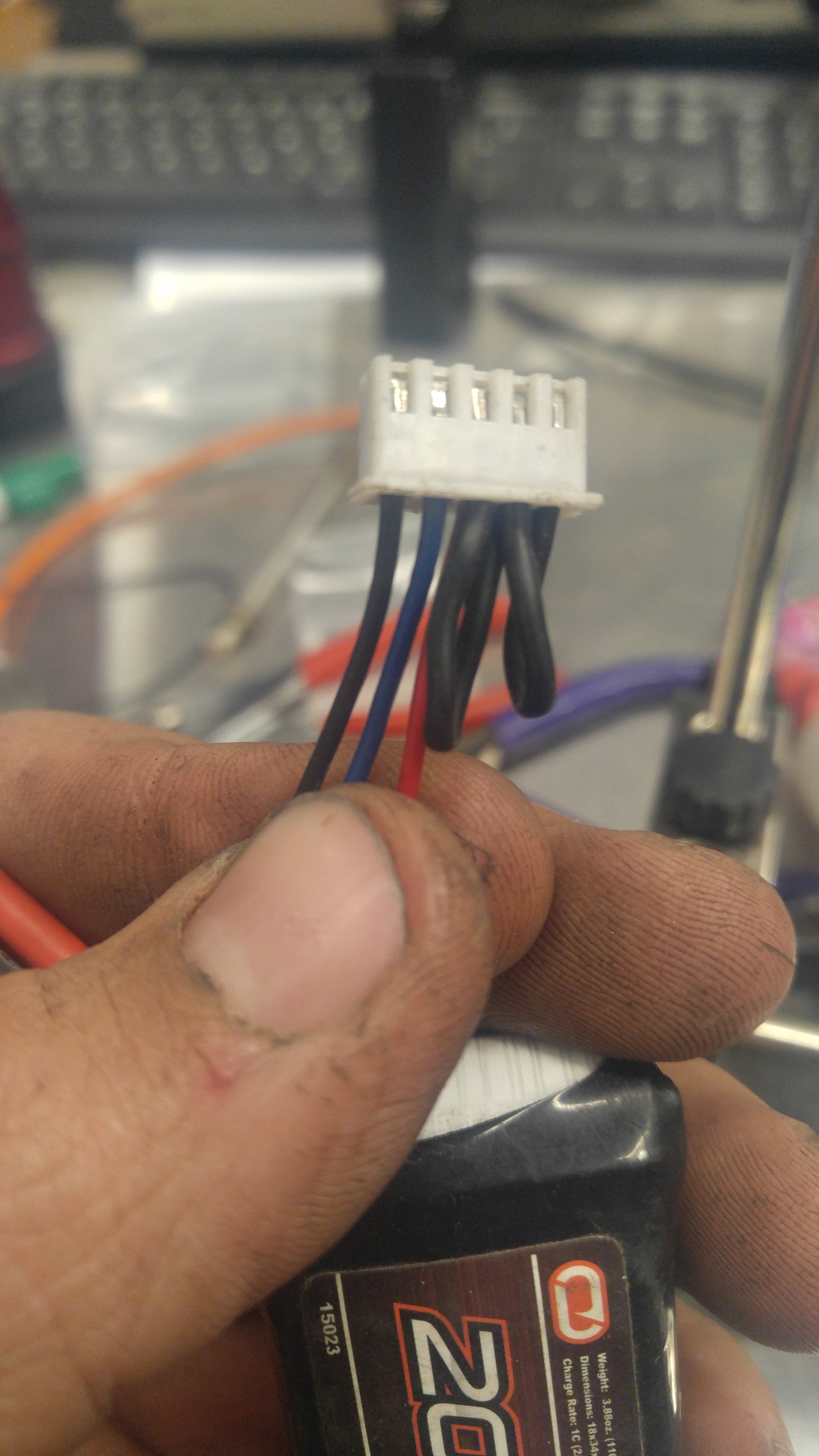

67exec Posted April 16, 2018 Report Posted April 16, 2018 (edited) The 250c won't work in that enclosure, and that Maxamps 2800 is closer to 1800mah, and voltage sag is terrible. Based on previous experience, the Maxamps will have 19wh-21wh total capacity vs a decent 4s 1600mah will be 22wh-24wh. If you are dead set on 3s, I would buy a 5pin jst connectorLike this. Then wire it like this except only jump pins 4 and 5 together instead of jumping 3 to 4, then 4 to 5 since I was using an old 2s batt I had laying around. Then if you do anything other than 4s, it Will show low battery until you set it as 2s or 3s with escribe. Edited April 16, 2018 by 67exec Added a photo 1

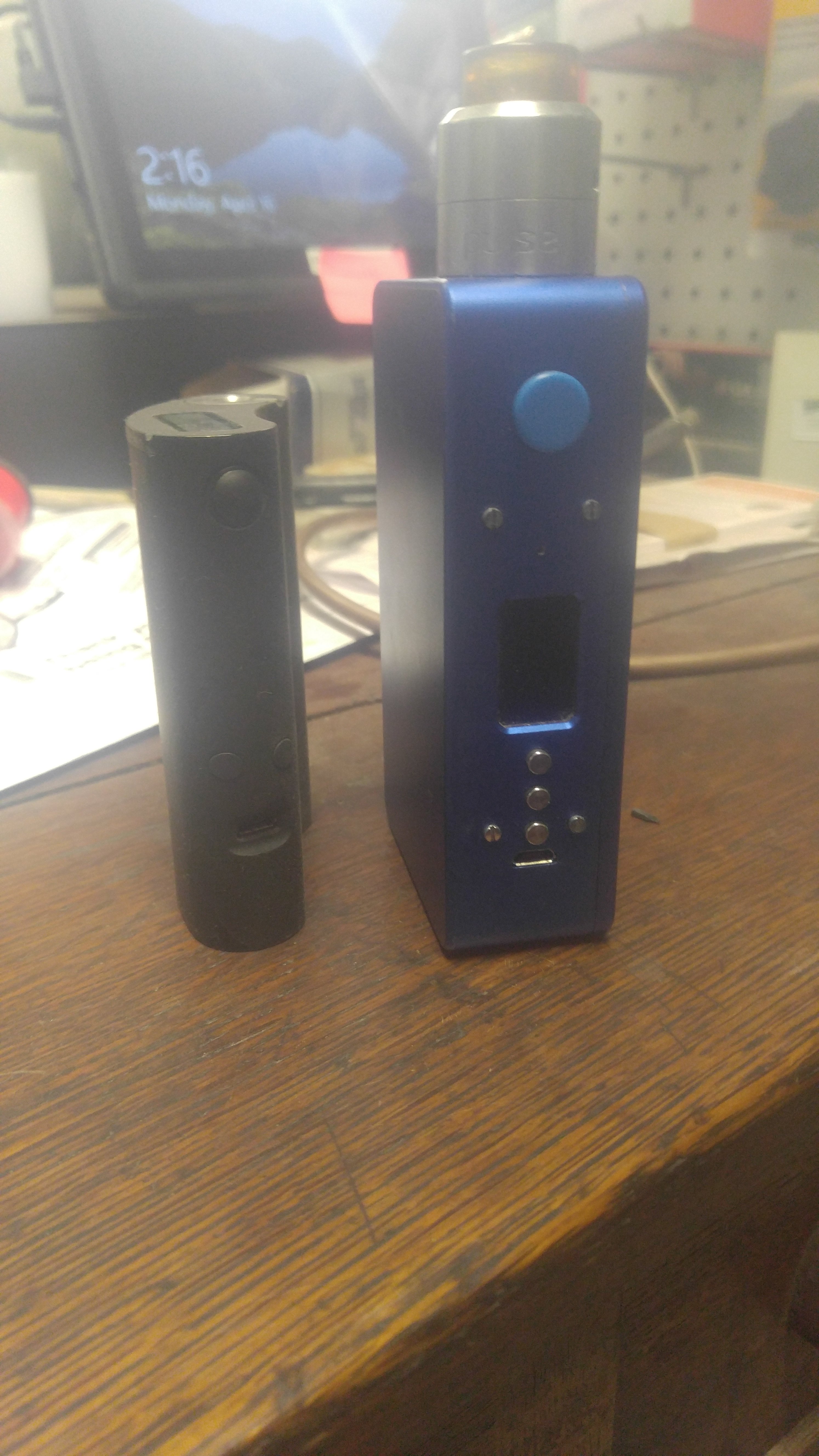

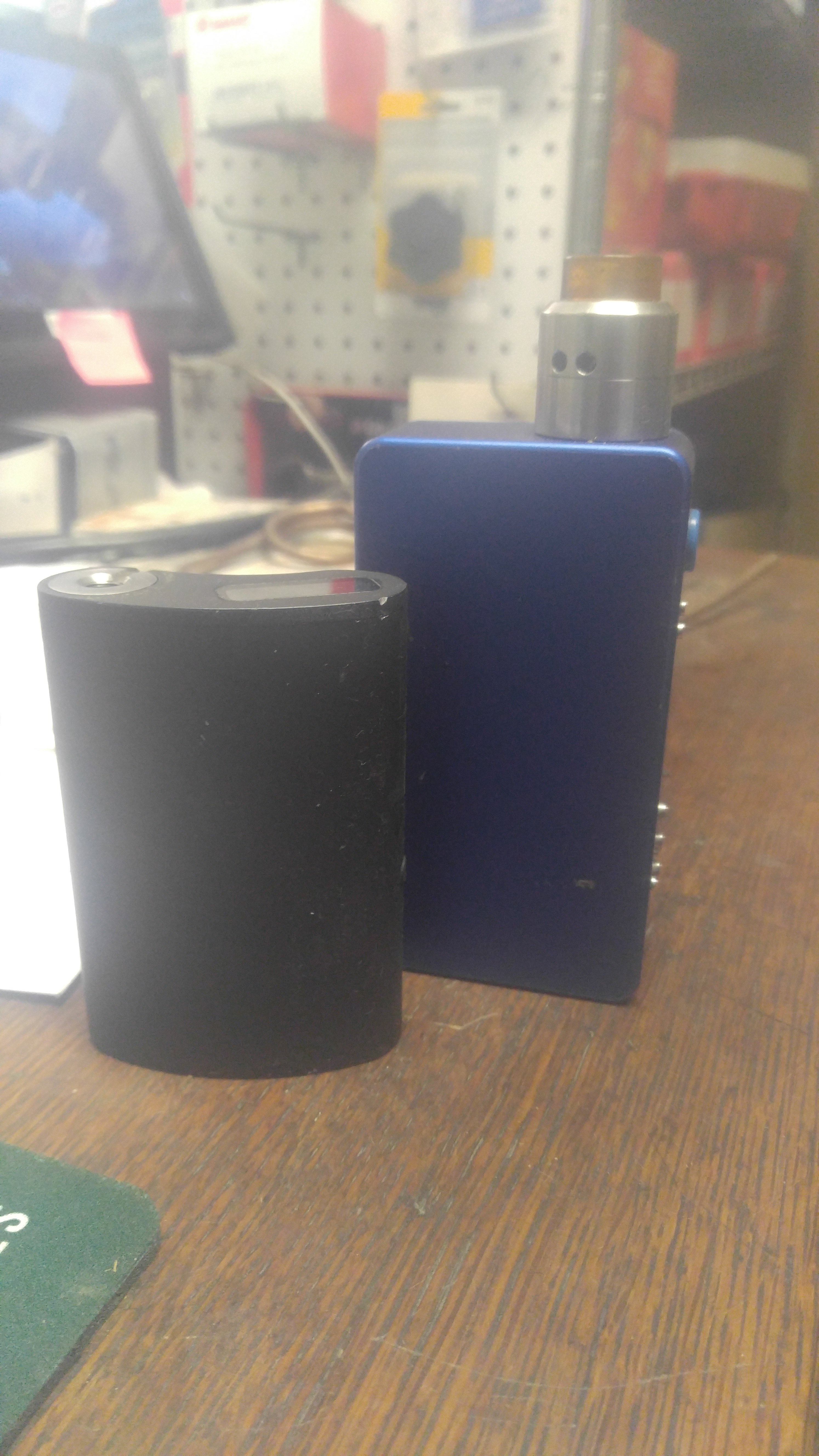

67exec Posted April 16, 2018 Report Posted April 16, 2018 N1 is a big box. Here's a b box vs a flask166
shroomalistic Posted April 16, 2018 Author Report Posted April 16, 2018 ooooohhh thats pretty. I like that. Ive got large hands so that should be perfect.

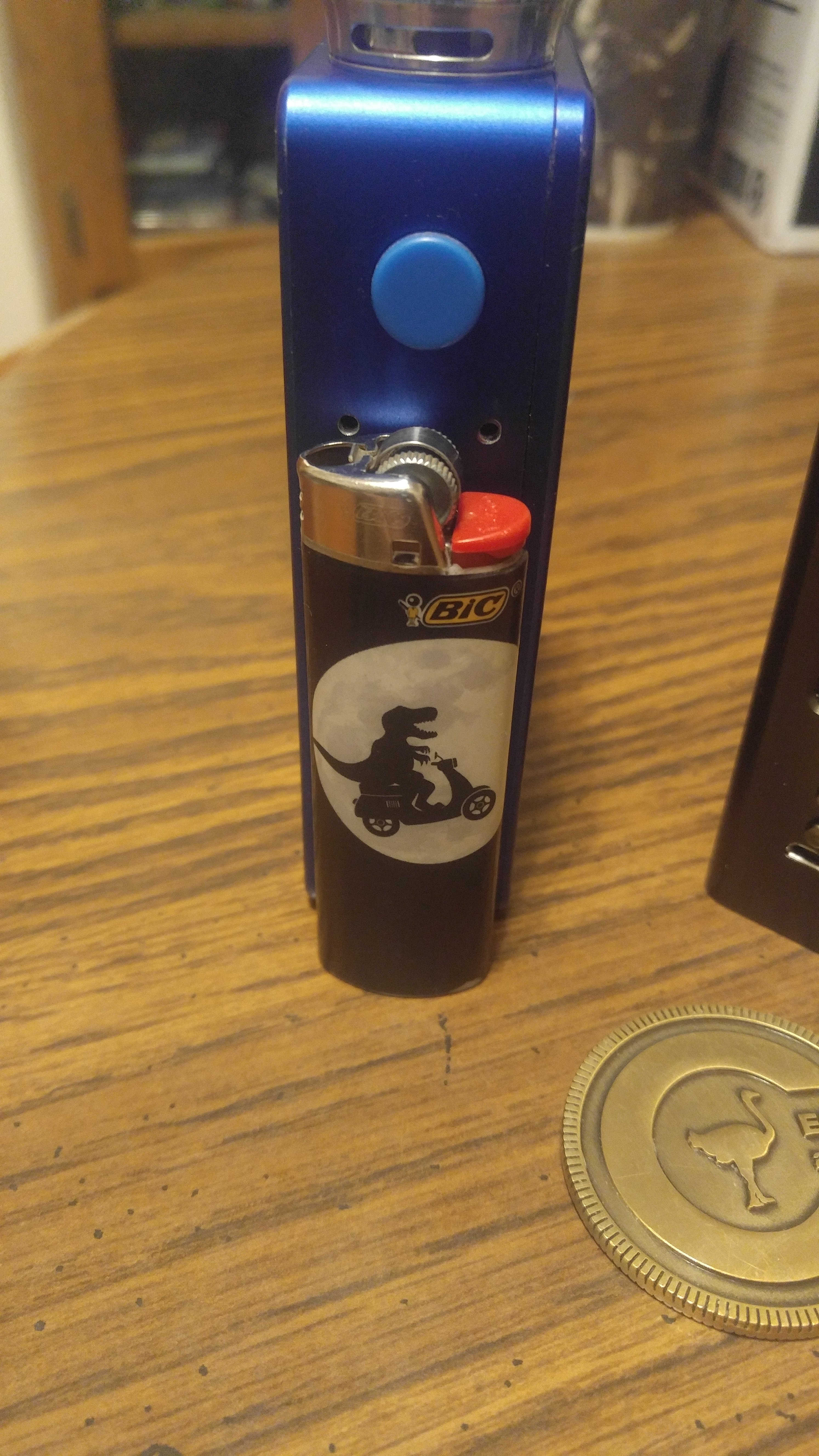

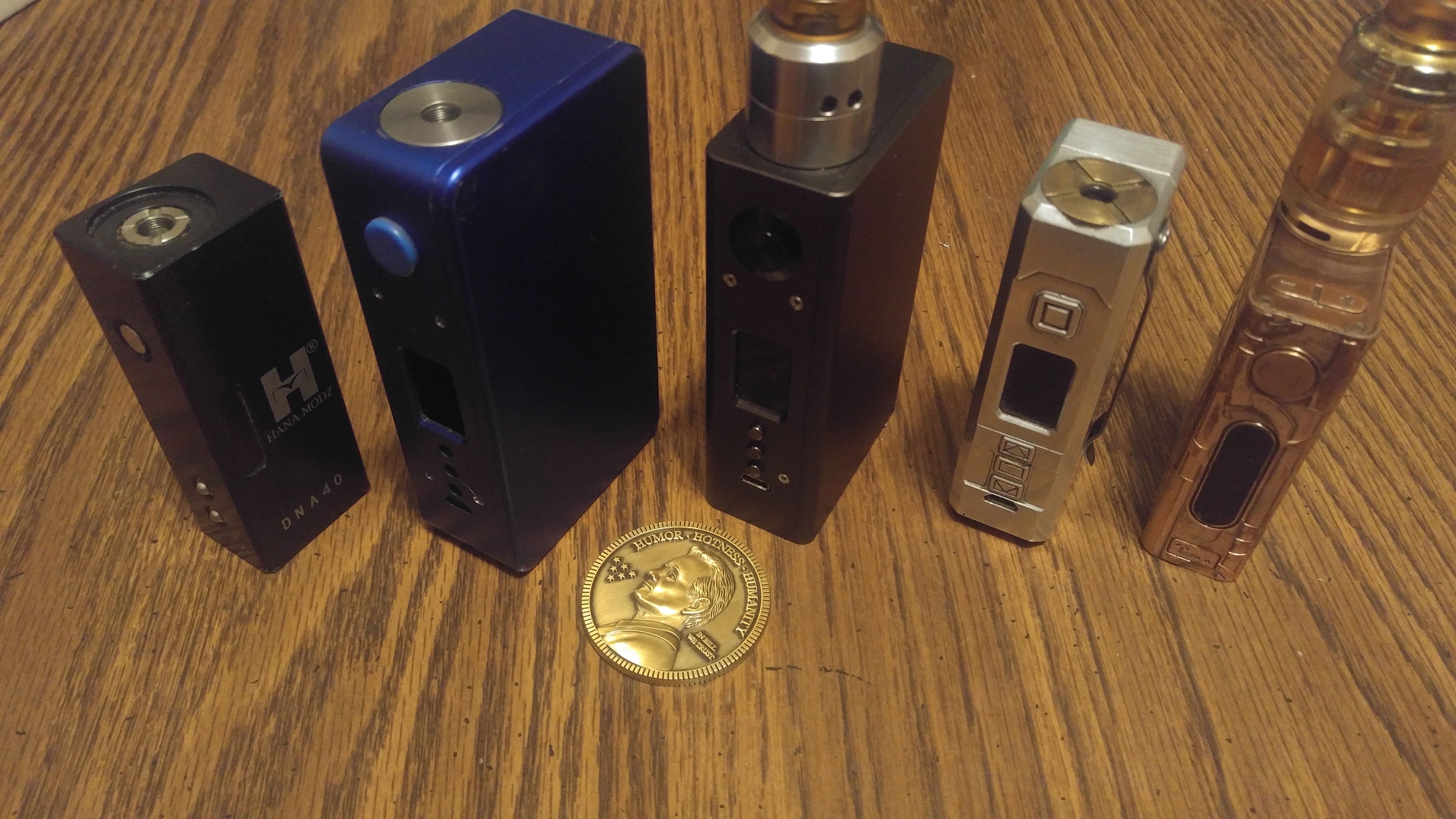

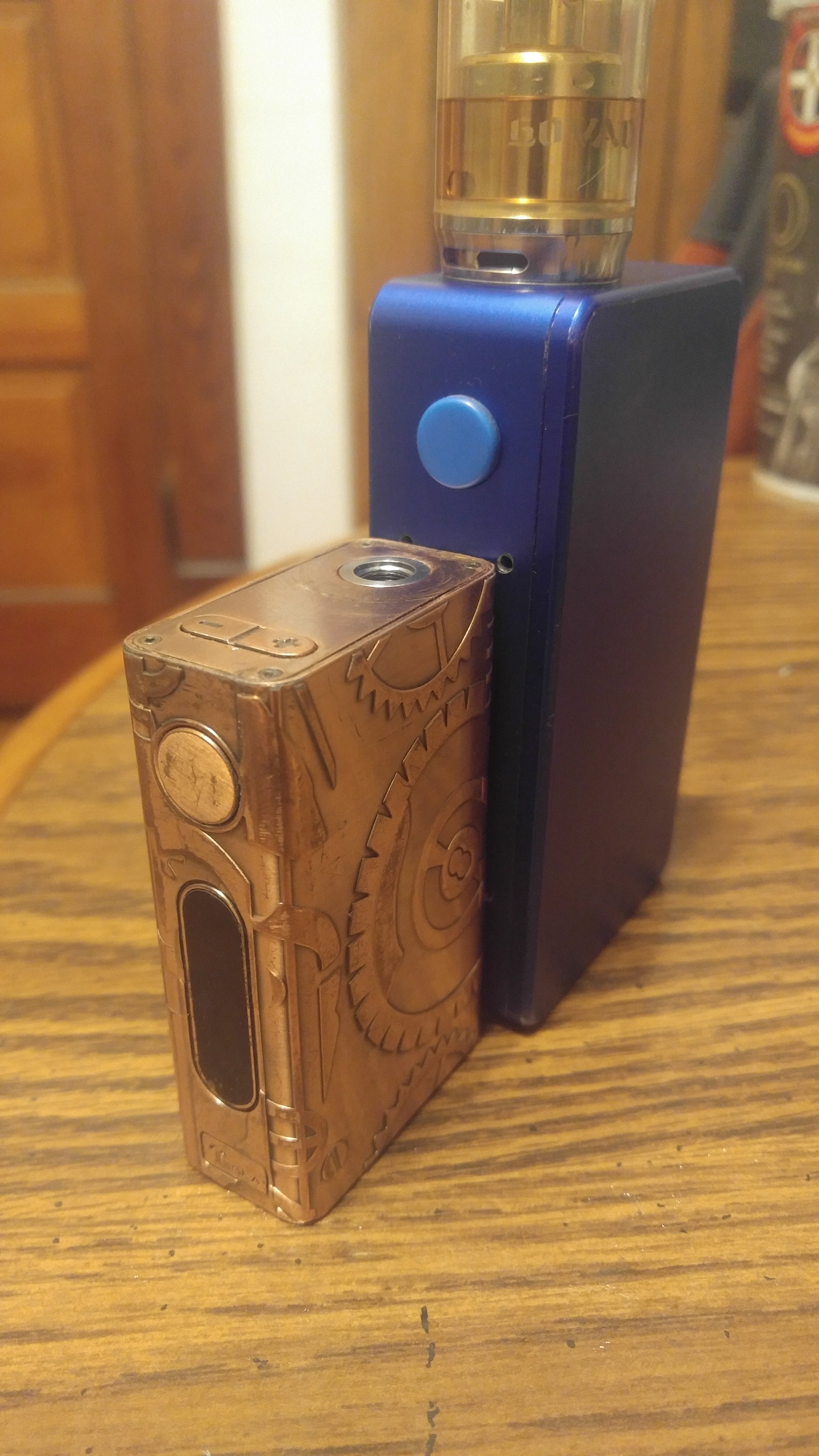

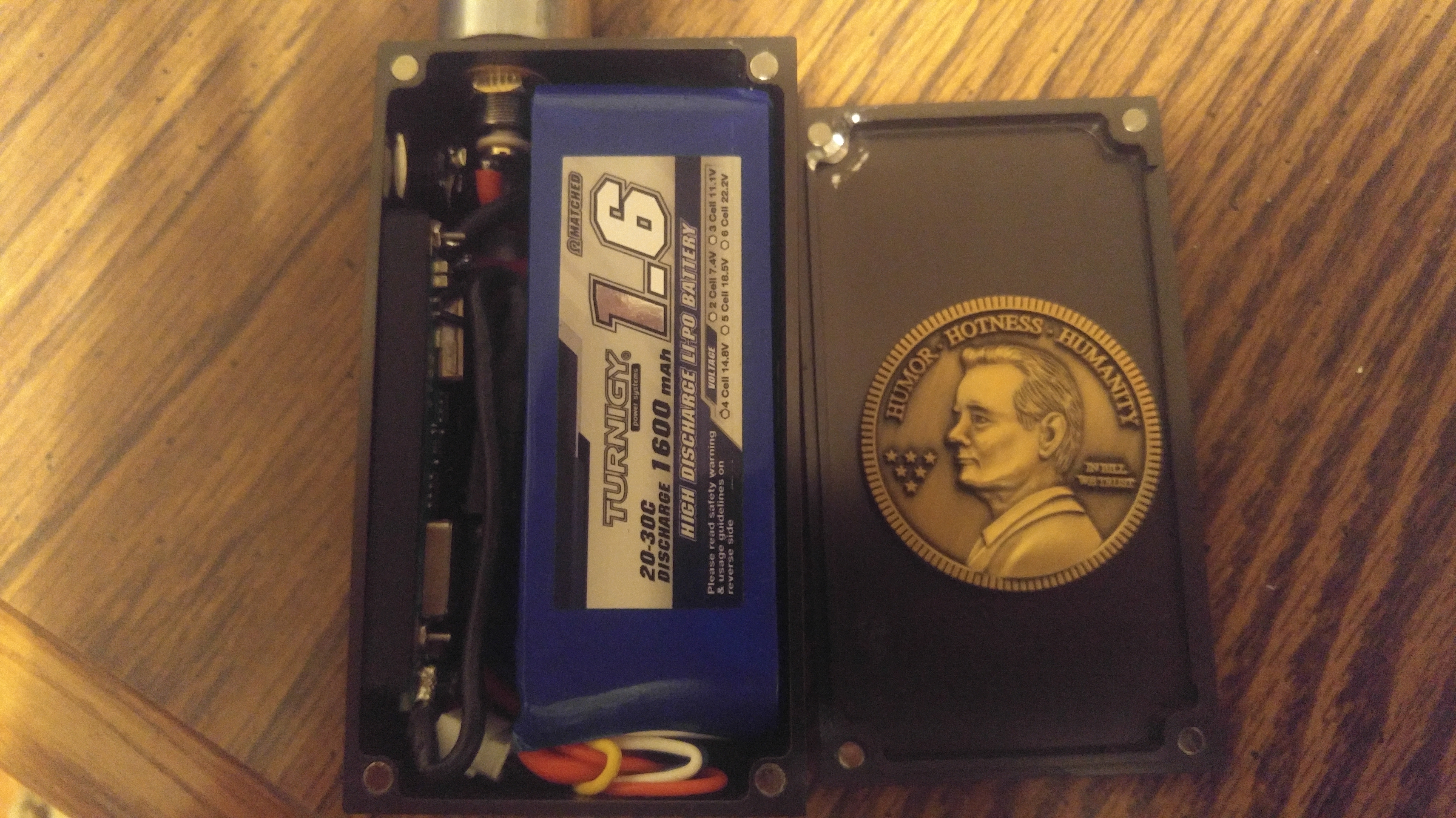

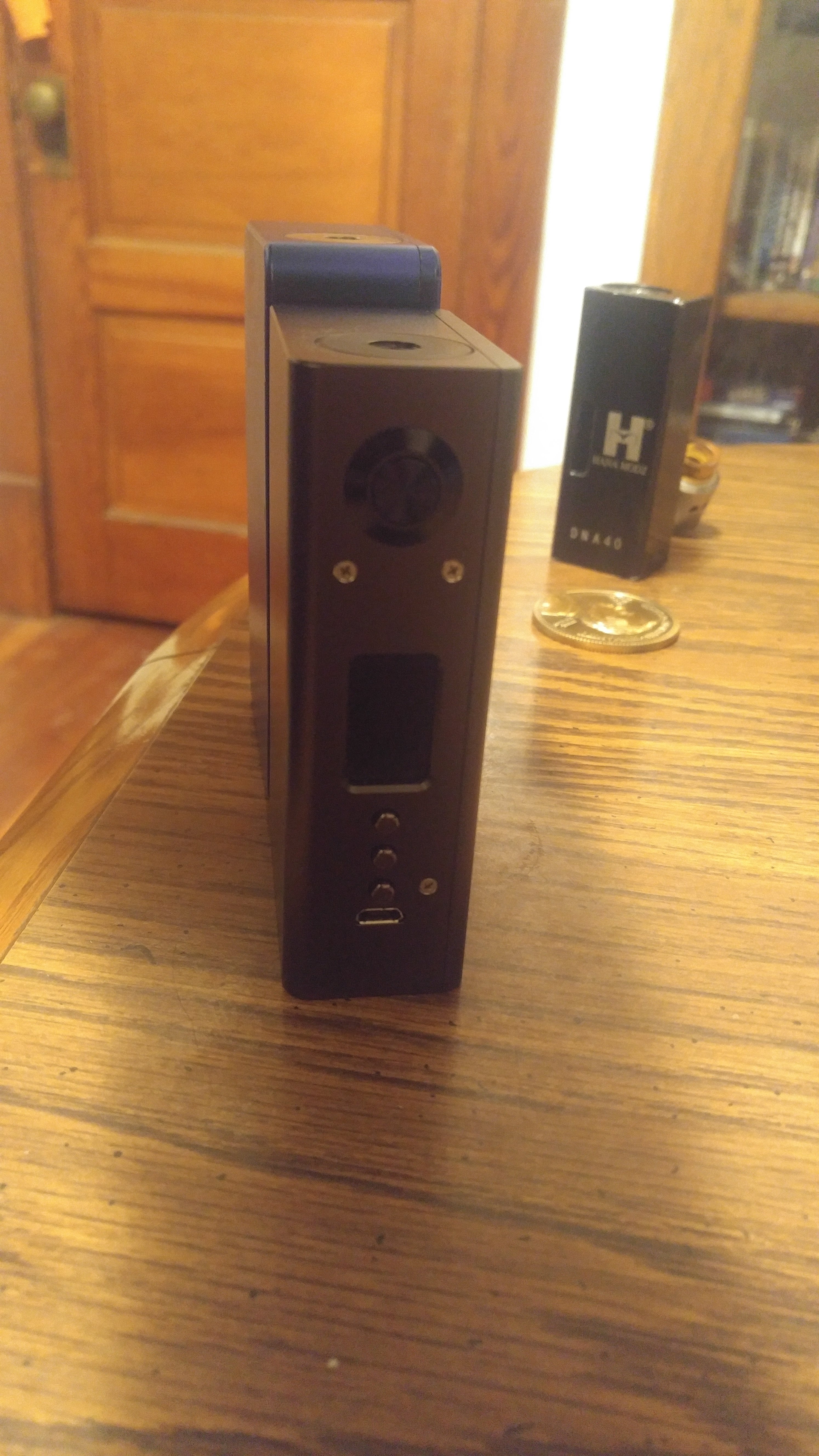

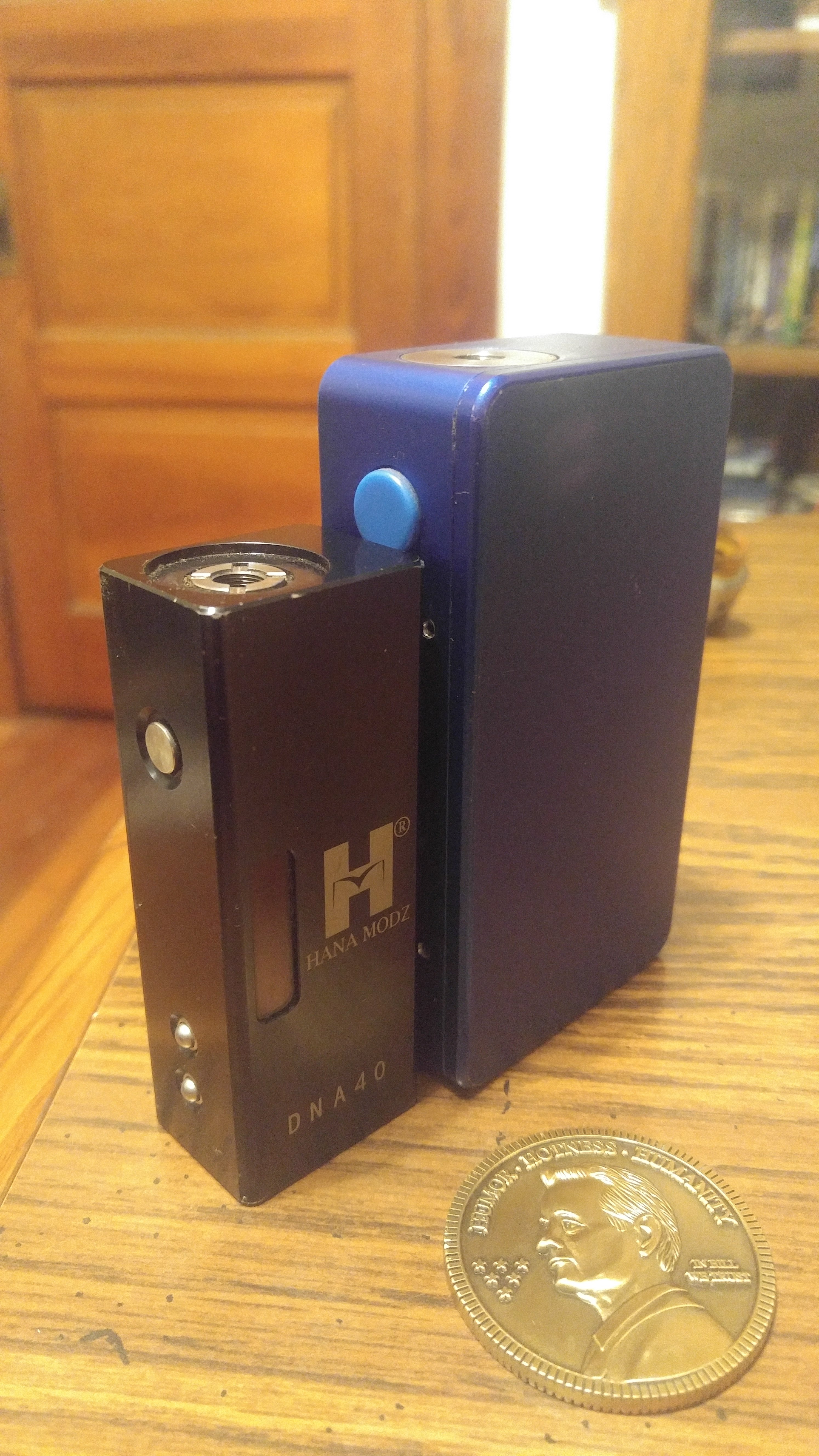

67exec Posted April 20, 2018 Report Posted April 20, 2018 (edited) Here are some references. Hana modz v4 dna 40, Silo 75c, Tesla steampunk nano 100w, ATI b box, and ATI gxl2, regular bic, and a 42mm challenge coin. Pulse 24 atty, and govad atty. Here is an n1 with a titan. Edited April 20, 2018 by 67exec Added a linky

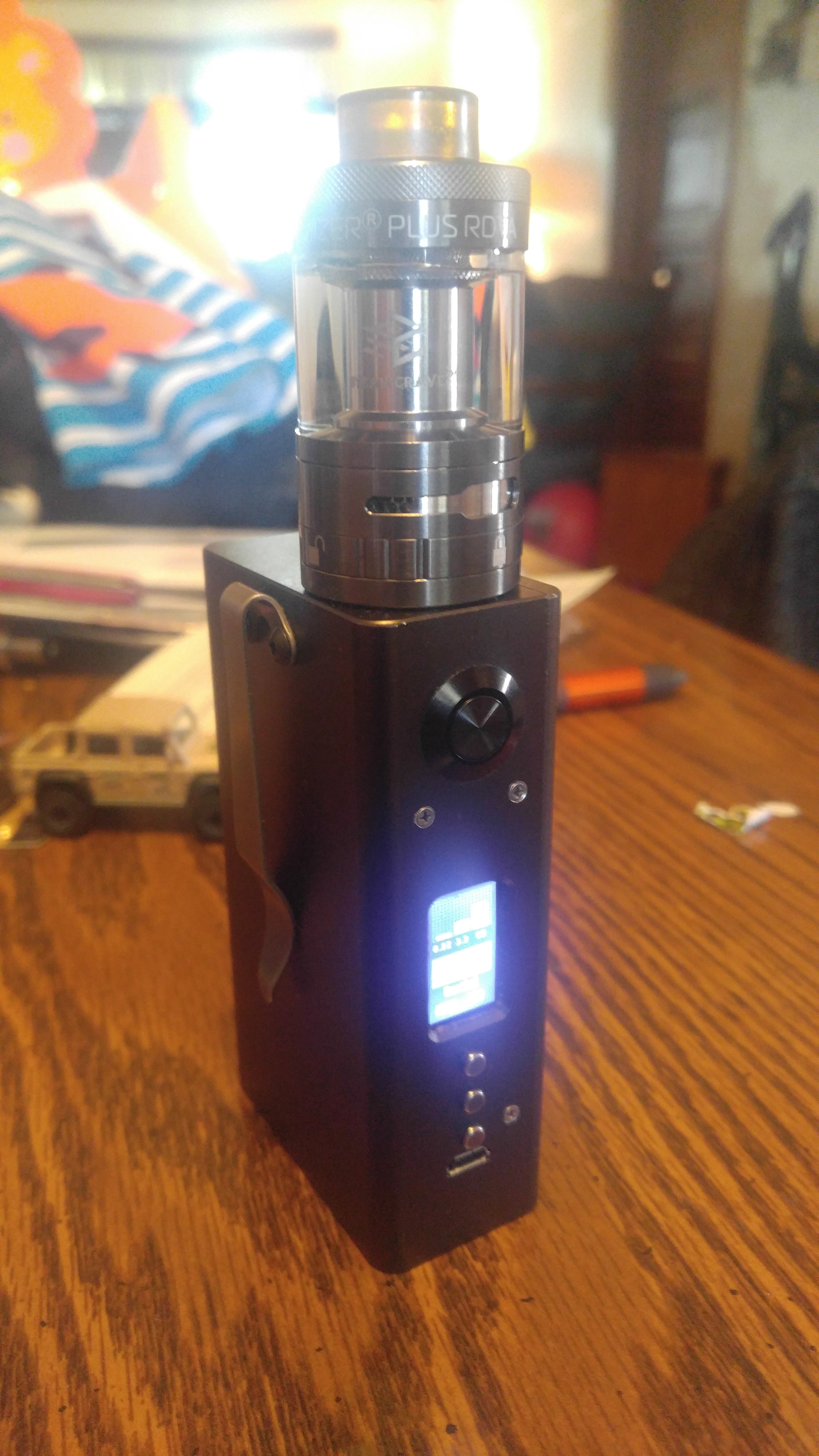

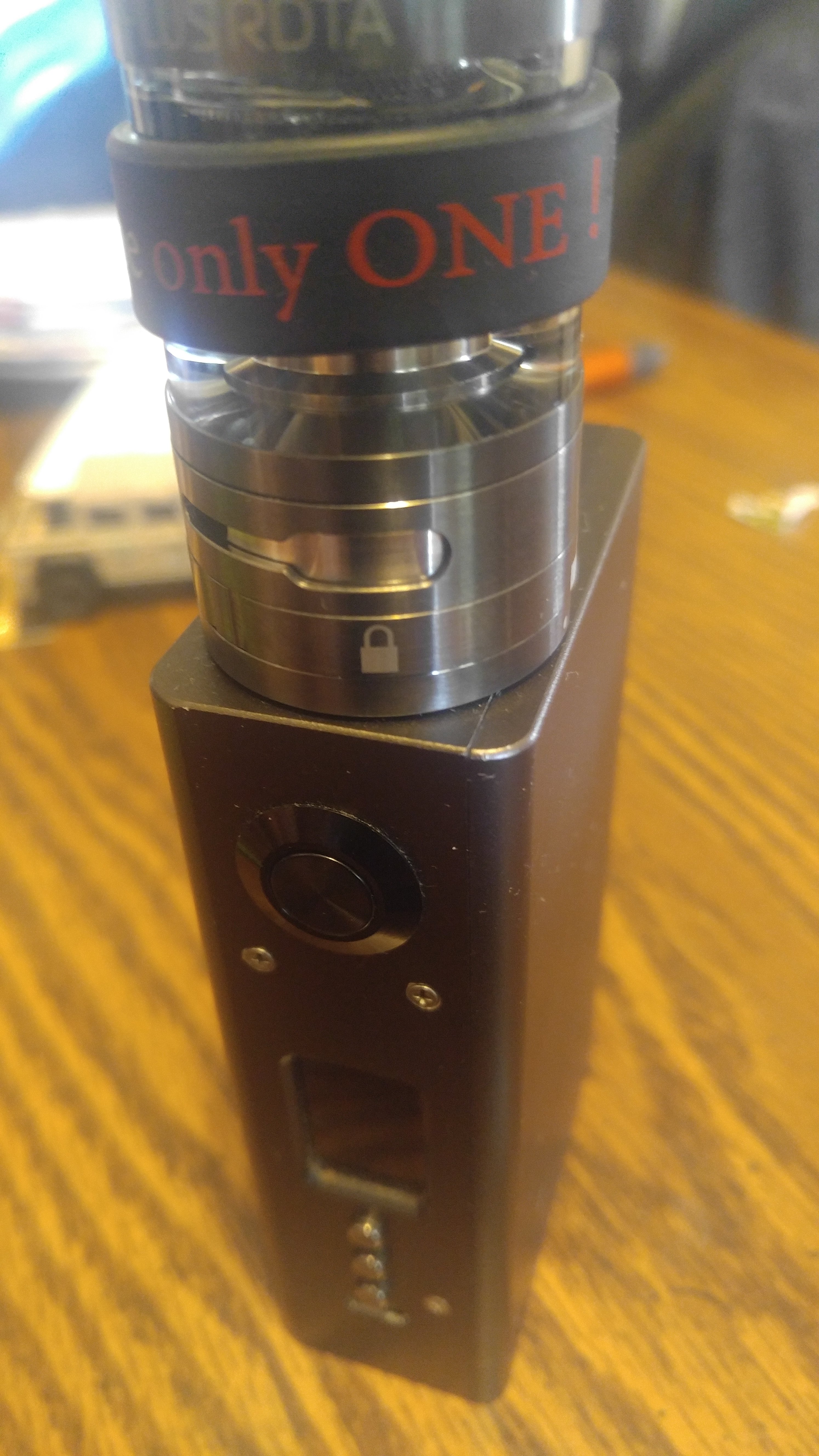

67exec Posted April 30, 2018 Report Posted April 30, 2018 Here is my gxl2 with the aromamizer plus on top 1
shroomalistic Posted April 30, 2018 Author Report Posted April 30, 2018 So I chose the red b box over the gxl2 just for little extra space inside. So far I have the 510, fire button and box. I have the Scottua clone and modfather clone on the way. Next check will be the board and holder and maybe the battery. When I go with an n1 box it’s gonna be an nlpwm with a voltrov. The gxl2 looks awesome but I couldn’t find it in red and after looking at build it seemed a little tight with the 1600 4s in their

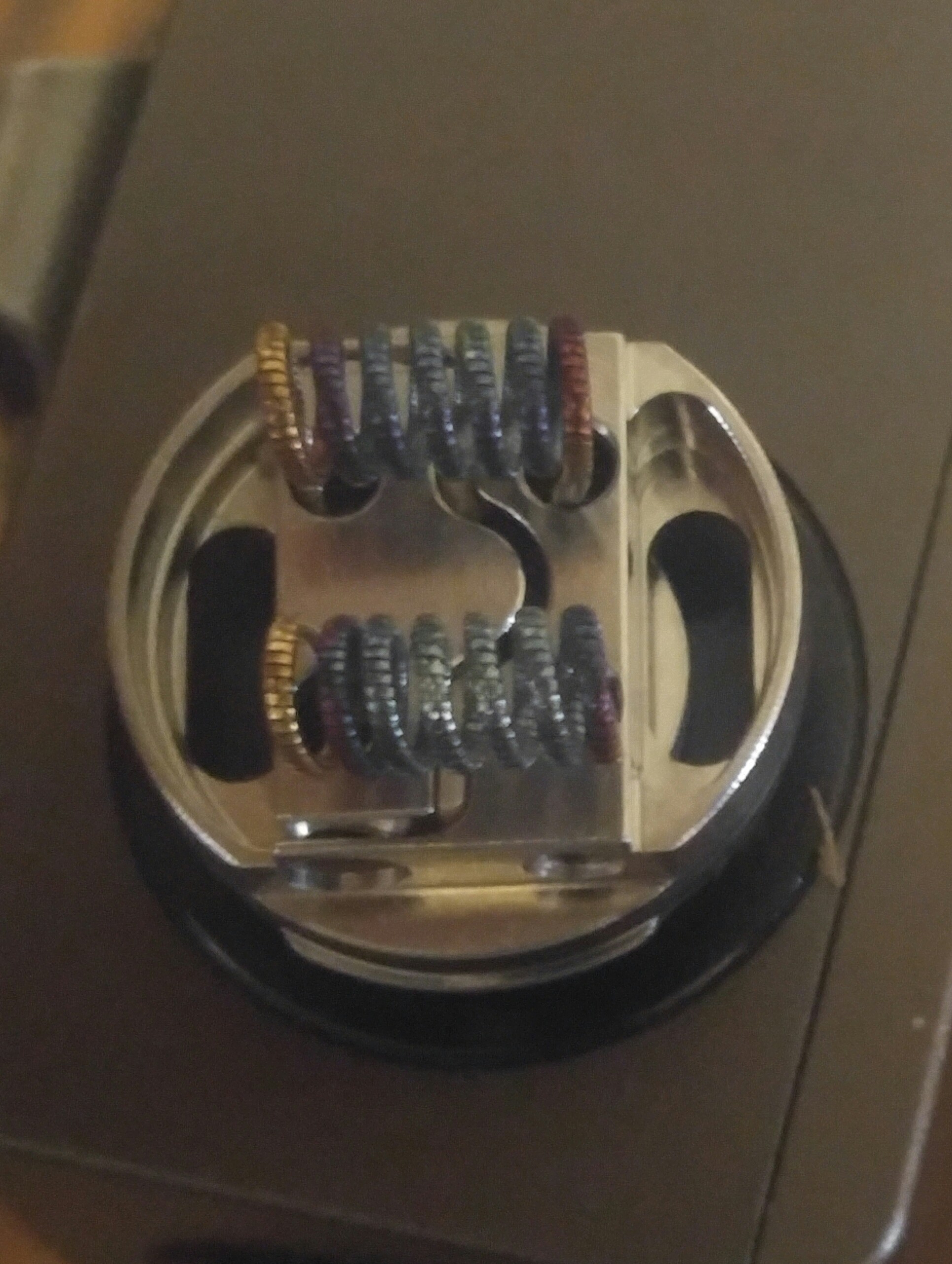

67exec Posted May 1, 2018 Report Posted May 1, 2018 I'm happy to report that the aromamizer plus works great with replay. Dual26g wrapped in 0.3x0.1mm ribbon all 316l from lightning vapes. 3mm if 6/7 wrap .22 ohms.
