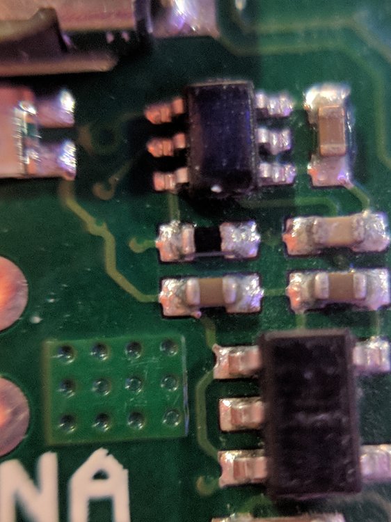

ruckus Posted April 6, 2018 Report Posted April 6, 2018 (edited) I've been keeping an eye out for RGB led switches, I think that would be your best bet and just piggy back off the onboard LED. Would allow the RGB switch to be configurable via escribe also. Only problem is RGB momentary switches are a dime in a dozen.. haven't found many sizes beside a 16mm. EDIT: If anyone has a DNA250C could you take some close up photo's of the LED ? Edited April 6, 2018 by ruckus monkey nuts

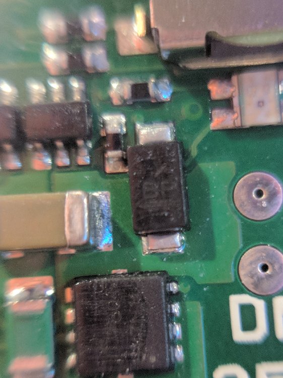

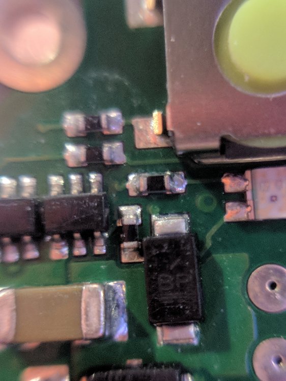

ruckus Posted June 17, 2018 Report Posted June 17, 2018 3 hours ago, forslind94 said: Any progress? I identified the pins, couldn't find a switch suitable for the job. The RGB switches are just to large and bulky..
forslind94 Posted June 17, 2018 Report Posted June 17, 2018 1 hour ago, ruckus said: I identified the pins, couldn't find a switch suitable for the job. The RGB switches are just to large and bulky.. i was wondering if i can draw something around 340 ma of current from one of those pins without any magic smoke apering. It works in the regular 250 board but the driving components might be diffrent. it´s a little work, but you could just take a normal led switch and replace the led with a smaller rgb, like the one on the board.
ruckus Posted June 17, 2018 Report Posted June 17, 2018 2 minutes ago, forslind94 said: i was wondering if i can draw something around 340 ma of current from one of those pins without any magic smoke apering. It works in the regular 250 board but the driving components might be diffrent. it´s a little work, but you could just take a normal led switch and replace the led with a smaller rgb, like the one on the board. A lot of the LED switches are sealed tho.. at least the ones I have on hand, not sure how you would replace the LED. I have attached the data sheet for the RGB should find what your looking for in there.. After it was all said and done, I didn't find it worth the effort, pushed on and put together my mod. LTST-C19HE1WT.pdf
forslind94 Posted June 17, 2018 Report Posted June 17, 2018 11 minutes ago, ruckus said: A lot of the LED switches are sealed tho.. at least the ones I have on hand, not sure how you would replace the LED. I have attached the data sheet for the RGB should find what your looking for in there.. After it was all said and done, I didn't find it worth the effort, pushed on and put together my mod. LTST-C19HE1WT.pdf Thanks.
