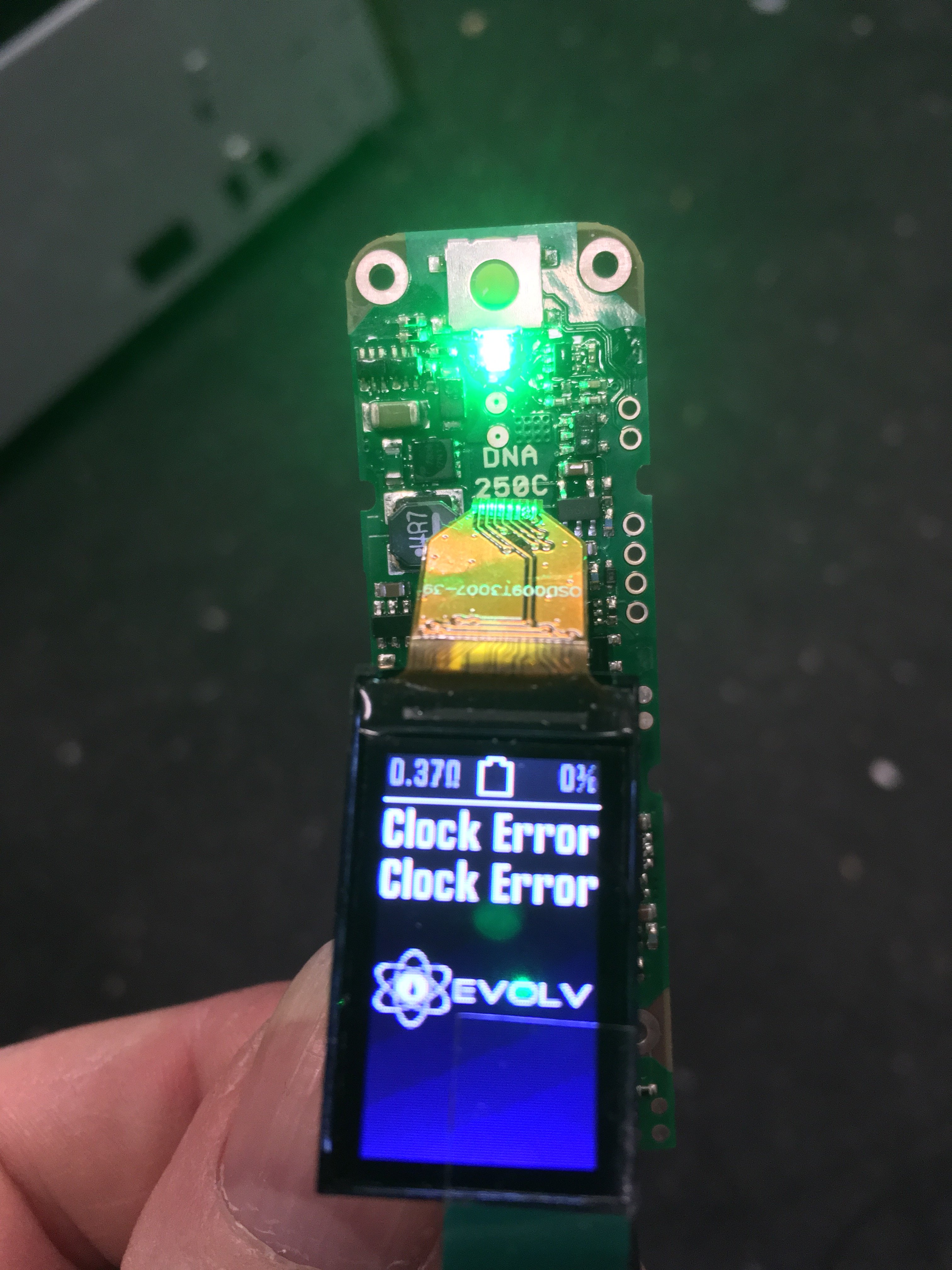

promod2000avenger Posted March 20, 2018 Report Share Posted March 20, 2018 Anyone have any idea why this DNA 250 Color has this error message about the clock and date ? Can't set time and date in settings. Can't connect it to escribe due to version for 250 Color not available yet. Link to comment Share on other sites More sharing options...
Doyle4 Posted March 20, 2018 Report Share Posted March 20, 2018 Once escribe is available that will solve your issue, downside is, thats rumoured for tomorrow. Link to comment Share on other sites More sharing options...
James Posted March 20, 2018 Report Share Posted March 20, 2018 The DNA 250 Color needs a battery attached to power the real-time clock. Link to comment Share on other sites More sharing options...
promod2000avenger Posted March 20, 2018 Author Report Share Posted March 20, 2018 Thank you James. I had a feeling that's what it was. Link to comment Share on other sites More sharing options...
