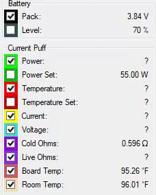

Hello, I'm fairly new to vaping and I seem to have a problem with my Hcigar vt75.
The issue is that when I fire my coils, the 'cold ohm' readings change, so not only the raw ohms but also the cold ohms.
To my understanding this is not supposed to happen(?)
I really don't understand why this would be happening.
Even when I 'lock ohms' the cold ohm reading changes on both my device, the atomizer analyzer and device monitor in Escribe.
Right now I am using 28g SS316L coils on a original Limitless plus tank.
I have the latest firmware available updated to this device.
I have done both a soft and a hard reset without any result.
Anyone has an answer to why this is happening?

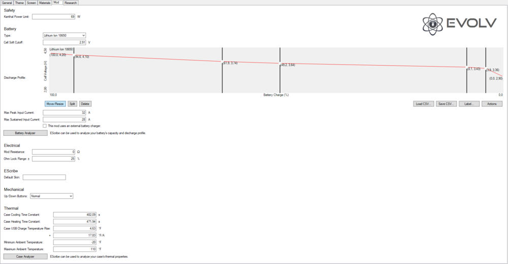

I will add some information in added files.
In reality it's changing because you might be using SS wire, and you showed Profile 2, your mod is not in Profile 2 and just using watts. Notice the 'temperature set' field is blank.
Okay so this is supposed to happen when it's in wattage/power mode?
I understand that it might not matter as much in power mode since i'm not using TC but it's not something that's 'wrong'?
Edit: I tried in TC mode and you're right. It doesn't change at all in TC mode.
Hah! I don't work here/there. But, that is the current behavior of that field. You're good.
If you keep an eye on it, that value will move lower, probably drop ~.03 ohms over the next little bit. You're still good, and that's supposed to happen. 'Refinement', BTW.
