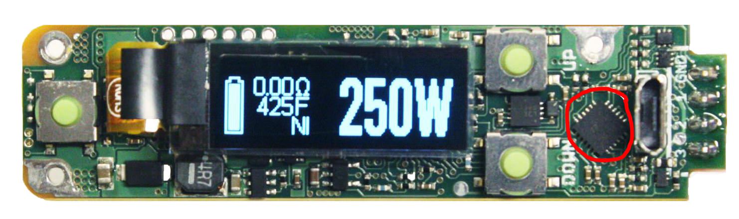

shehabismail Posted February 8, 2018 Report Posted February 8, 2018 Hello, This is to discuess the charging issues on the DNA 250 "Balanced" charging chipset. I owned 2 devices, the Rebel 167 and Vaporshark 250. Both of them DIED and the reason was the charging IC is fried. I went to a local repair shop where I live and they told me this is a common issue and the IC needs to be desoldered and a new one installed and they didnt have stock. I had to buy New boards. I see multiple users complaining about 0% battery here and CHECK BATTERY status and in Lipo case not charging at all. Why did EVOLV use this faulty chip? 1

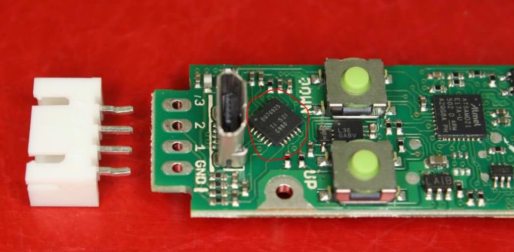

vapesmooth234 Posted February 19, 2018 Report Posted February 19, 2018 thanks for the suggestion on my thread. It seems a lot of 250 boards have this problem but most I read were solved by simply changing escribe's Mod Tab to 2-cell or 3-cell depending on how the MOD is configured. But I can not click the drop down to change that. It just won't let me change it. I Restored all setting etc and tried it in 3-cell etc but nothing. I started a RMA like you suggested. Anyway, can we even buy those charging IC chips separately? And if so, do all those "spider leg" wires need to be individually soldered (in such a small space while avoiding bridging solder from one spot to another), or do they sort of fold in on the other side of the chip and need less solder points? I never soldered such a small thing but I have a micro solder gun and not much to loose if it goes wrong, the MOD I'm considering this for won't USB charge anymore (not the one in my thread I just got 2 weeks ago, a different DNA200 from 17 months ago, past warranty). It suddenly won't charge via USB. It may be due to extremely leaky non authentic TFV8 premade coils leaked like 10ml in a week on the mod I had to keep wiping it, then it stopped charging. I had plenty of leaks before this and it always charged but it was exceptionally leaky before it stopped charging. Having said all that, I'm still sticking with DNA boards only. I like to charge USB and they're safe for that, and they have good warranty anyway.

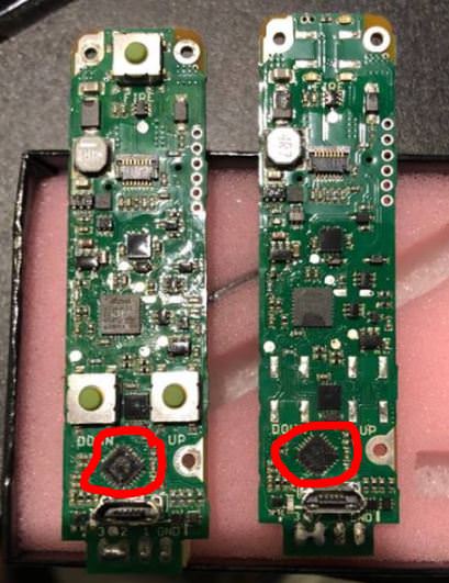

shehabismail Posted February 19, 2018 Author Report Posted February 19, 2018 (edited) Already tried that, and resetteted current limit, tried everything but it was dead. changing it however this IC did fix 1 board but i still have 2 dead ones as seen on my pictures. This IC is very rare and i found it on the repair shop i visited. This shop is vape specific repair shop and they did the desolder and resolder themselves so i am unsure how they did it. Edited February 19, 2018 by shehabismail 1

freneros Posted June 3, 2018 Report Posted June 3, 2018 I have the same problem , and I have more than 25 dna 200 and dna 250 dead boards , I fixed some of them following that. you can find link to buy also the chip.
