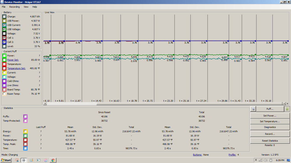

@Boopinhoopties can you post a screenshot of DM with cells 1/2, USB voltage, USB current boxes ticked? It's a great tool for diagnosing problems. The USB voltage should not dip between 5v~4.27V during the constant current phase of charging. Slight peaks and valleys (a few hundred millivolts) are ok. The 250/167 should charge at 1 amp when connect to a PC. Current limiting will happen if : the USB voltage starts to sag around 4.27v / either of the two cells are close to 4.20v / the board temp is reading abnormally high or low temps / USB socket, on board, is wearing out (same for USB cable, itself).
what version FW are you running?
below is normal charging for a DNA 167 2 cell

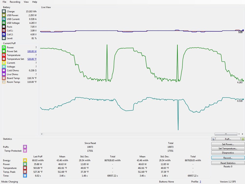

Here is my unhappy looking graph:
My voltage is rolling consistently... and those spikes are new, they weren't there the last time I looked. In this screenshot, my batteries are right at 4.0v, but this behavior is identical no matter what their charge level is (last time I hooked it up to eScribe they were around 3.5v). I know the voltage rolls like this when it's plugged into the wall too, as I can read the fluctuations straight from the device's screen.
It used to charge at 1 amp while connected to my PC and 2 amps when connected to my wall charger, with steady voltage. Now it reads around 4.2v and .5 amps no matter what it's connected to... and I have verified that my charger, cable, wall socket and batteries themselves are not the source of any of these problems.
One thing you mentioned that I haven't experimented with yet is the temperature cutoff... I did run the 'case analyzer' when I first got the device, though I'm still not very knowledgeable about that feature.
@Boopinhoopties You're board says 116f when only charging at an average of .6 amps. This value is unaffected whether case analyzer is ran or not. case analyzer only corrects the room temp readout. My guess is it's board related. Could be a variety of possible causes. Juice on the board somewhere / missing or failing thermistor (or some other board component).
