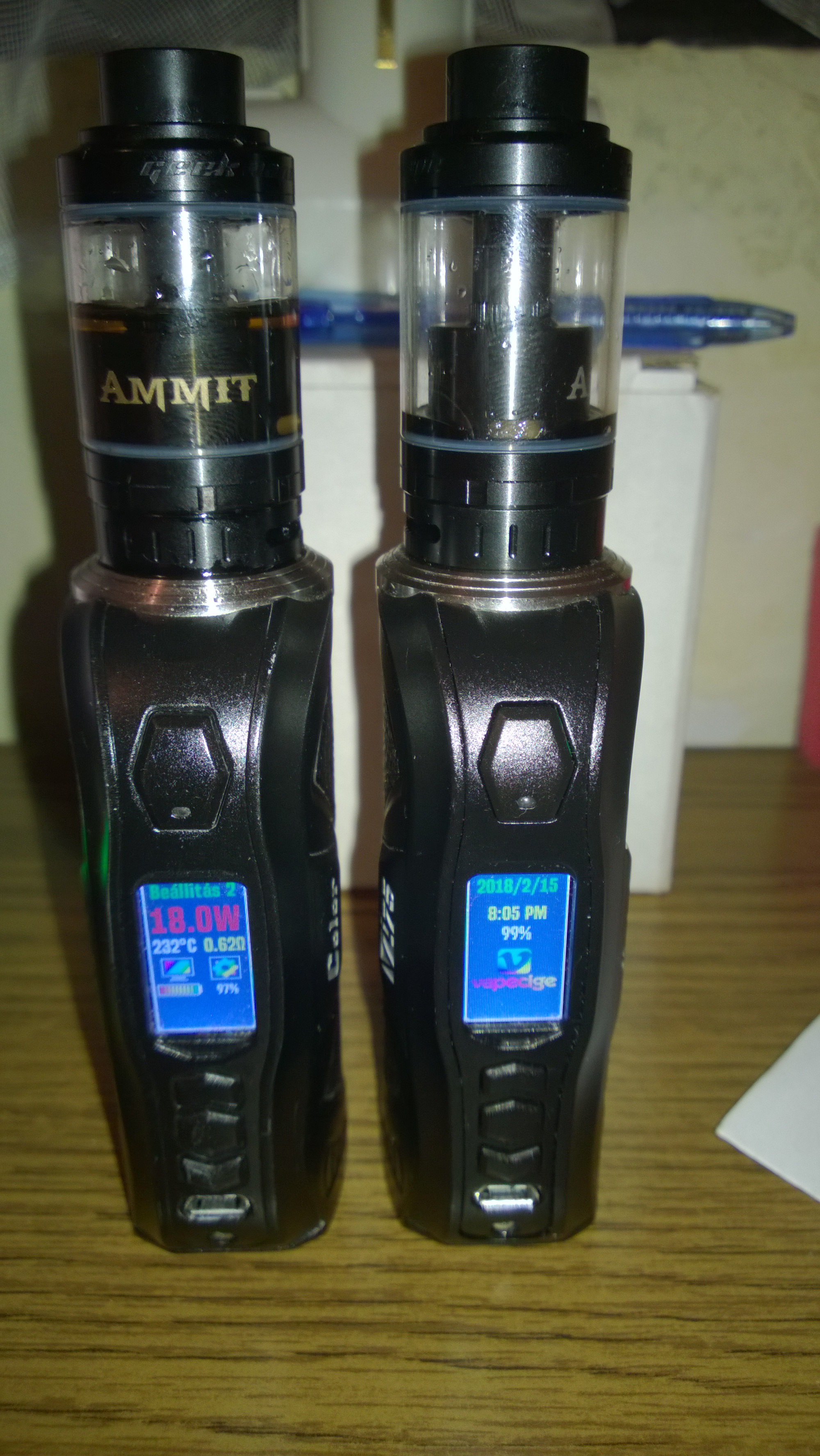

tramog Posted February 3, 2018 Report Posted February 3, 2018 Nothing serious ... but on my box with DNA 75C known that the battery charge level stops at 98-99%, never ever 100%. It also happens to me if I insert batteries previously charged with an external battery charger. Performed the "battery test" for both batteries (Samsung 25R and Sony VTC5A) ... nothing, the boxes signal me to charge battery (green led) and 98% charge level. Does it happen to you too? 1

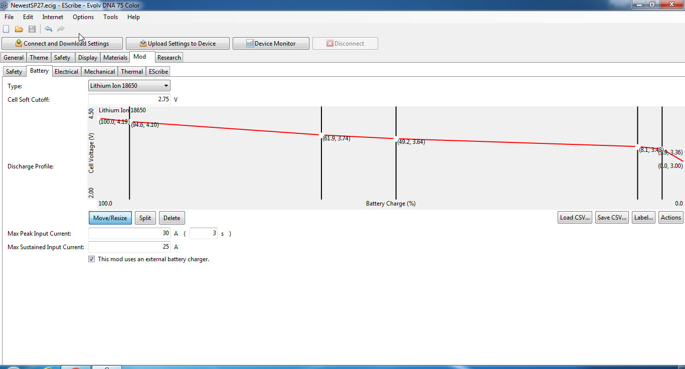

konczmiklos@hotmail.com Posted March 4, 2018 Report Posted March 4, 2018 In EScribe go to the mod tab and change your discharge profile so that the point for 100% has whatever voltage those cells measure when fully charged. If your mod still shows 99% or something, reduce the voltage value for 100% by 0.01V.
Badnews69 Posted March 4, 2018 Report Posted March 4, 2018 The above post is correct hook your 75c BF up to EScribe then go to MOD then go to battery and change the voltage on the graph that's at 100%. Mine was at 4.20v and I changed it to 4.19V. Your problem solved. Look all the way to the left 4.19v. After you make the change Upload Setting To Device. 2
