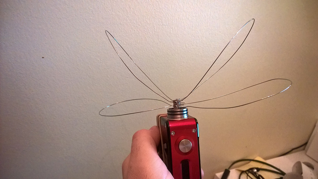

Wayneo Posted December 24, 2017 Report Posted December 24, 2017 An accurate Battery Profile only affects your Icon. BUT you can run your own Battery Analyzer which will be guaranteed accurate for your mod and pair of batteries. All you need is an RDA, 4 loops of wire, fan, and an hour. Welcome
TechXero Posted December 24, 2017 Author Report Posted December 24, 2017 On 12/24/2017 at 2:12 PM, Wayneo said: An accurate Battery Profile only affects your Icon. BUT you can run your own Battery Analyzer which will be guaranteed accurate for your mod and pair of batteries. All you need is an RDA, 4 loops of wire, fan, and an hour. Welcome Expand What do you mean by 4 loops of wire and fan ? How does that work ?
giz_60 Posted December 24, 2017 Report Posted December 24, 2017 (edited) Run the 'Battery Analyzer' in Escribe with your RDA set up like this...with the fan blowing on it to keep it cool... Edit: As @Wayneo stated, the .csv is only going to affect the battery % reading... Edited December 24, 2017 by giz_60 Edit
