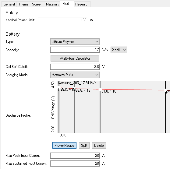

Got it out of the box, loaded the same titanium profile I use on the Therion, added the same batteries (Samsung 30Q's) and replicated the settings from the Therion (so effectively it should be almost exactly the same) - oh yeah using the exact same attys.

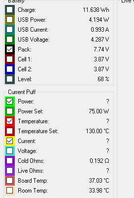

But it just won't play ! ... it seemed to be pulsing ... really badly, 1 second on one off.
Tried a few "Reset to default" and Re-applying the SP , it actually bricked last night after a reload, it would only show the Evolve 250 text then turn off, luckily I discovered that if I plugged it back into the PC, switched it on, it "booted up" so was able to do another SP reload, which brought it back to life ! YAY.
This morning I ran the Case Analyser so it now also has the correct settings in there, but it still will not vape correctly.
here are some screen shots of most of the relevant info (I think)
Here is what happens when trying to vape it.
5a3c09ded8fca_2017-12-2119_04_29-DeviceMonitor-EvolvDNA250.png.8405be11908b0359c7619f36fad18b3e.png5a3c0a38b1538_2017-12-2119_05_36-Settings.png.f9391bfdc49317c6118bfa0de5c4d60e.png5a3c0a5fe85a8_2017-12-2119_06_36-Settings.png.1ab65a696613005f3e60b352e26067e8.png
5a3c0a6837146_2017-12-2119_06_57-Settings.png.e7b8266fa2b85934496708eb32d651e3.png5a3c0a70334c2_2017-12-2119_06_08-_EScribe-EvolvDNA250.png.01099a454998e679792b1ab2313b07ff.png
A couple of oddities are that
A) the Paranormal is not reading the resistance of my tank\coil correctly, the cold resistance is always .14 (as read from my spare IPv4 and my tester) but the Paranormal is reading it at .19 to .20
B) the temp setting is way off, i'd normally be vaping the Therion at 240c, on the Paranormal I have to drop the temp down to 115 - 130c else it dry burns !!
C) the "Temp Protect" message never appears on the screen.

Could there be something in the settings that is causing this ? .. I don't personally think so, i've checked\changed everything possible.
