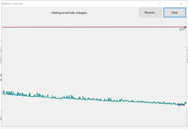

siskin95 Posted October 28, 2017 Report Posted October 28, 2017 Hello, I have the same problem, with Efest and VTC6 batteries. But with mod Lost Vape Paranormal. I wanted to try the Battery Analyzer in Escribe ... but it's not possible because Escribe writes "Waiting to be fully charged" .. LOL
giz_60 Posted October 28, 2017 Report Posted October 28, 2017 You have to allow Escribe to fully charge the cell before the analyzer will start...
siskin95 Posted October 29, 2017 Report Posted October 29, 2017 8 hours ago, giz_60 said: You have to allow Escribe to fully charge the cell before the analyzer will start... After a long wait ... the Battery Analyzer finally started up and I could make my own battery profile. And it works! Here is the cvs (Dual Efest 3000mAh 35A 18650): Dual_Parrallel_Efest_3000mAh_35A_18650.csv

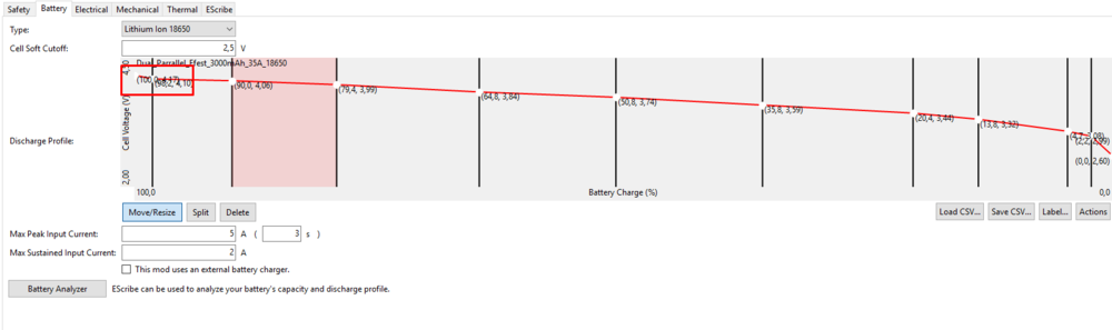

siskin95 Posted November 15, 2017 Report Posted November 15, 2017 On 10. 11. 2017 at 3:29 AM, tarunprakashsingh said: Loaded vtc5a profile... no better Edit your baterry profile..set 100% on cca 4,17V...or you can take data from ,,device monitor"
Wayneo Posted November 15, 2017 Report Posted November 15, 2017 So are those your actual values you are using?
