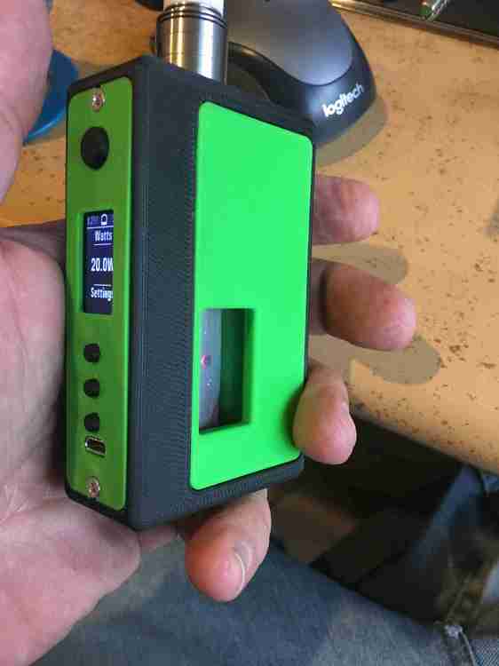

I just got my first 75C :love: and I am testing it.

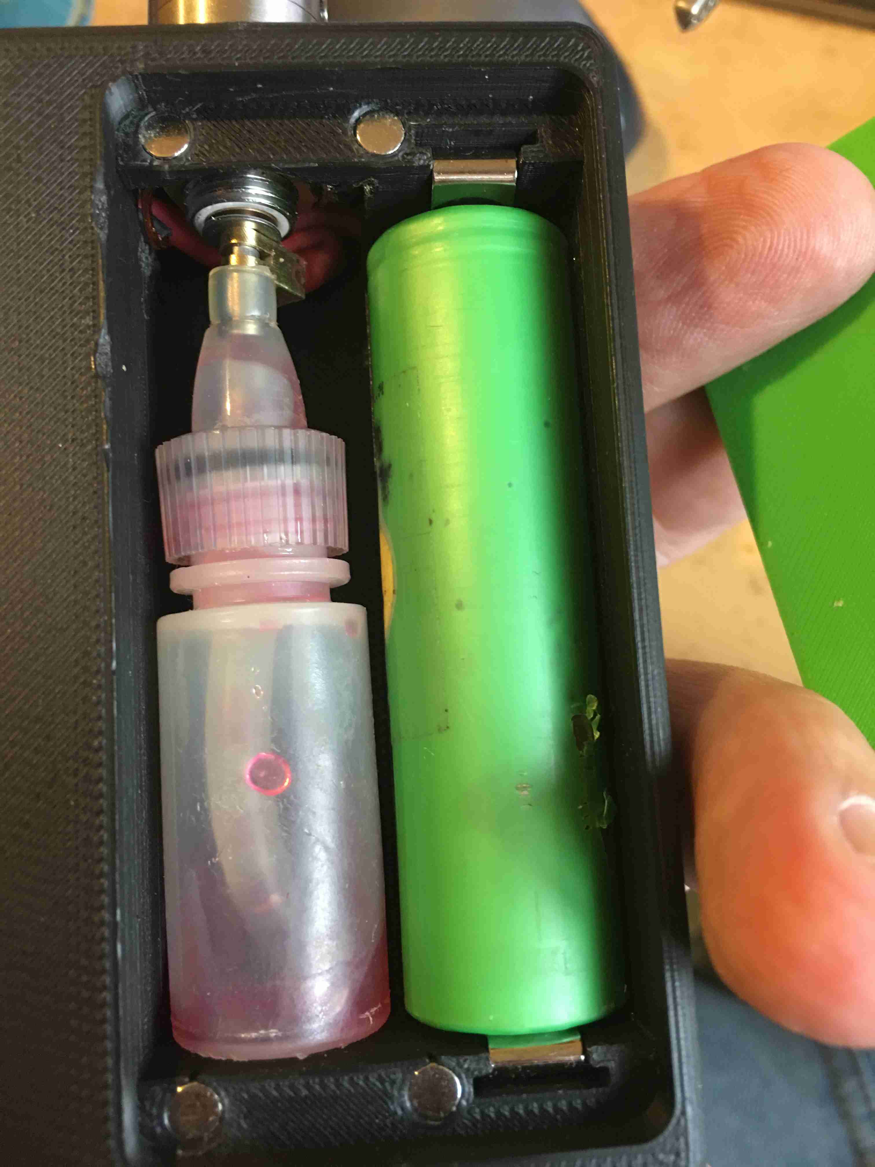

I installed it on a custom made  3D-ABS BF box - The cables I used are silicon insulated on positives and silver for negatives/gnd -  gauges are as per Evolv specifications - I inizialized the device with Escribe 2.0 SP 7.

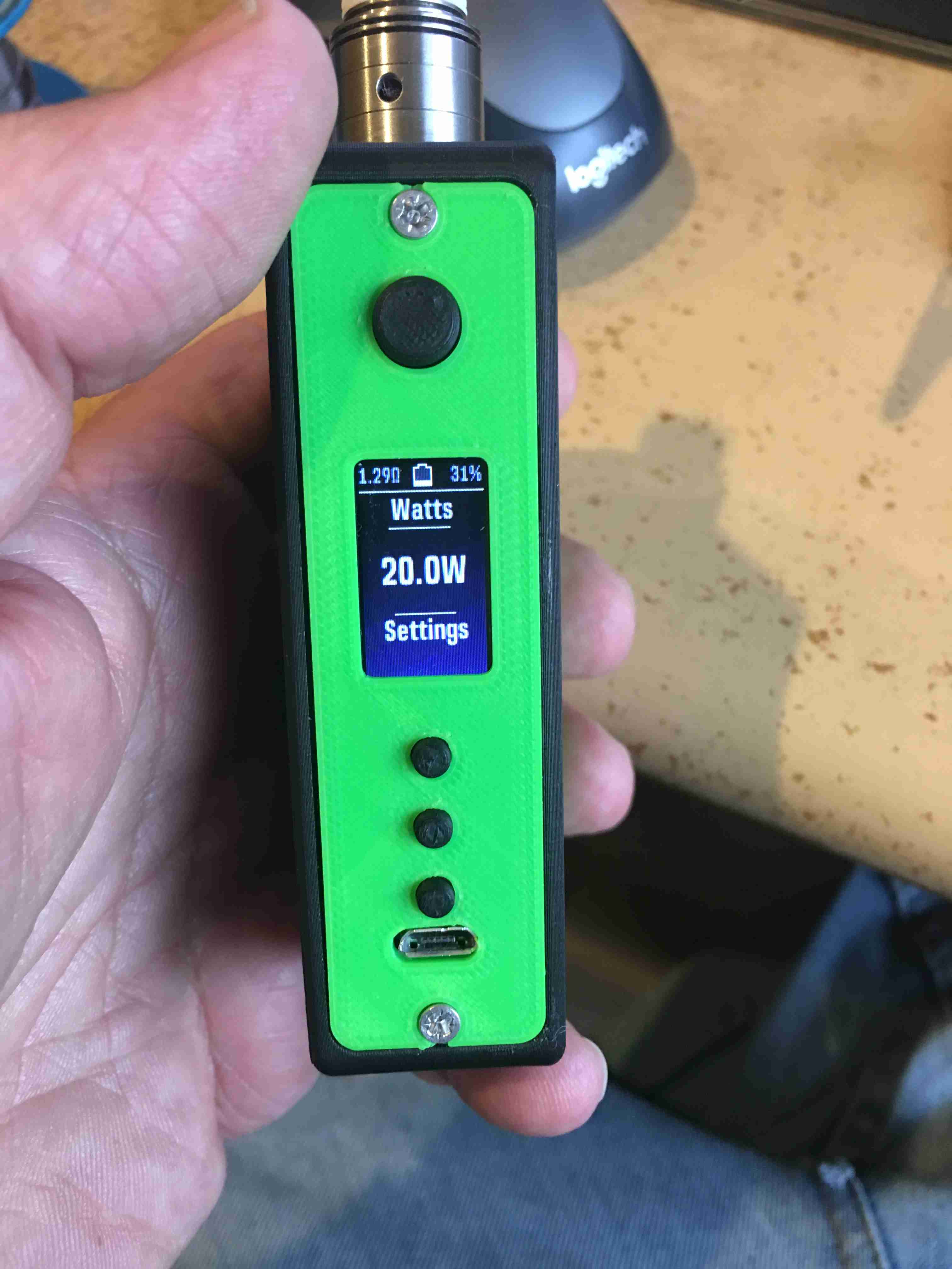

Profile : Watt - TC DISABLED (Off everywhere is possible lol)
Electrical connections are solid and installation is done quite well (Even if is my first 75, I have installed many mods with Evolv devices from DNA20 upto DNA250 so I am sure about this specific hardware installation)
I am testing two different sets:
1) My Origen Little - Standard Ka1 0,25mm (30ga) x1 - 4 onto 3 coil wraps -  something like 1.3 Ohms - it is working perfectly from 13W upto 20/25W
2) My MB Chalice-IV - Twisted KA1 0.32mm (28ga) x3 - 5 onto 4 coil wraps - something like  0.21 Ohms - it does'nt like to work! Every time I press Fire - from 13W upto 40/50W - the device starts screaming "Temp Protect" (Of course at 13W it gives you 1/2- 1 sec time to fire while at 40W is not firing even for a millisecond)
How that is possible? In Watt profile, temp sensing should and is disabled - I rised up all temperature values (they should not be read if TC is off but - just in case!)
