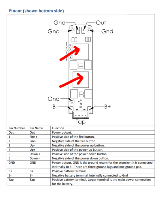

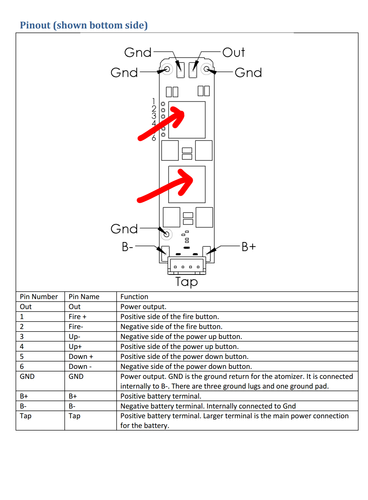

spippo Posted August 30, 2017 Report Posted August 30, 2017 (edited) Hi, excuse my English, I'm using Google Translator :-). I need some information, the chips that are highlighted in the photos, those quads, the square ones, I think they call MOSFET, Can they be installed with thermal paste to the aluminum body? Is it best to leave them completely isolated? What if those chips touch the body? Thank you! Edited August 30, 2017 by spippo
Spector NS5 RD Posted August 30, 2017 Report Posted August 30, 2017 12 hours ago, spippo said: Hi, excuse my English, I'm using Google Translator :-). I need some information, the chips that are highlighted in the photos, those quads, the square ones, I think they call MOSFET, Can they be installed with thermal paste to the aluminum body? Is it best to leave them completely isolated? What if those chips touch the body? Thank you! yes you can use thermal paste on the inductors and it will be absolutely fine if they touch the inside casing of the mod. there is no electrical connection between the inductor's casing and the board. 2
