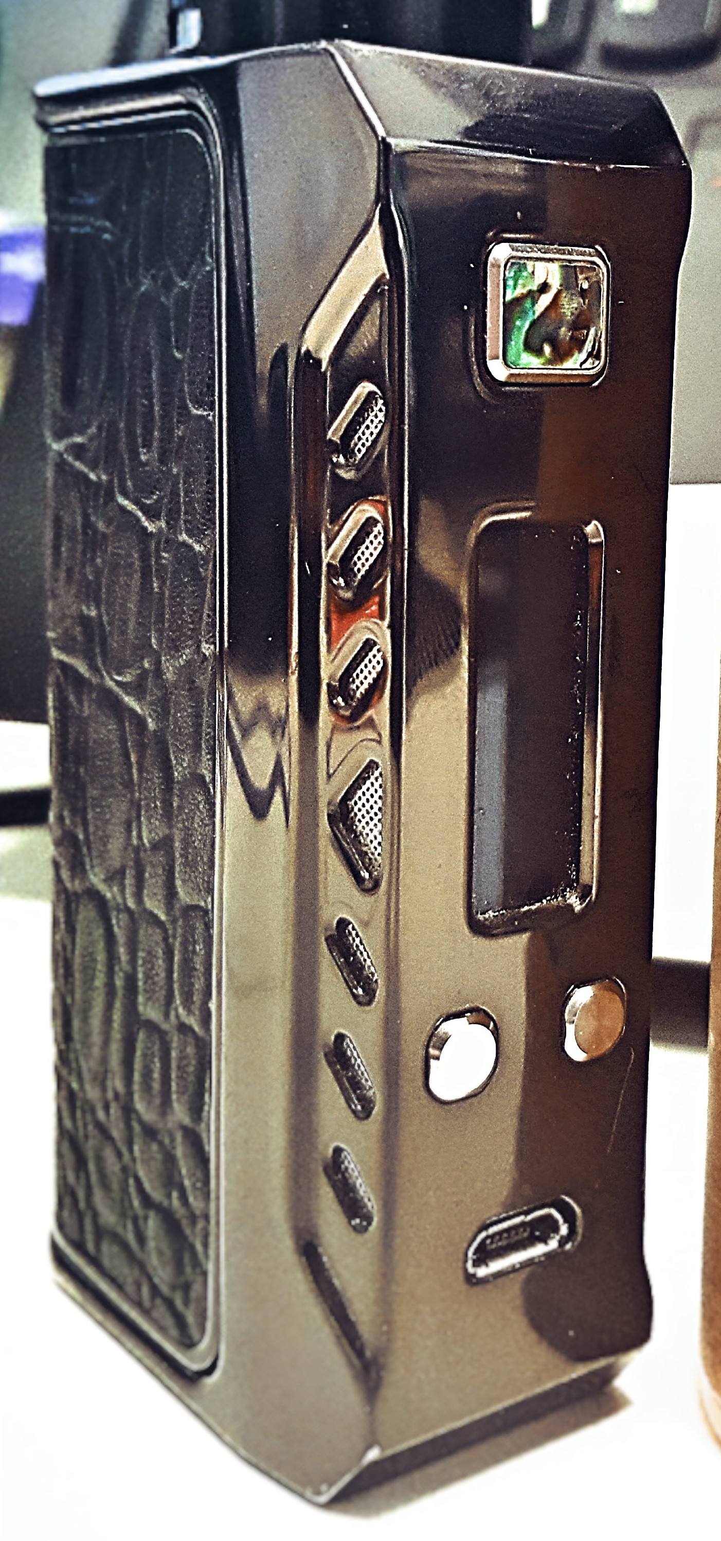

Chief Grey Bear Posted July 24, 2017 Report Posted July 24, 2017 I just received my Think Vape Finder DNA250 but the instruction manual is horrible for the device. I have it on Profile3 for S.S.316L but only the ohms are registered until I hit the fire button then the volts and amps are displayed but only then. No matter where I set the temp 1 second after I hit the fire button the screen read OFF instead of displaying the temp but continues to fire. Kind of glad I'm using S.S.316L because if it was Ni200 or Ti I'd be worried TC is turning off and not functioning. Any info would be appreciated. I have no issues with my DNA75 Color functions beautifully.
67exec Posted July 24, 2017 Report Posted July 24, 2017 The volt and amp readings on-screen are live l, so they will only show while firing. You're kicking out of tc sounds like a hot spot on a coil, or a connection issue between the board and the coil. Do you have EScribe? A device monitor screenshot would help a bunch. Make sure that power, set temp, live temp, cold ohms, and live ohms are all checked for your screen shot. 1
