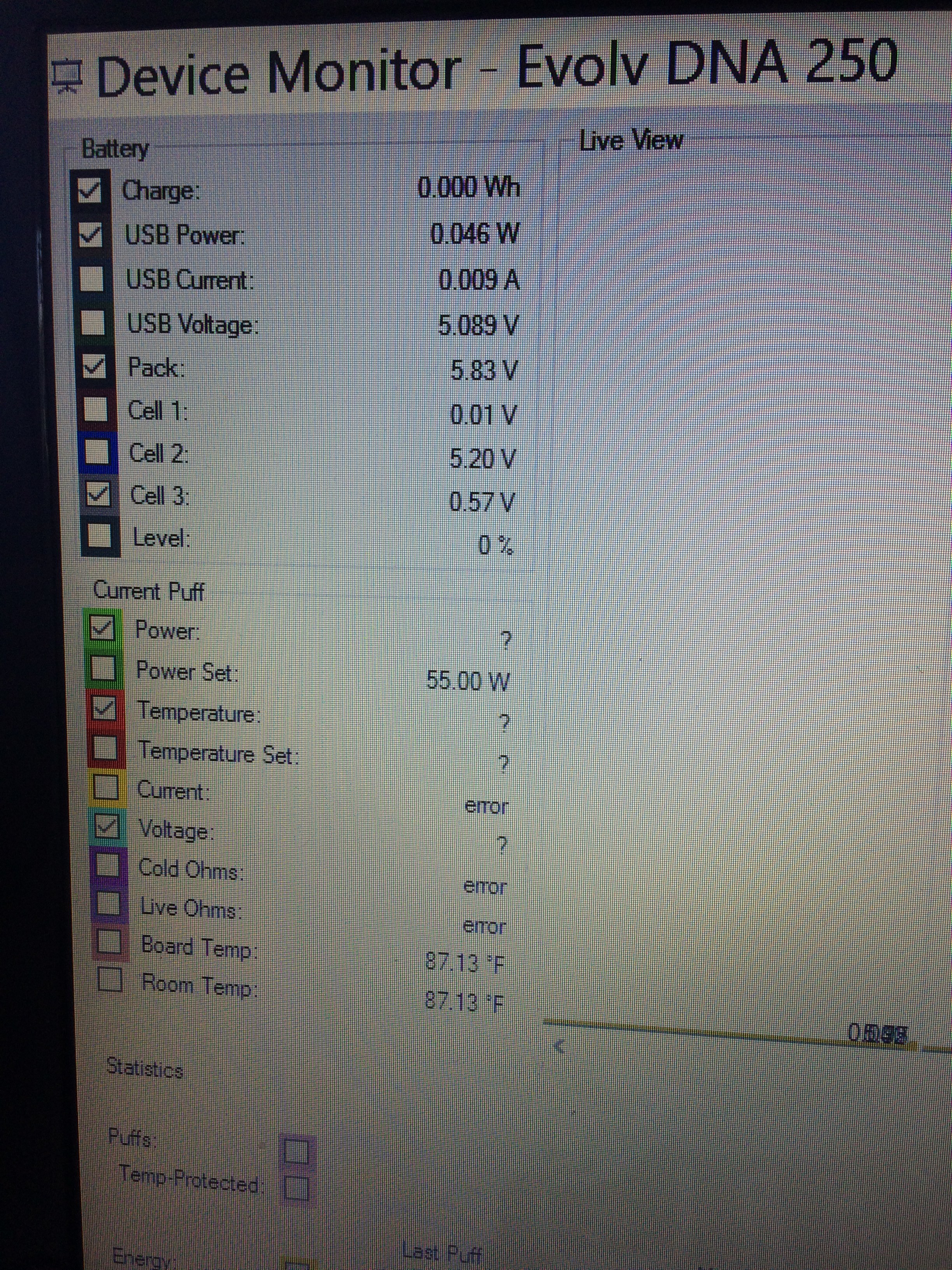

Kruchy9752 Posted June 22, 2017 Report Posted June 22, 2017 Hi, my therion 167 is crush, it didnt see batteries, 0%, dont know how to explain this

Lowbytes Posted September 5, 2017 Report Posted September 5, 2017 Please change your escribe configuration You may need to select Options > User Interface > Manufacturer from the top dropdowns in order to see and change this setting.Dual 18650 mods will display this behavior if they are set to 3-cell operation and not 2-cell operation on the Mod tab in EScribe. Your mod is currently set to 3 Cell mode!!!!! 2
shehabismail Posted February 7, 2018 Report Posted February 7, 2018 balanced charging ic was dead in my case (Rebel 167) and board needed to be replaced.
