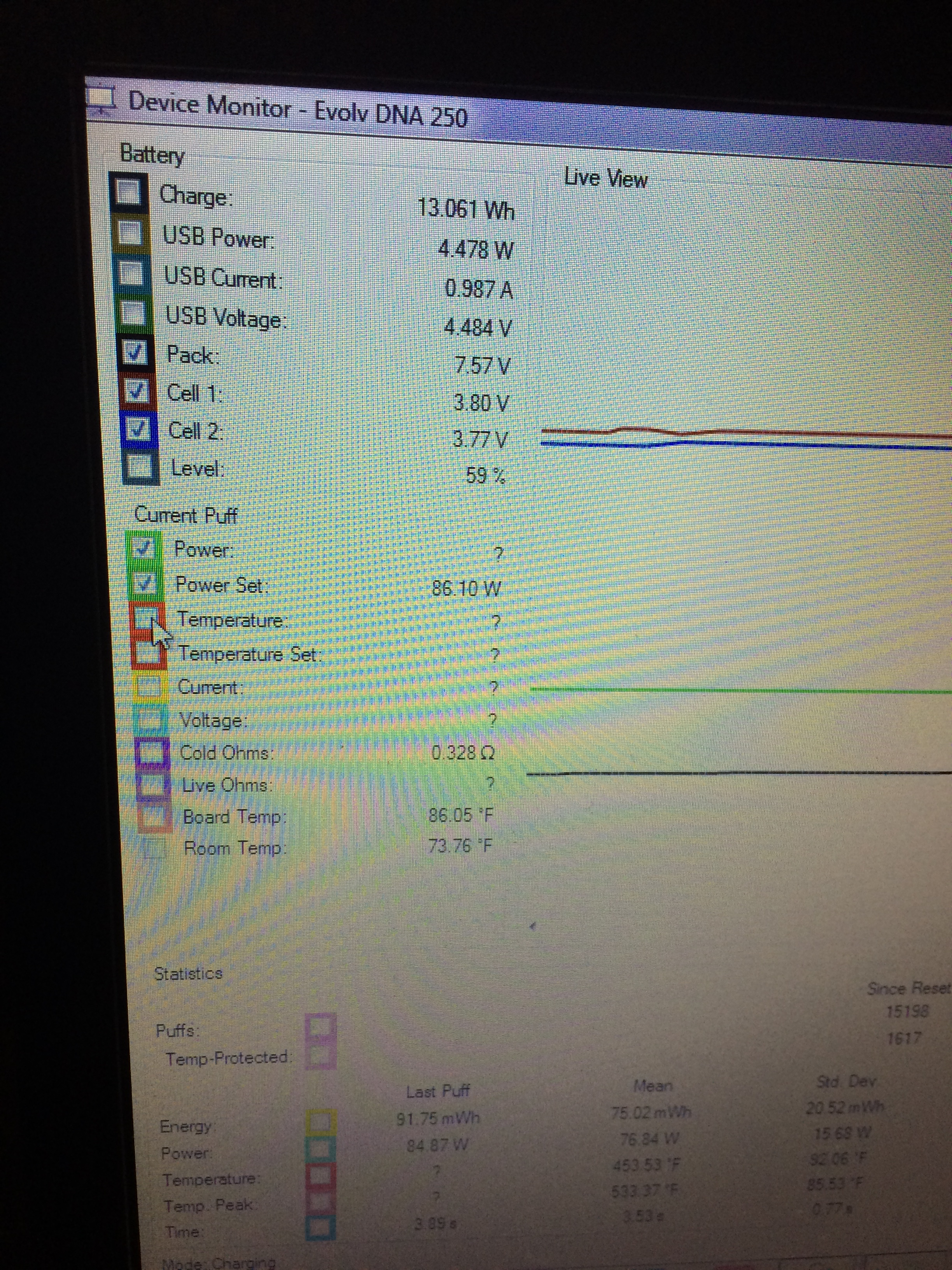

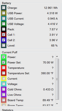

Wayneo Posted June 18, 2017 Report Share Posted June 18, 2017 (edited) AFTER doing everything in Post 3, and this occurs (LG's in use), 2 Printscreens please. Full Printscreen of your MOD tab (yeah I'm checking you followed Post 3) Full Device Monitor Printscreen while this occurring, with only the 4 checkboxes ticked, as shown in this image. You can also change the behavior of those errors/warnings on your screen tab if it bothers you. AND STOP SENDING ME PRIVATE MESSAGES, like I asked. Public messages helps others with this issue, and gets other knowledgable eyes on suggestions offered. Edited June 18, 2017 by Wayneo Added Screen tab info 2 Link to comment Share on other sites More sharing options...

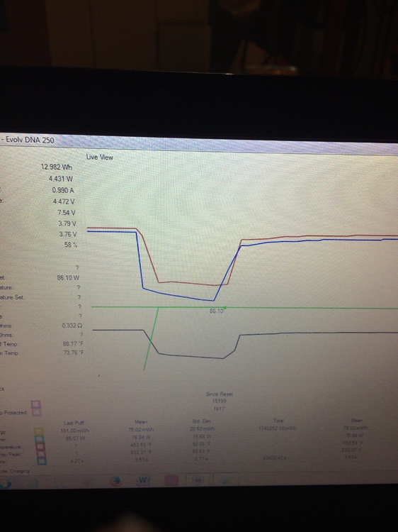

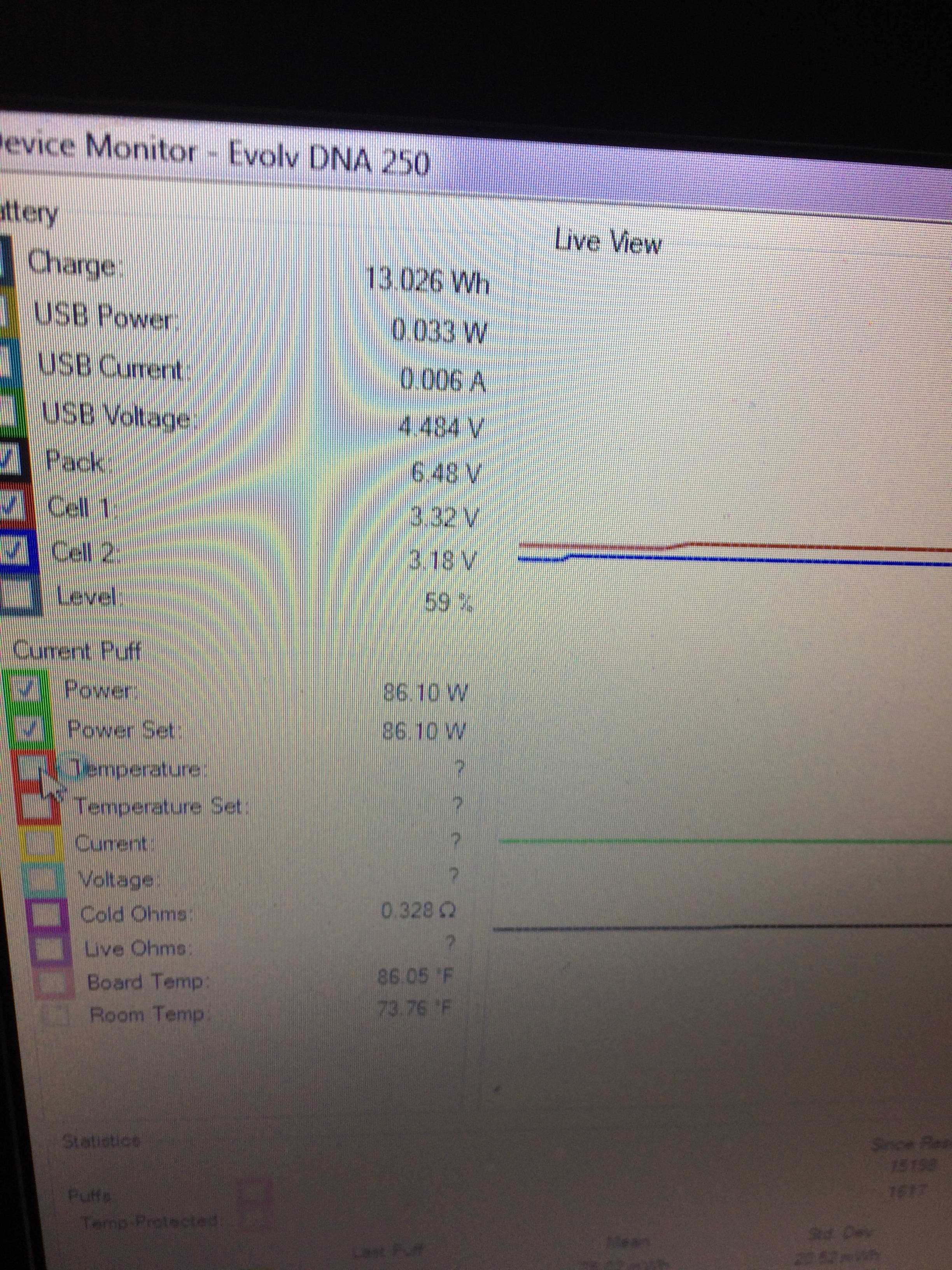

Dk81 Posted June 19, 2017 Author Report Share Posted June 19, 2017 heres the escribe pics Link to comment Share on other sites More sharing options...
Dk81 Posted June 19, 2017 Author Report Share Posted June 19, 2017 So pic 1 is at idle pic 2 is after hit which shows battery sagging, but this is at battery life at 59% the flashing bar happenes at 50% and under then when I take the batteries out and reinstall they read 20% or less after just reading 45-50% Link to comment Share on other sites More sharing options...

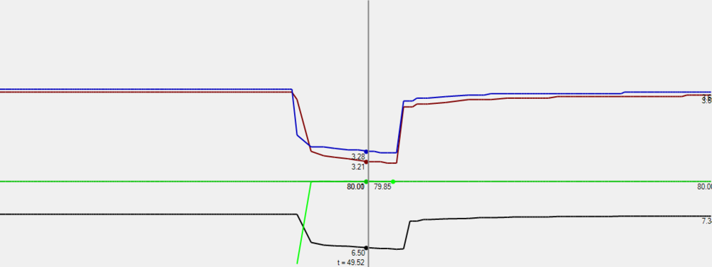

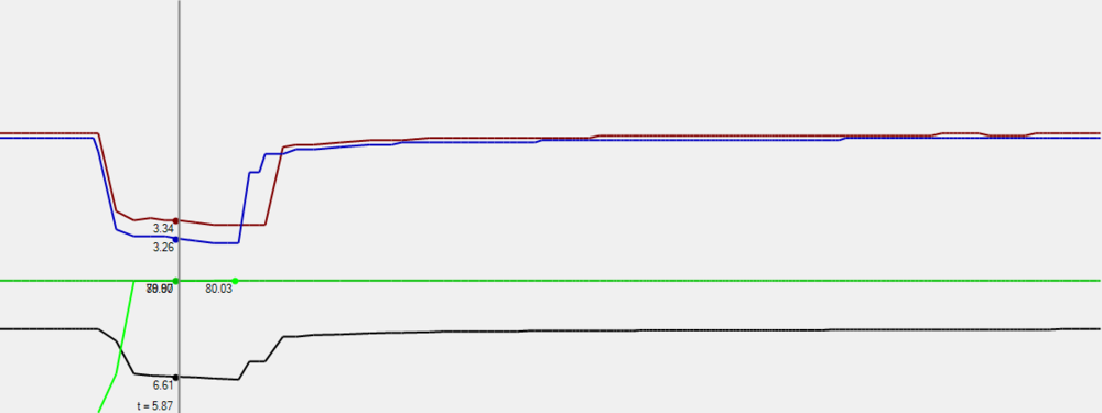

Dk81 Posted June 19, 2017 Author Report Share Posted June 19, 2017 again so I saved the graph but it wouldn't show the side bar if this is needed let me know please pic 1 batteries set pic 2 batteries reversed Link to comment Share on other sites More sharing options...
Wayneo Posted June 19, 2017 Report Share Posted June 19, 2017 Well, the pics show that 1 cell is actually sagging a tiny little more than the other. See how that lower value on the vertical was red in pic1, then blue when you changed positions? So that looks decent. If you could have had that vertical at the very lowest point would have been perfect. Yes a Full printscreen is better. Why? Shows current firmware (but not needed here) Shows puffs, (eyeballing it, and if a wire issue suggest you contact LV. Shows the ending battery voltages (needed) Now over to the left Shows pack total, individual cell values, estimated wh remaining and %, board temp, room temp <- all used to help where to focus. Just from what I see, pic 2 could actually be the first vape, but I can't see the puff count, blah blah blah. Rambling, but I hope you can appreciate how excellent DM and a full printscreen is for troubleshooting. What is the actual error that flashes? or is it that ....Your battery says a certain high % and your screen flashes? Please post a Full printscreen of your 'Mod' tab And just 1 more Full printscreen while firing. Try to get that vertical line at the lowest point of the red or blue line like you did before Is it really just the battery display or % ? Does the mod fire even more (keeps working) after flashing? When you do take out the batteries to charge, what voltage are they usually at? (either on mod or charger) Link to comment Share on other sites More sharing options...
