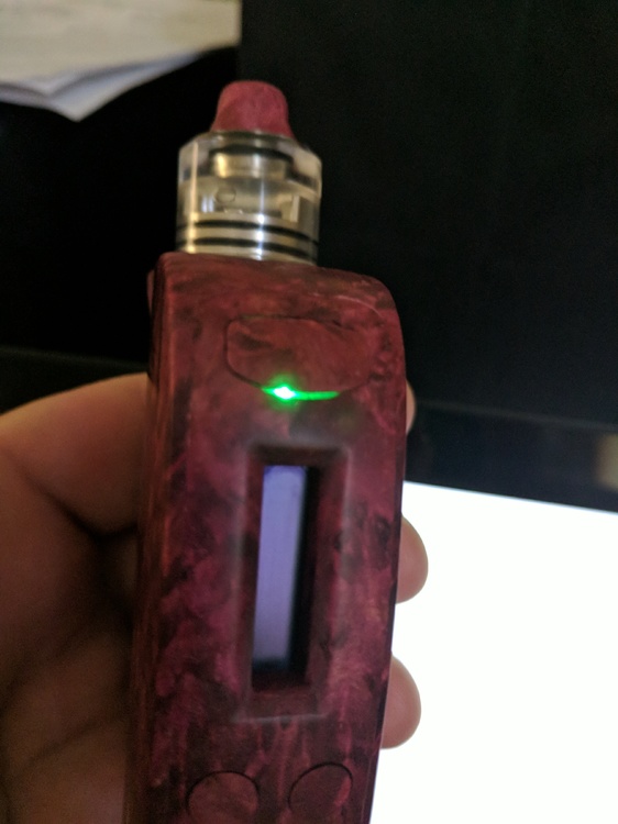

martyotaku Posted June 15, 2017 Report Posted June 15, 2017 Got a mod ...and the light in the fire button stays green all day and night causing battery drain ...how can I turn this off on escribe? Thanks

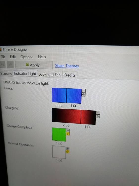

retird Posted June 15, 2017 Report Posted June 15, 2017 In EScribe run the Theme Designer and click on "Indicator Light" tab and see what the settings are....What does the green light mean (charging, firing, charge complete, or Normal Operation) ? Does the mod work and just the led light won't go off?
martyotaku Posted June 15, 2017 Author Report Posted June 15, 2017 Mod works fine ...I think when I press to fire it's red ...then when it's left alone stays on at green no matter how long ...noticed that the other day when I went to vape it and battery was half drained ...which was never a problem with any DNA device iv had ...I'll check escribe when I get home tonight ....thanks
martyotaku Posted June 15, 2017 Author Report Posted June 15, 2017 On escribe the green is on charge complete....
martyotaku Posted June 15, 2017 Author Report Posted June 15, 2017 And this is a pic of the light I'm talking about ...stays on no matter what?

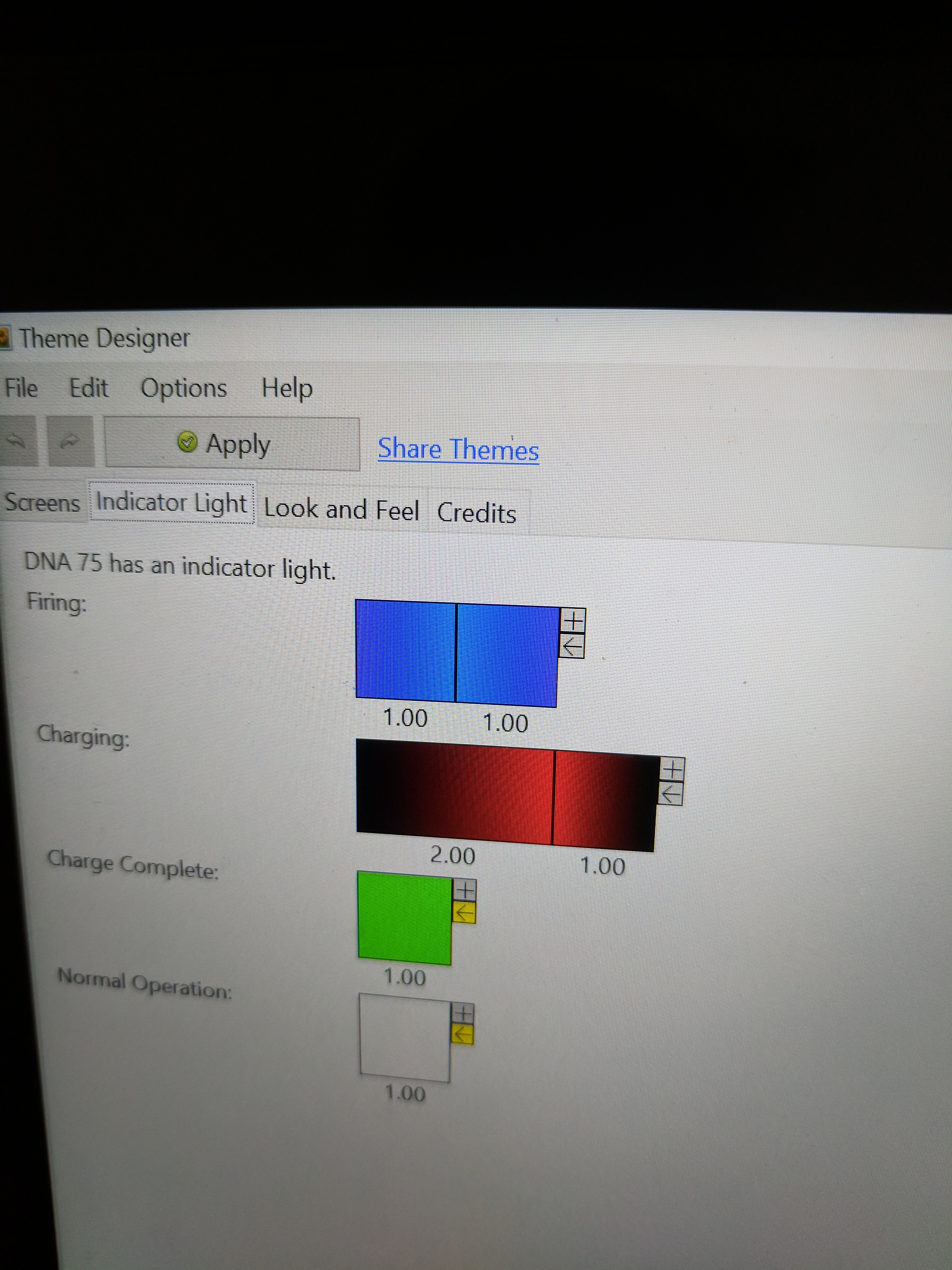

retird Posted June 15, 2017 Report Posted June 15, 2017 hum.... from the screen shot of Theme Designer the Green Light should indicate the battery is fully charged and should be Green only when plugged in to charger, Blue while firing, and Red while charging. You might save a copy of the Theme and a copy of the *,ecig file and then delete the Green setting in the Theme and upload that and see if the Green light goes out... I assume the Red and Blue lights work as per the settings...
The_Vape_Weasel Posted June 17, 2017 Report Posted June 17, 2017 try deleting that box for Normal Operation mine dont have a box there and light stays off.
The_Vape_Weasel Posted June 17, 2017 Report Posted June 17, 2017 just noticed that version of escribe looks different then mine?

martyotaku Posted June 17, 2017 Author Report Posted June 17, 2017 17 minutes ago, The_Vape_Weasel said: try deleting that box for Normal Operation mine dont have a box there and light stays off. Did that and seemed to do the trick ...Thanks 1
