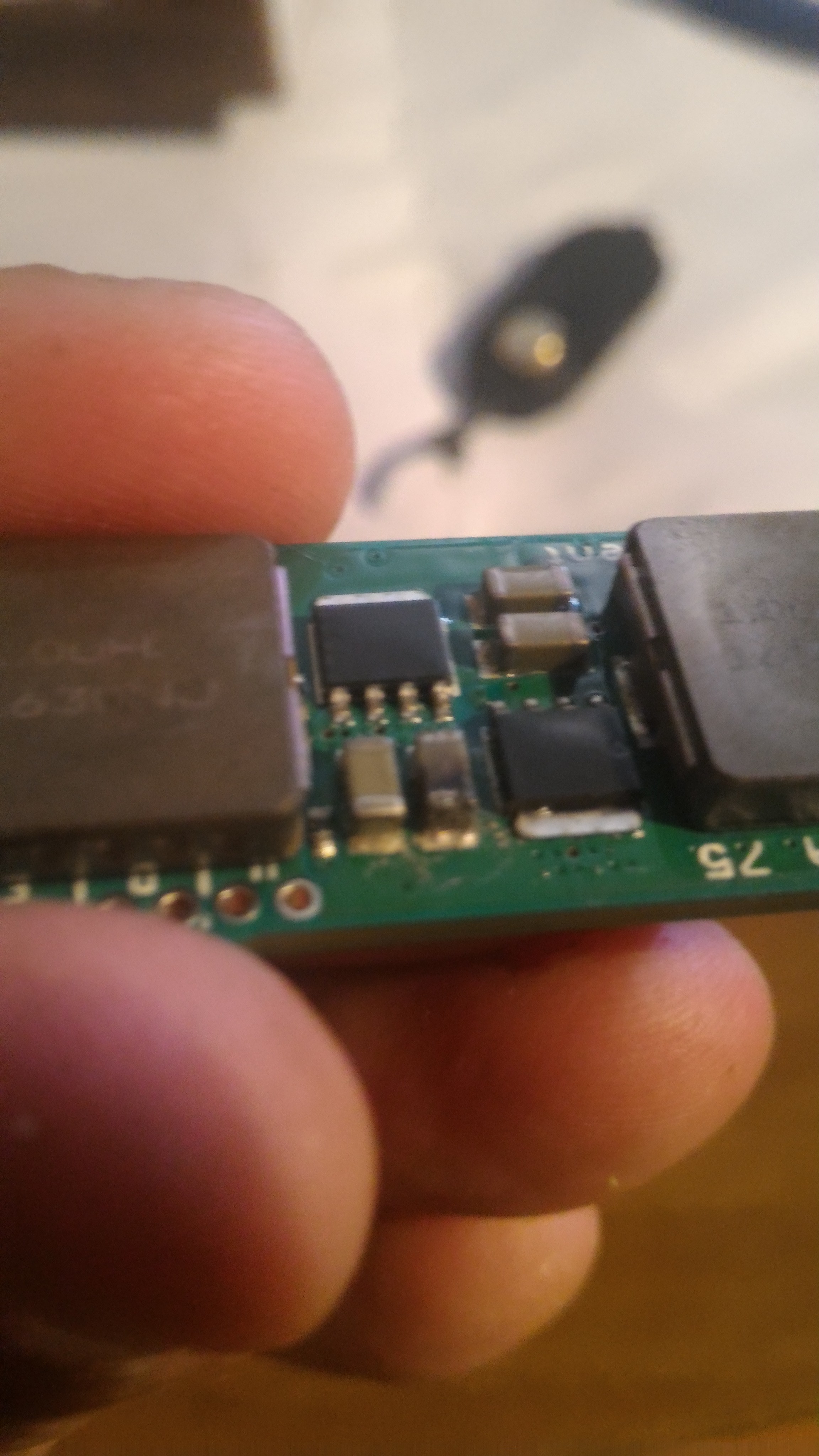

Andrea76 Posted July 23, 2017 Report Posted July 23, 2017 Box works but it drains batteries even in sleep. 8am to 12.30pm, from 99% to 0. Not being used. Here the situation. Do u think I am going to fix it changing only the resistor like or will i need toc change also the capacitor? Can not find any information about those components
Mauriciojpdr Posted July 31, 2017 Report Posted July 31, 2017 On 7/23/2017 at 3:14 PM, Andrea76 said: Box works but it drains batteries even in sleep. 8am to 12.30pm, from 99% to 0. Not being used. Here the situation. Do u think I am going to fix it changing only the resistor like or will i need toc change also the capacitor? Can not find any information about those components Mine is also burnt, have you already fixed the issue by replacing it?
