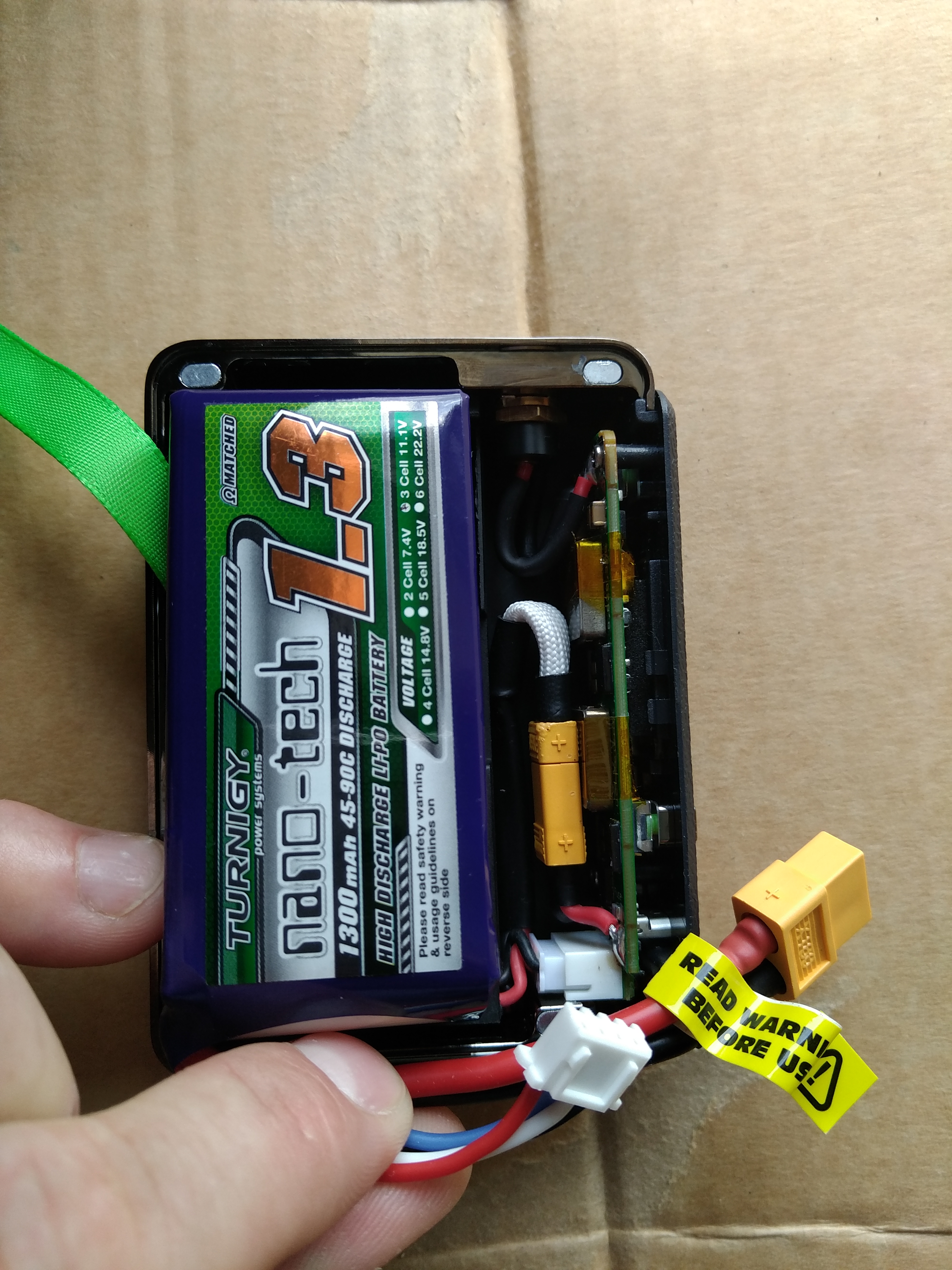

These things are really tight inside with the connection on the board having very short wires, so not much in the way of movement.
Does the seller extend the original wires in anyway? I don't have a 1100mah to compare, but if it's the same wire length as a 1300mah there will be a problem of physically being too short.
