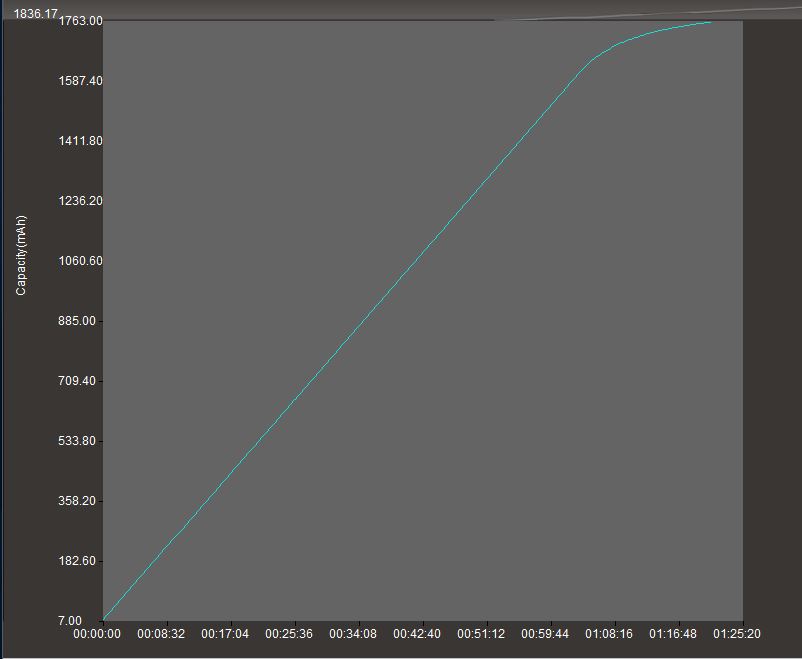

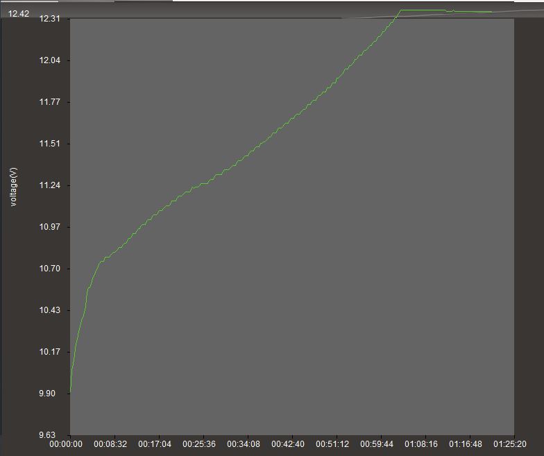

I just completed the discharge testing on my LiPo analyzer and created the battery discharge profile CSV for escribe for the Turnigy Nano-Tech 1.0 11.1v 1000 mA LiPo pack. This battery of course can be used in many mods, of course, but I know for a fact its a perfect fit in a Starss Player 133/200 and the Asmodus Oni 167. Just for background on the testing I completed 3 full charge and discharge cycles on my analyzer to ensure I was getting accurate results. Average discharge rate for the tests was 1/2 amp however I tested at 1 amp and ended up with the same profile. I have attached the graph for anyone that wants to check my math however it should be really close to spot on. I hope this saves a little work for anyone looking to swap to using this LiPo pack instead of the stock 18650's those two mods come setup for.
