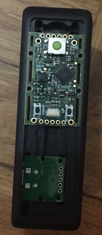

Asfanews Posted May 15, 2017 Report Posted May 15, 2017 I've just recived the DNA60, and I am assembling my first box bf. I didn't expect I had to cut the circuit. Any suggestion please on how to do it? I have to cut the two lateral bars to make the circuit fit in the slot in the box
VapingBad Posted May 15, 2017 Report Posted May 15, 2017 Either with side cutters or snap off with pliers or put the edge in a vice and snap, they are designed to snap off and it doesn't matter if you don't snap the rails off in one go, do a little at a time if that feels safer. ETA you can clean up the edge after with a file or sand paper if needed.
Asfanews Posted May 15, 2017 Author Report Posted May 15, 2017 51 minutes ago, VapingBad said: Either with side cutters or snap off with pliers or put the edge in a vice and snap, they are designed to snap off and it doesn't matter if you don't snap the rails off in one go, do a little at a time if that feels safer. ETA you can clean up the edge after with a file or sand paper if needed. Thanks a lot man. I didn't know it was so easy and that it was made to snap off soo easly. Thanks also for the cleanng up the edges tip, I didn't know I could do. Now It fits perfectly in the slot it was designed for.
