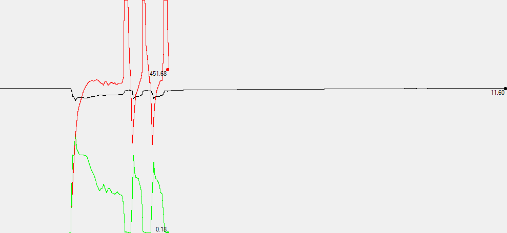

Ohhepicfail Posted July 7, 2015 Author Report Posted July 7, 2015 i am getting some weird fluctuations in the temperature of the coil as read by the board. while vaping on it, i can hear the pulses you see in the graph when the temp goes down. while the graph says the temp is up, the vapor goes cold. i tried locking the ohms and it is still doing it. i don't have a screen installed, waiting for a replacement, but when i capture the screen it says temperature protection. any ideas on what would cause this and how to fix it? this is my first dive into temp control.
Ohhepicfail Posted July 7, 2015 Author Report Posted July 7, 2015 DNA 200Zippy 1000mah 3s 25cherakles nickel coil, .2ohms
VapingBad Posted July 7, 2015 Report Posted July 7, 2015 Sounds like either TCR not matching the wire or a connection problem, but just guesses.
VapingBad Posted July 7, 2015 Report Posted July 7, 2015 Looked at the pick and looks like shorting somewhere maybe between loops of the coil, on a steel wick shorting into the wick or even the atty body.
