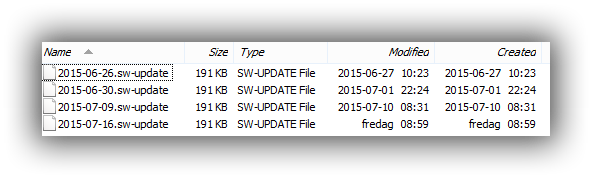

John Posted July 22, 2015 Report Posted July 22, 2015 No, I believe the case analyzer results. I mean how long have you been running the DNA 200? Firmware prior to 7/9 could cause chip damage in rare circumstances that we've seen cause excessive heating, but if yours has never been run with firmware that early that would be cause for greater concern.
Patrick.N Posted July 22, 2015 Author Report Posted July 22, 2015 Can see my exact timestamps in this image between installations, ran first firmware for a few days and upgrading when new builds to avail.
