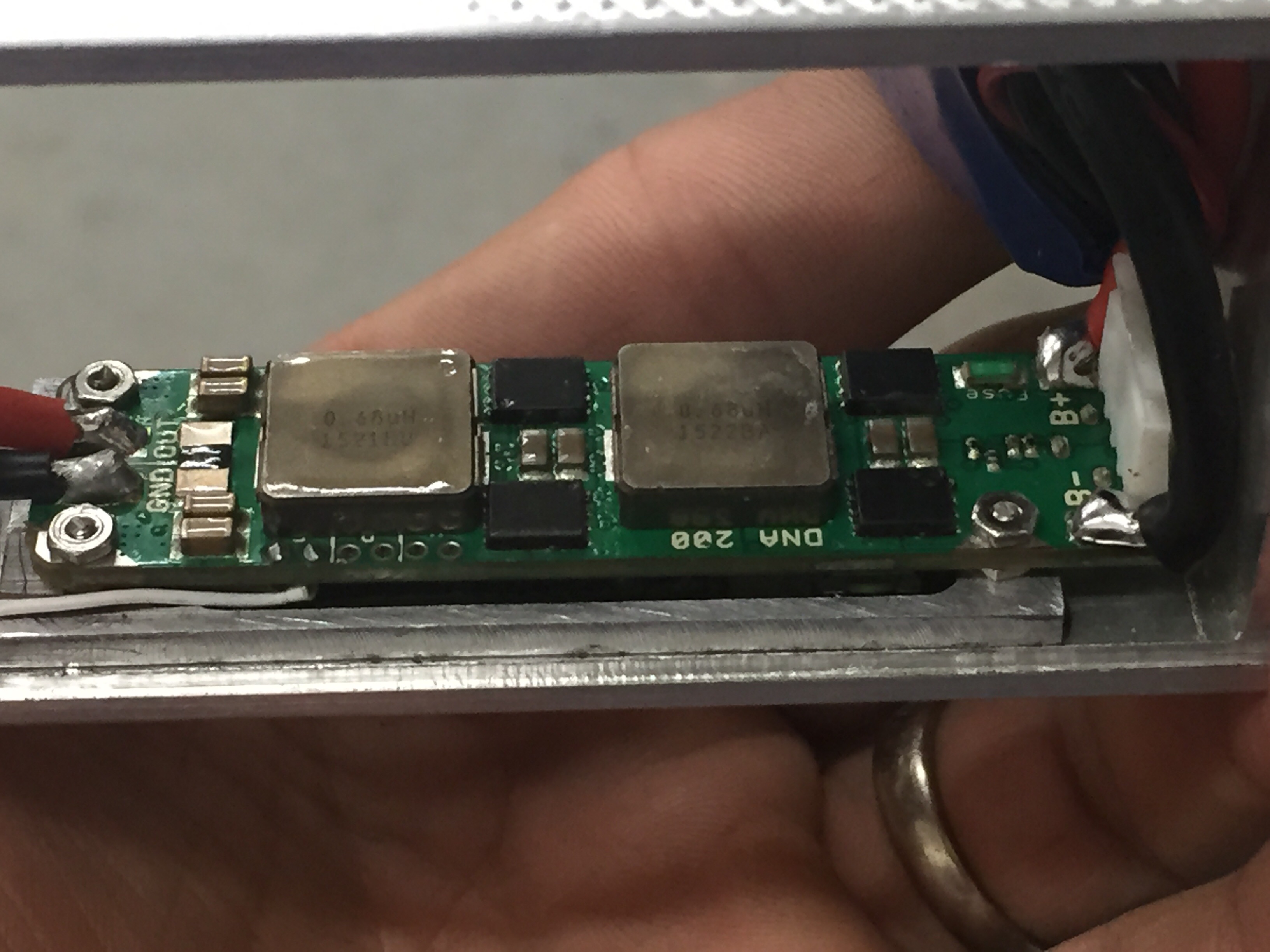

RexBrown Posted August 26, 2015 Author Report Posted August 26, 2015 ok hav one mod that when delivered today after he used it a few min, it quit. Nothing happens when you press buttons but will come on when plugged in to usb. Pressing fire button when plugged in the screen dims and starts saying ohms too high. Says like 2.6watts. It was running a hybrid k1 core ni200 Clapton coil that I have run for at least a day on that mod. Not sure what's going on any ideas?

RexBrown Posted August 27, 2015 Author Report Posted August 27, 2015 The fuse on mine looks ok. And ohms out good. So that is not the issue for me. I wanted to wait and see if I got a response on here but will start in the morning trying to get in touch with evolve and try to see what it is.
scoopy Posted August 27, 2015 Report Posted August 27, 2015 Try checking your ground and 510 connections and battery connections. .....look at all the resistors around the balance port
James Posted August 27, 2015 Report Posted August 27, 2015 What voltages do you see on your battery cells in Device Monitor?
RexBrown Posted August 30, 2015 Author Report Posted August 30, 2015 The cells all show 4.01 v I have replaced the board and that mod has been working flawless for five days now, so I don't think it was case related. Couldn't see anything in the case or on the board that indicated a problem. Same battery still in the mod.
