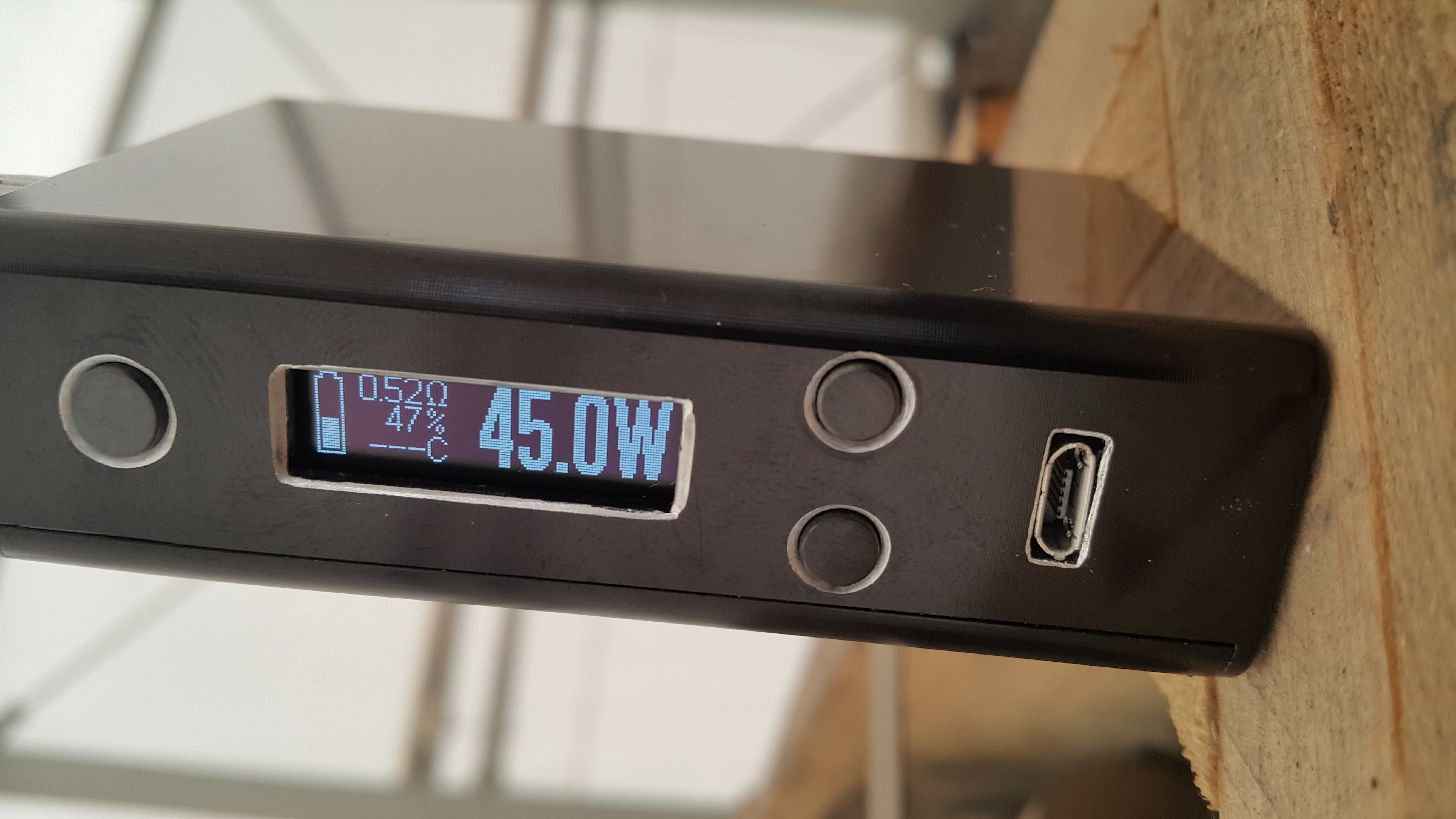

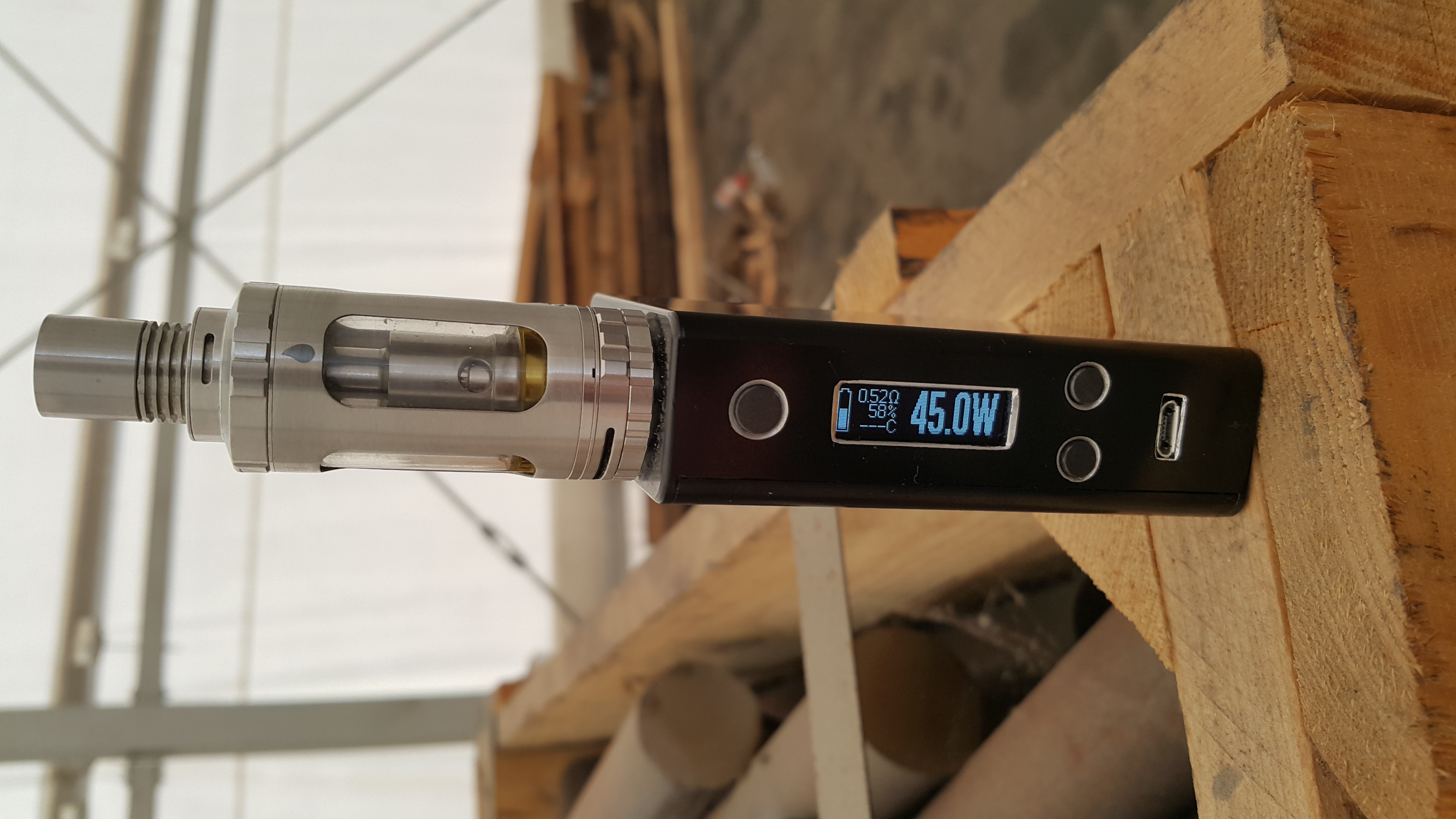

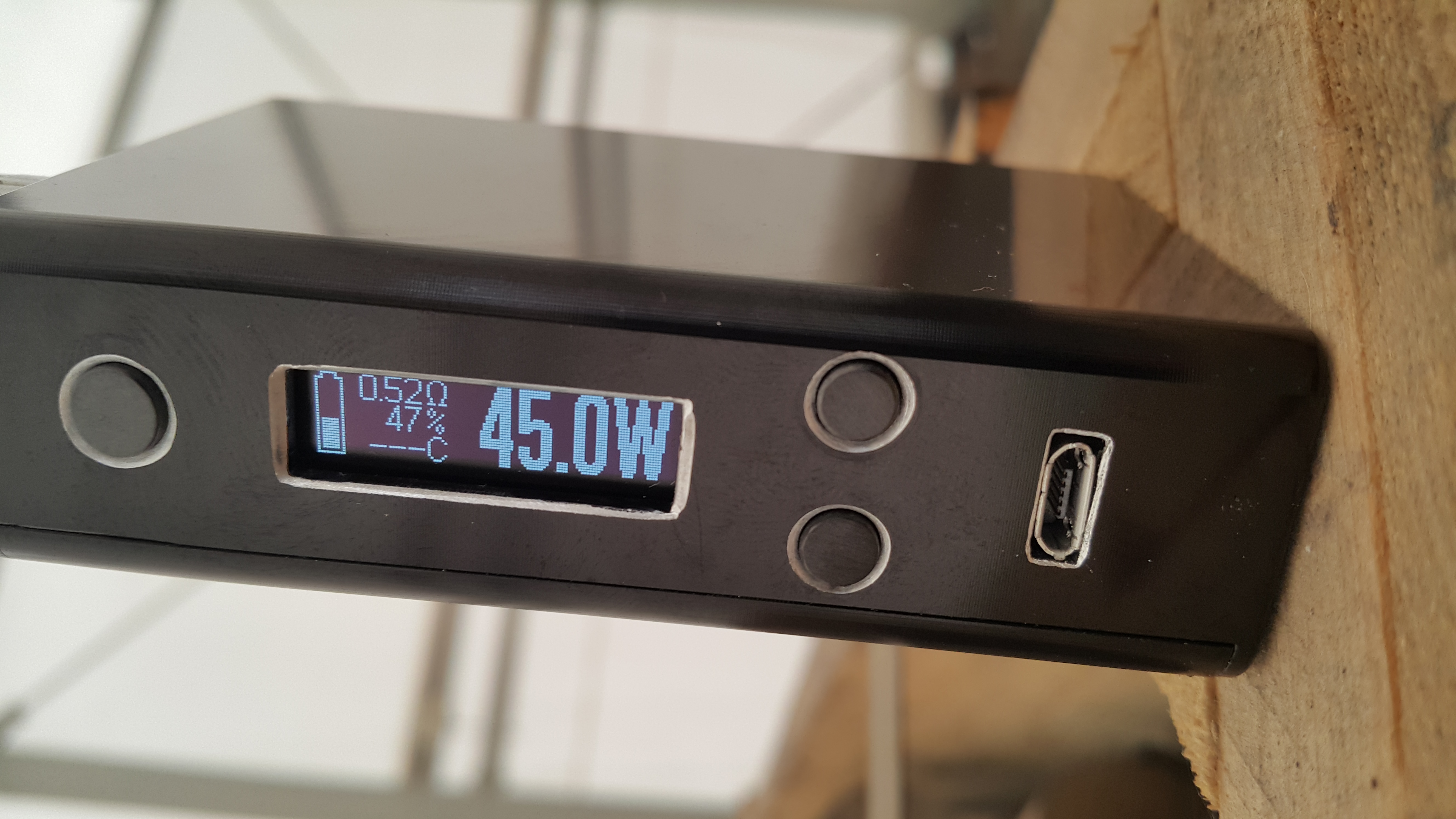

West84 Posted September 14, 2015 Author Report Posted September 14, 2015 Hello to everybody. I have assembled a box with Turnigy Nano Tech 1000mAh battery. I'm using it for 3 days for now and all I have done is firmware update through Escribe and set battery level on main screen. I have noticed that when battery comes to approximately 38% and after 20 mins of not touching mod,battery level shows 59%. This happened for second time and both times at 38% and indicating 59% after a while.Does anybody else have this problem? Is it a battery or firmware bug? Picture taken at 10.23AM Picture taken at 11:40AM
James Posted September 15, 2015 Report Posted September 15, 2015 Do you have the Watt-hours set correctly for the battery? Normally, it will only correct if the voltage reading differs significantly from what it expects based on usage. Alternatively, your battery may have a different low battery falloff from the standard LiPo curve we include with EScribe.
West84 Posted September 16, 2015 Author Report Posted September 16, 2015 Well,I haven't set that also. It was 8 Wh by default. Now I have used escribe calculator and set it to 11.1 Wh. We'll see today what happens. Thank you

West84 Posted September 16, 2015 Author Report Posted September 16, 2015 My problem is resolved with setting Watt-hour. One more to go :-)
