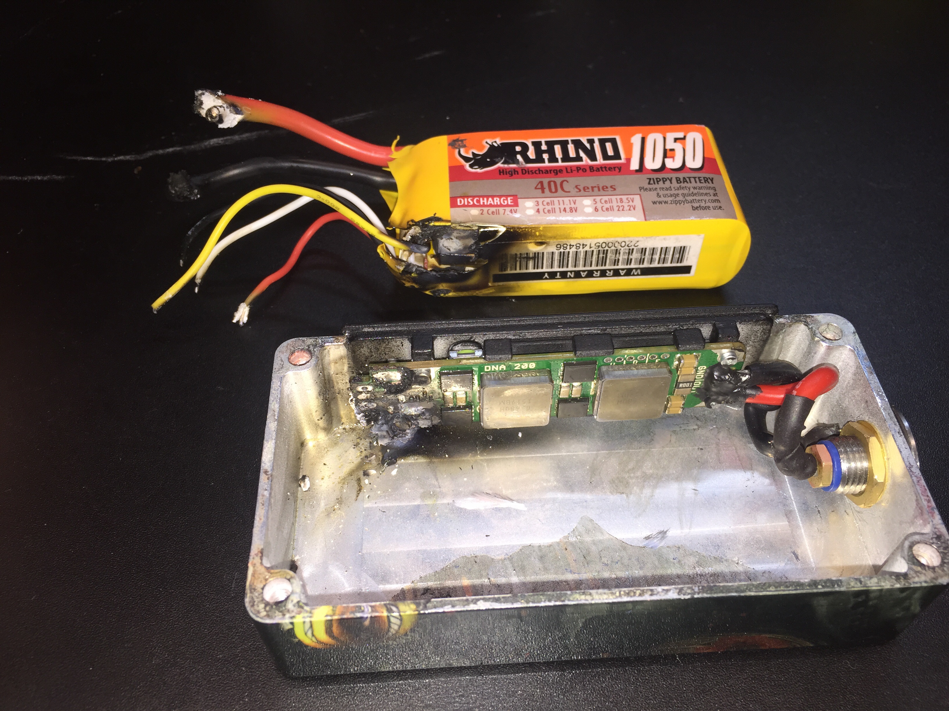

laadam Posted September 17, 2015 Author Report Posted September 17, 2015 Everything was going good... Then I smelt something.....
scoopy Posted September 17, 2015 Report Posted September 17, 2015 Dammit boy lol! Do you know what exactly happened?
laadam Posted September 17, 2015 Author Report Posted September 17, 2015 No, I don't know exactly. I guess a wire could have worked loose. Have to take a closer look in the morning. May or may not have been the battery. Just raging after losing this...
Podunk Steam Posted September 17, 2015 Report Posted September 17, 2015 My guess is there was a sharp point on the solder and the battery wasn't anchored with a velcro strap or two sided tape so the point on the solder worked its way through the battery's shrink wrap. Something between the battery and circuit board and anchoring the battery would have made a difference I'd think. Just a guess.Edit: The Zippy line of batteries are not the highest of quality either but I call them as I see them.
turbocad6 Posted September 17, 2015 Report Posted September 17, 2015 looks like the positive connection on the chip shorted to the case, the positive terminal is on the bottom, right near the case ground and that looks to be the point of origin from here to me

laadam Posted September 17, 2015 Author Report Posted September 17, 2015 The epoxy hadn't even cured yet! The battery wasn't secured because that was going to be the last step. Tested everything after install and checked out. No wires were contacting the case. (I will take a closer look to see if the was a sharp spot on the solder, if I can) Threw it on the charger while I was cleaning the bench up and.... Flame! Yanked the battery and threw it out the garage. Didn't know if it was going to get worse
