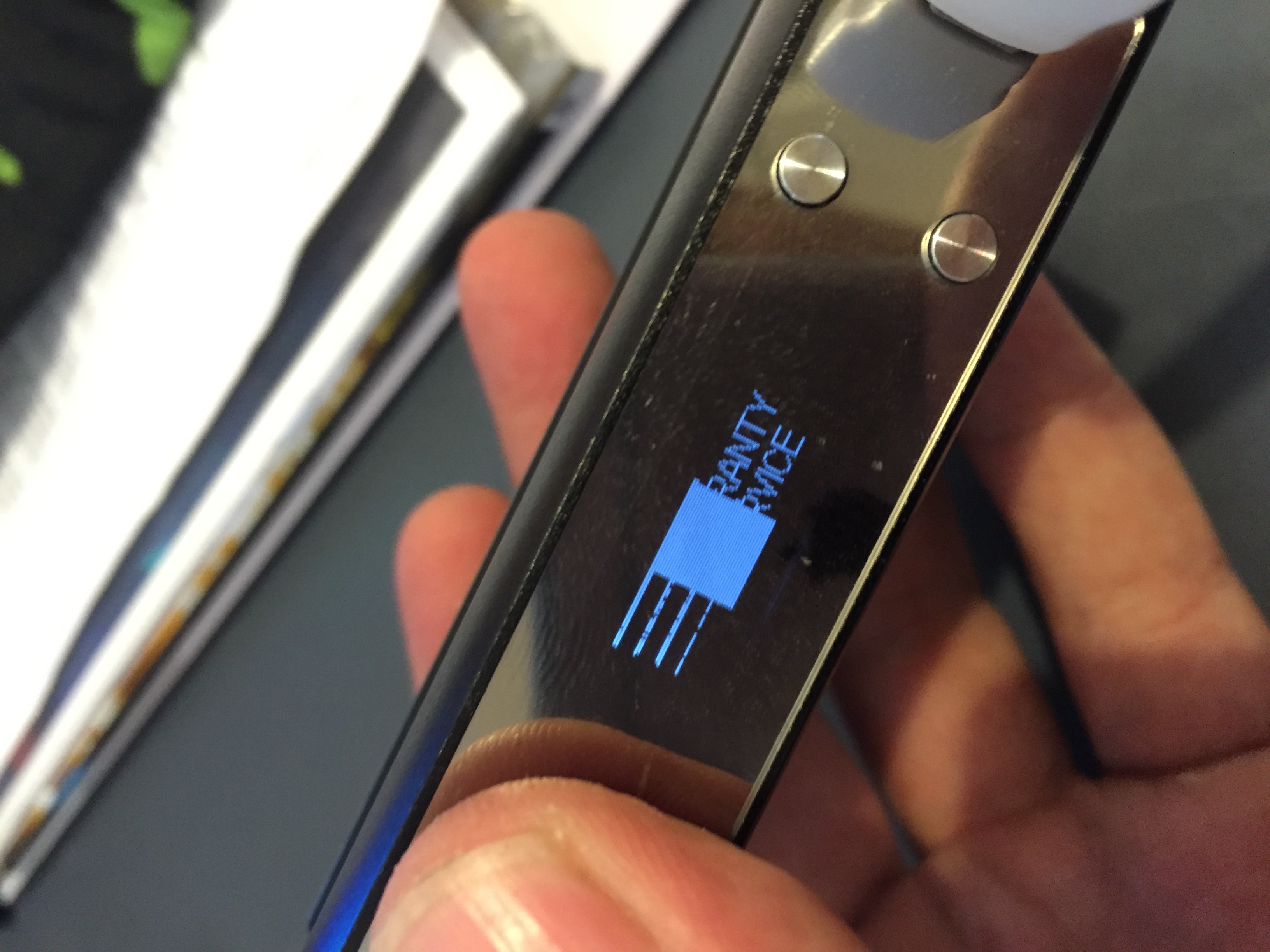

addappt Posted October 2, 2015 Author Report Posted October 2, 2015 My SVIP just died. See pic. So what now?
addappt Posted October 2, 2015 Author Report Posted October 2, 2015 Let it sit for awhile and it started working again. Now though in normal mode it will freak out and fire above set watts and the screen will glitch and then it does a restart.
addappt Posted October 3, 2015 Author Report Posted October 3, 2015 Spoke to soon. Completely dead now.

promod2000avenger Posted October 15, 2015 Report Posted October 15, 2015 The screen ribbon cable is pinched by the fire button.I know this for a "fact".When the cable gets pinched it will "definitely" cause the warranty service messageto be displayed. And show a half glitched screen just like your picture.How do I know this for a fact ?Because it happened to ME.Evolv says it out of calibration and needed to be sent in for service.If it was out of calibration I don't think it could fix it's self by just changing the screenand upgrading the firmware. Not trying to contradict evolv just stating facts.But before I sent it in I replaced the screen and used 8/21 firmware andBINGO works great NO problems any more.That was "months" ago.
