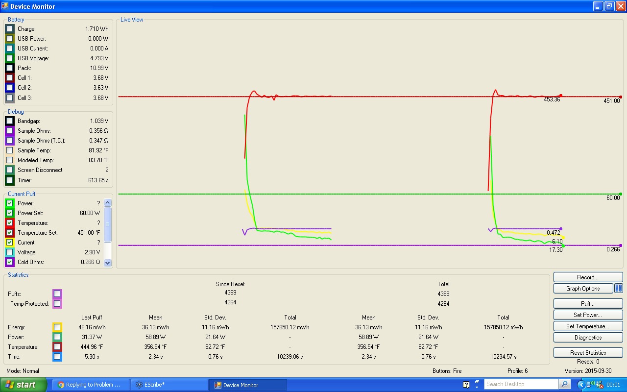

Spector NS5 RD Posted November 9, 2015 Report Posted November 9, 2015 @lewiss how do i get that de bug box in device monitor. im lookin and dont see an option for that box with 'band gap' 'timer' etc? thanksedit.. found out how to do it 7 clicks on the logo in about escribe. now how do i exit it? lol just close escribe?
scoopy Posted November 9, 2015 Report Posted November 9, 2015 @ChunkyButt200 go to help then about and left click on evolvs logo seven times then open device monitor and it will be there
